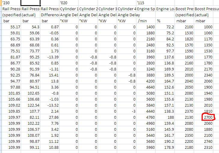

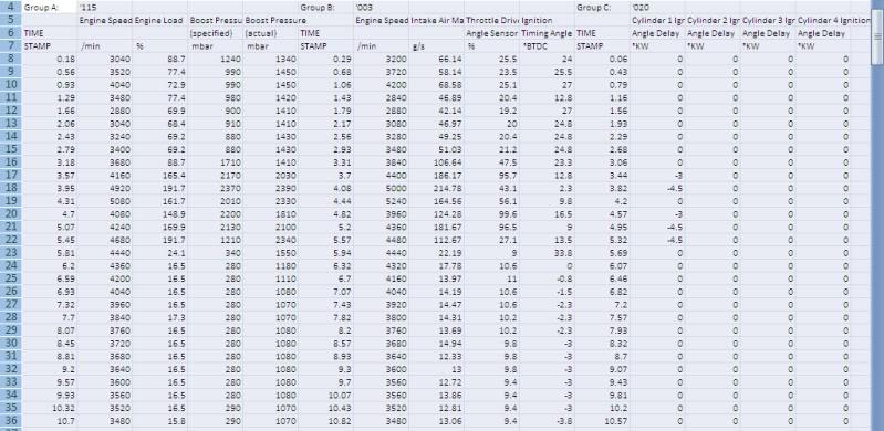

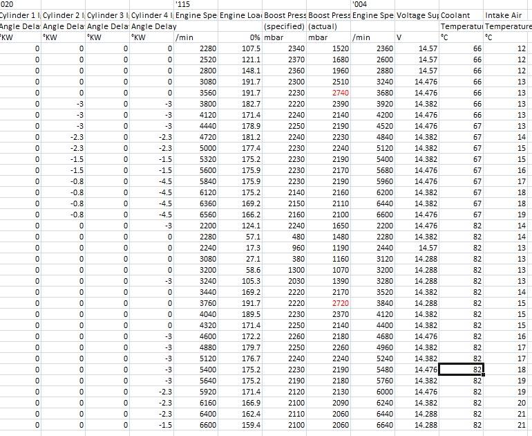

ok then. Basically, logging the same block in vagcom with the shark map on(block 3) shows ATDC, logging block 3 when I had the bluefin on the car, gives BTDC as shown below. I'll run the PDT map tomorrow and see what shows :party:

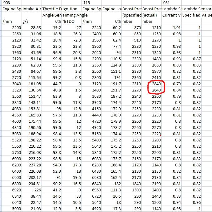

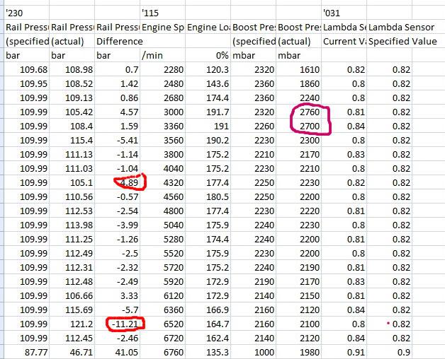

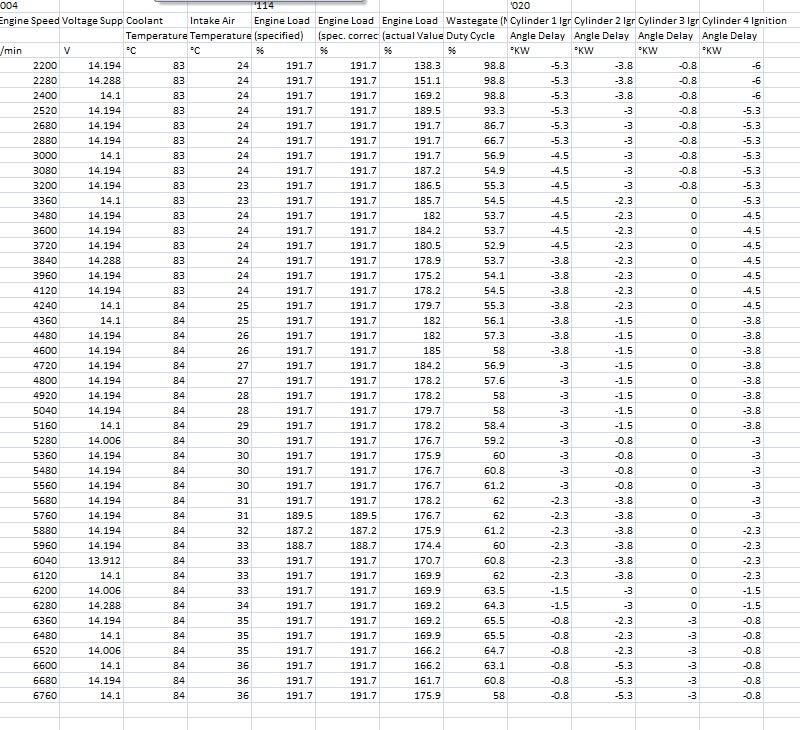

Well, I swapped to the PDT map, and did some logging.
I did 2 runs in this block, as theres the boost spike that I was getting on the shark map aswell. Also, the runs had to be done in 3rd gear as the private road was unavailable :driver:

« Reply #108 on: August 28, 2011, 05:00:57 pm »
Had another look, and it overboosted in february aswell, damn thought I was onto something there aswell :fighting:

You got an uprated hpfp?  The boost control doesn't seem that great if you are getting such a high spike with such a fast drop off and lack of hold at the top.

« Reply #110 on: August 28, 2011, 06:38:28 pm »
Yep, running an APR fuel pump. I just put a new OEM pump in this afternoon with a new thrust sensor to see if it makes any difference,
Timing pull looks good on the second run when the engine has been warmed up :surprised:

« Reply #111 on: August 28, 2011, 08:23:46 pm »
Map doesn't ask for much fuel pressure.  Is that pdt's style of mapping?  Do you have an rs4 fuel pressure relief valve?
I wouldn't want to run 1.9 bar of peak boost.  Turbo won't be your friend for long.  Have you done a log of the maf?

« Reply #115 on: August 28, 2011, 08:47:15 pm »
Maf figures are fairly low.  You don't hold much boost at the top end so that won't help.  If you had less spike it would tend to hold more at the top.  Do you have any logs when it was running Revo 2+.
You should really see 270 gs or higher.  On comparison, a xbow I did with a 3076 was seeing 380gs!

« Reply #117 on: August 28, 2011, 09:09:51 pm »

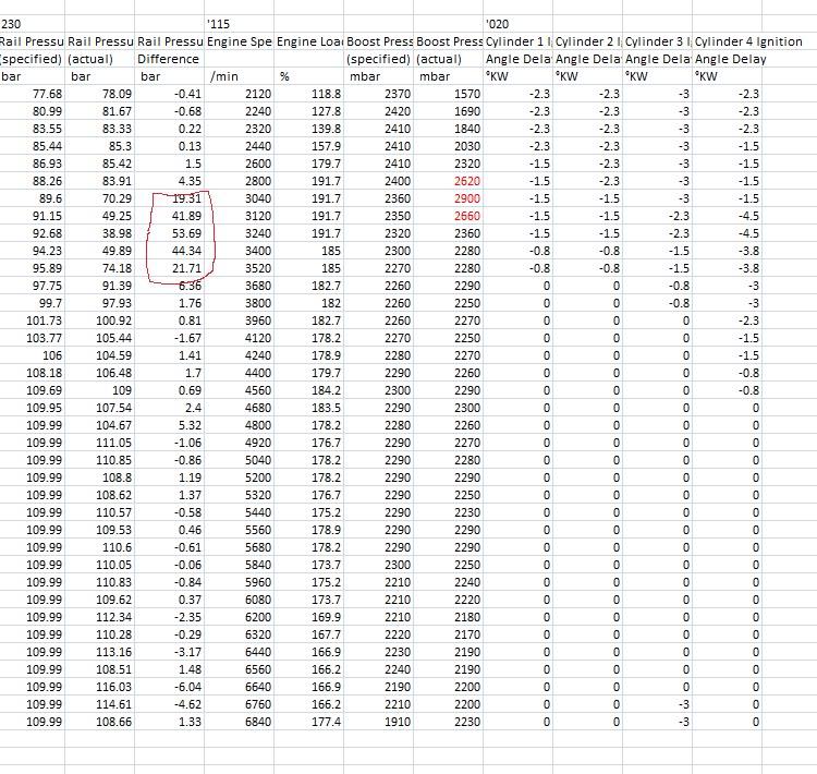

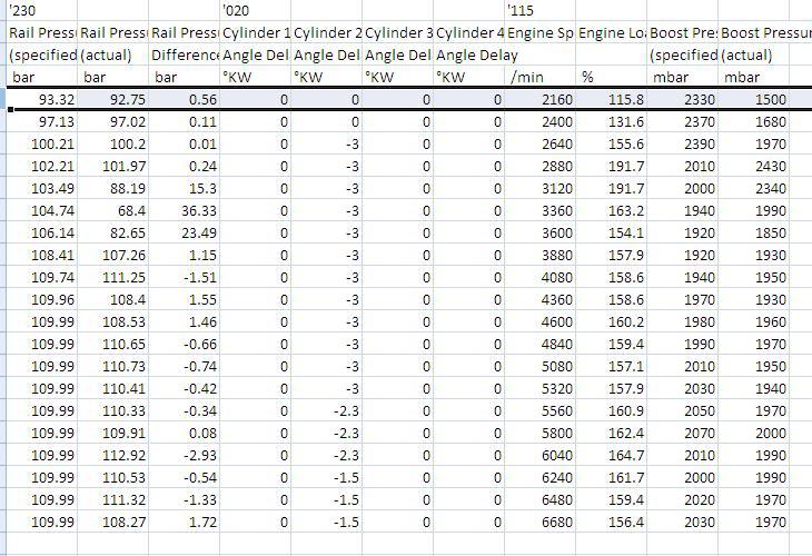

247g/s would equate to 305hp.  But that doesnt take into account any extra power from the timing advance, where one of the main issue seems to be, so with the timing retarded as much as you say, it would explain the low power.
Originally your DSG was limiting all timing advance so that no matter what timing the car was asked to advance, it was always limited, hence no timing pull.  They got around that somehow, car running well.  Then the DSG remap, and all of a sudden the car starts to retard timing back in an extreme way, resulting in the new maps with much reduced timing.
We've seen in the logs you have a boost spike, and your previous logs show some high timing pull on what was previously a map without timing pull.  Its also evident the ECU is closing the throttle a little when on full throttle at high RPM and full load.  Your also throwing out black smoke, so something has to be amiss.
Does VCDS allow you to monitor knock protection or even better previous knock protction.  Also Misfire counts etc.
@ Alex  what sort of issues would normally cause the car to retard timing, apart from high IATs.  Black smoke is normally unburnt fuel, so related maybe?  When a car retards timing, does it do that by closing the throttle body a little or is that something else causing that etc.
Dom are you at the open day tomorrow?
