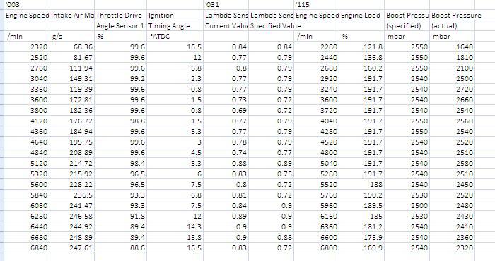

Block 003 for ignition timing.   :smiley:

« Reply #97 on: August 27, 2011, 08:56:49 pm »
Heres a timing log then :happy2:

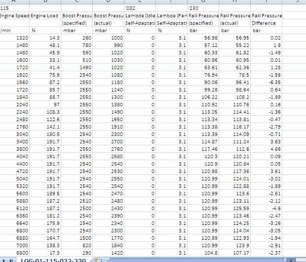

I don't know how accurate the MAF to BHP conversion factor of 0.8 is, but if it's applied to your peak reading of say 249, then you're only at 311bhp!

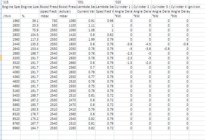

It is getting very lean at high rpm and the ECU is pulling back, look at the throttle angle.

« Reply #100 on: August 27, 2011, 10:10:15 pm »
Logs all match up with the power figures you saw today, ECU is pulling back as martziniuk said. Something odd is going on with the timing, should see a steady figure of 20+ degrees under load but all of the logs I have show Timing BTDC but yours shows ATDC (before top dead centre and after top dead centre) so not sure if these numbers are correct or not.
As a test can you flash the stg2 that you have and log all of the blocks as you have done above and the intake air temp block. I know that stg2 map inside out and know exactly what the log should show.

« Reply #101 on: August 27, 2011, 10:42:33 pm »
Thanks Dave, will flash that file tomorrow and go for a brisk run after work :laugh:
I checked some old logs and they showed BTDC aswell?

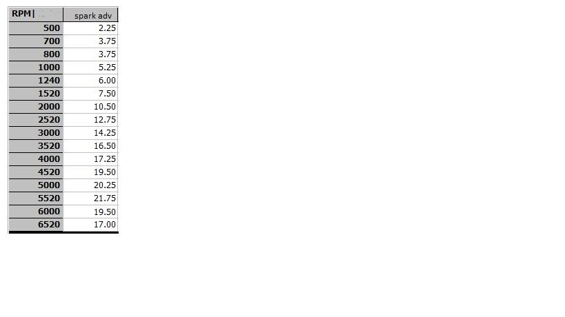

ATDC means that its logging the retardation of the spark (i think, not really used ATDC in vagcom as its a bit pointless)
heres a copy of what sort of figures you should see in the ign log:
