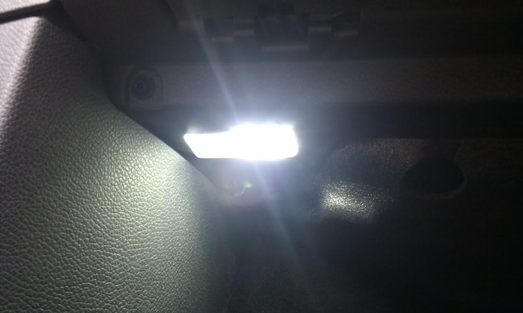

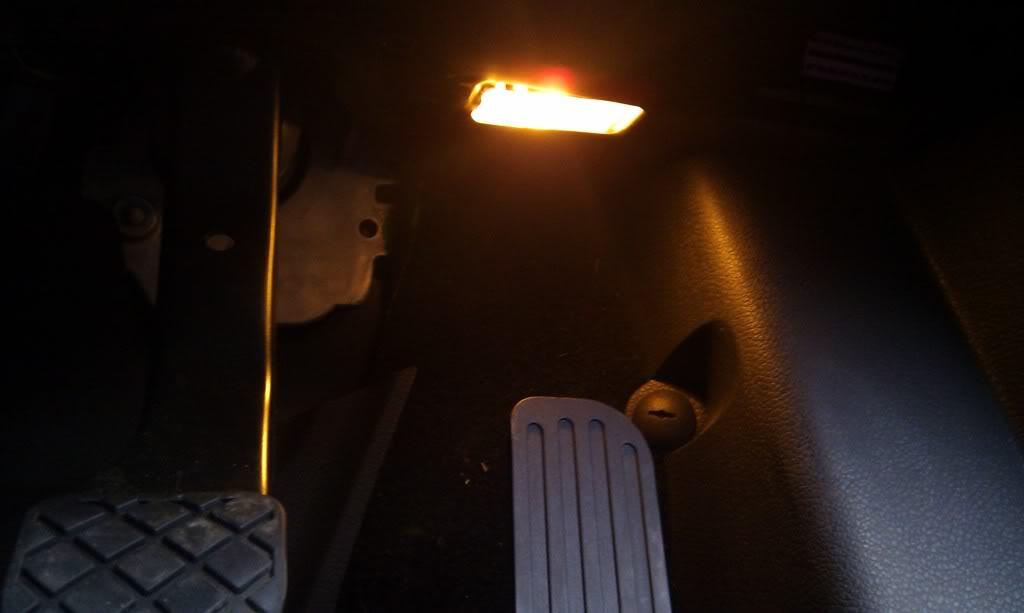

Cheers pal.  I had a spare LED so I tried it in the foot well, no comparison really.........
Standard yellow carp -
LED 5000k -
Just ordered 3 more pairs for the rest of the interior lights.  :happy2:

looks so much better, just waiting on all my LED's got kinda mix match in my car at moment lol.
Was it hard to prise the metal away without damaging it? I only had a quick look and was baffled on how to do it without damaging it before i read on here you need to bend the metal.
