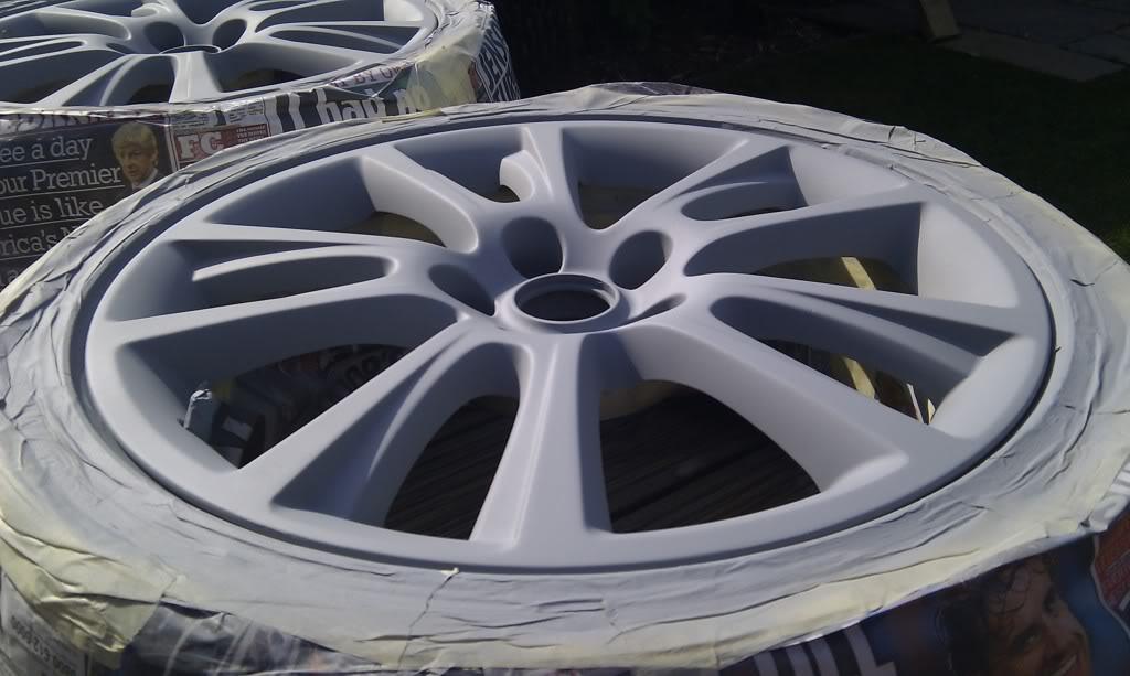

I've been planning on getting my 18" Zeniths refurbished however after fitting a new set of wheels to the marauder, I have decided to have a go at the job myself.  Tbh 3 of the wheels weren't that bad, light kerbing and lacquer flaking, however 1 was quite badly damaged, not to be put off I attacked them with a random orbit sander, and a file!   :scared:

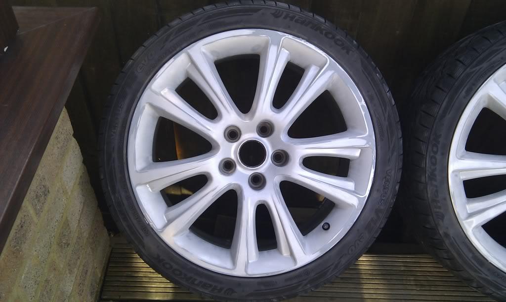

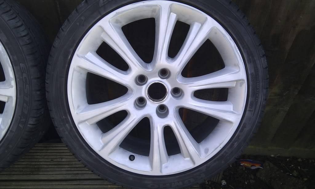

After cleaning them up with some household cleaners and a nasty concoction of chemicals from the garage, repairing the damage with body filler and sanding I was left with the following -

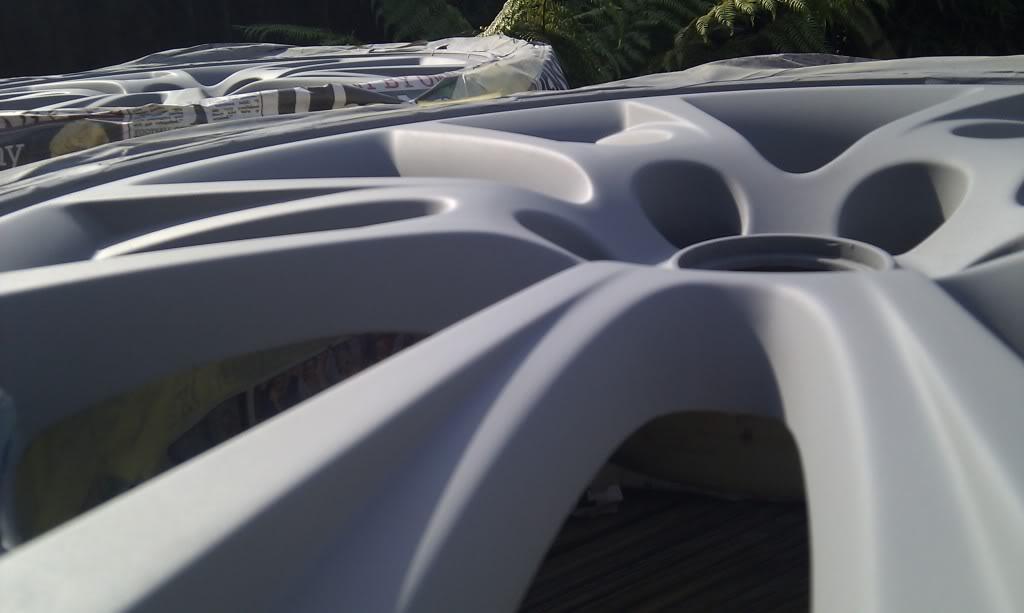

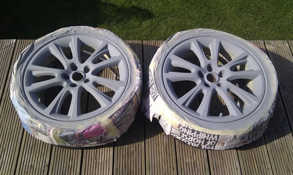

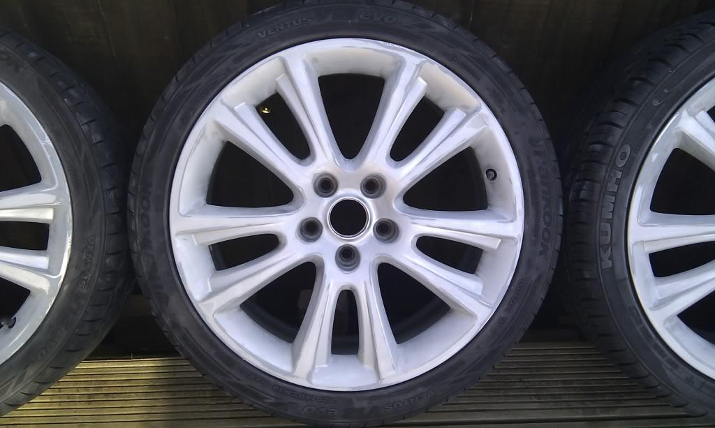

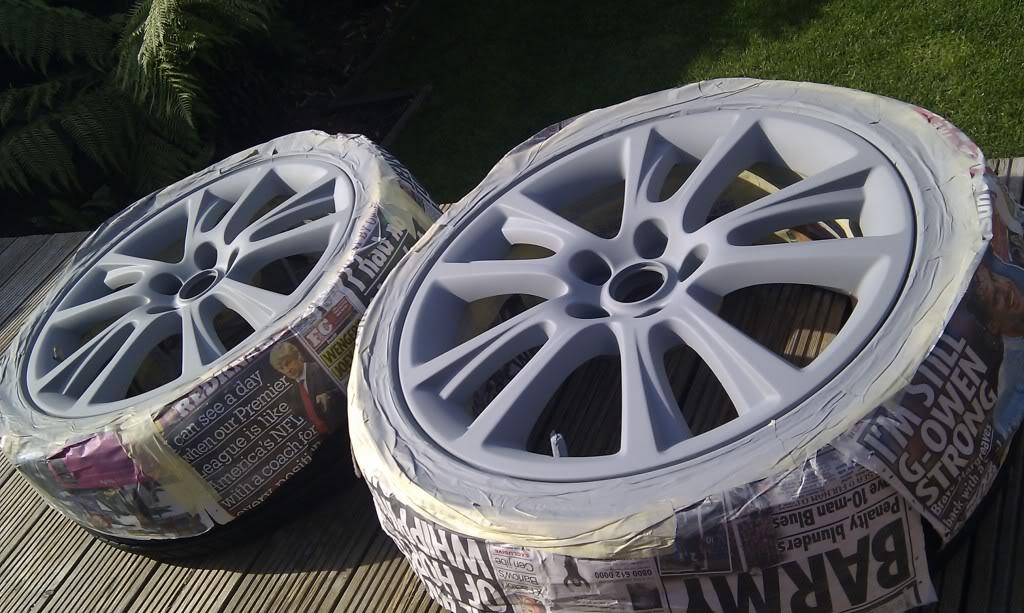

Unfortunately 2 of the tyres have quite substantial rim guards so I will need to crack the bead to be able to paint them correctly, the other 2 aren't as bad, so I masked them up and gave them 2 coats of primer.  Once dry I gave them both a light rub down with 1200 grit wet and dry.  This left the following:
So far so good, now to decide on colour, OE silver or slightly darker?  I was going to go anthracite, but to go that dark I would need to refurb the entire wheel, not just the face.

So far it has cost 10 quid, that's for a roll of 2" masking tape and a 500ml tin of grey primer which I got from Partco as the nozzle gives a far superior spray pattern than Halfrauds carp!  I will probably need a 2 second tin to complete the job and to prime the GTi side skirts I am getting for swmbo's Golf GT.  I will get the paint mixed at a specialists and an aerosol filled, for this and a couple of cans of lacquer I would estimate a further £35-£40.  So total cost of refurb (not including my time) 50ish quid.  :happy2:

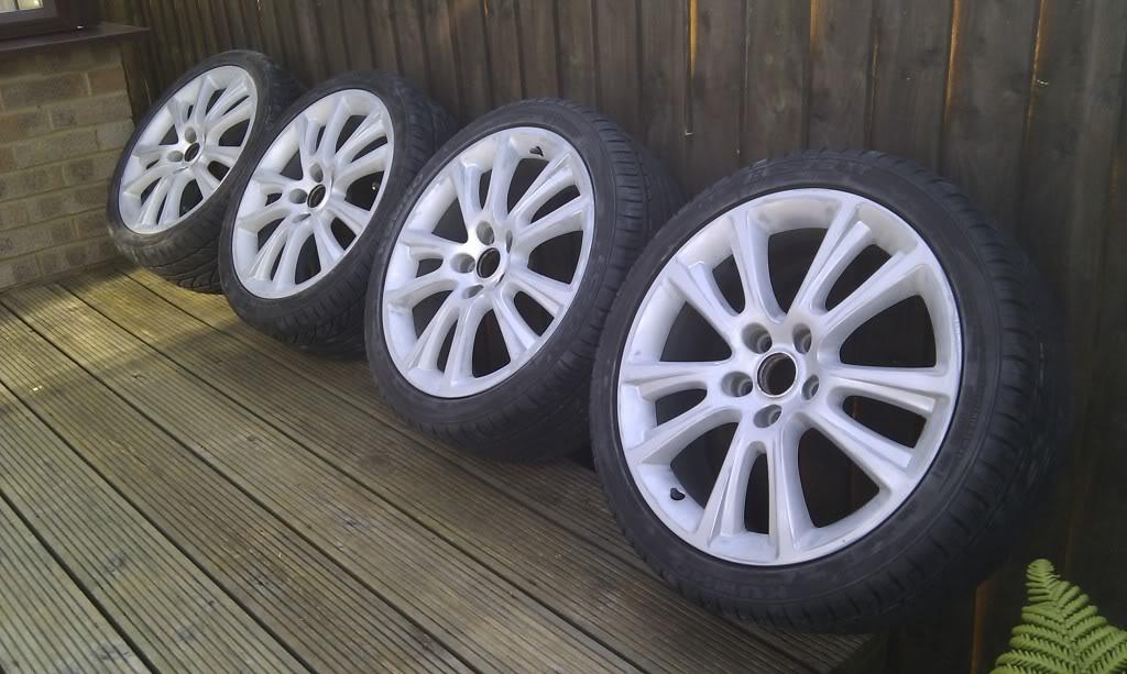

Small update, I have now cracked the beads on both offending tyres.  All 4 wheels are now fully repaired and primed.  On to the decision, as the wheels will be going back on the car as part of a 'return to standard' exercise when it comes to selling (long way off), I have decided against a full blown colour change to anthracite, but I would like to go slightly darker than the OE silver, can anyone give recommendations on suitable colours to try, preferably with a code to get the paint mixed?

Total 'my time' not including cracking the beads on 2 of the tyres, I would estimate........3-4 hours max.

What filler did you use and when using the sander what time of abrasive did you use?  I know nothing about orbital sanders but I'm going to attempt to do a two tone refurb on mine soon.

on alloys its best to use a metal based filler, not normal body filler
on sander you want to use around 180-400 grit discs/pads, can be bought cheap from motor factors/bodyshop suppliers, or even screwfix

Stupid question but is this normal sand paper or one for metal?

most sand paper can be used on everything, but don't buy cheap crap because its useless

Tbh I just used normal body filler, but the amount required was minimal, I used 240 grit normal (wood) sand paper attached to my sander, some bits needed hand sanded, for this I used 150 grit, to flatten back the primer I used 1200 grit wet and dry and when I flatten the lacquer prior to polishing I will go with 2000 - 3000 grit wet and dry.
