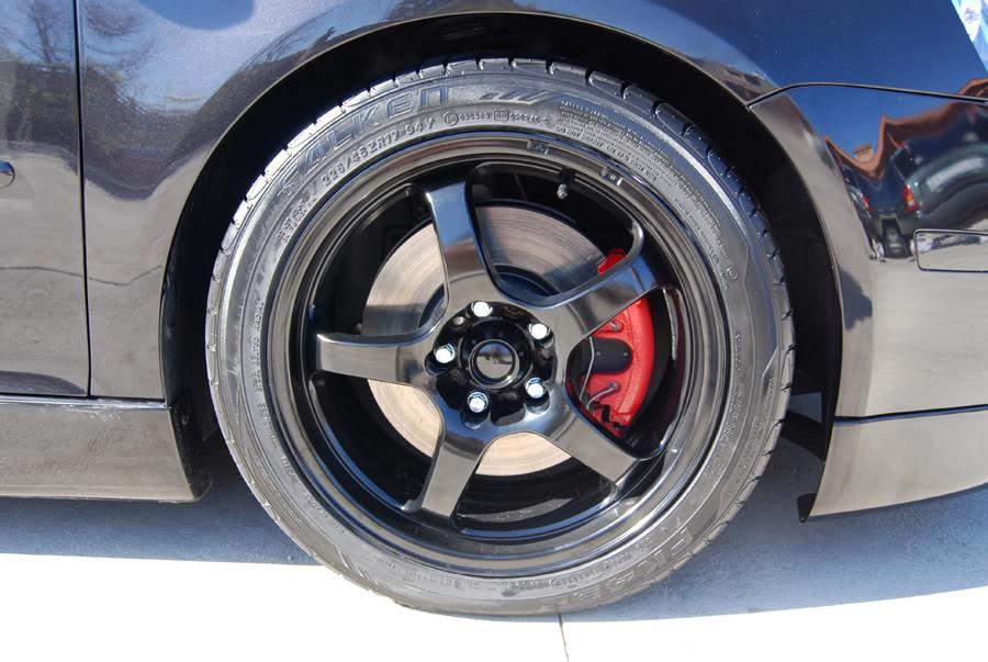

Here's some wheels with the same specs. Fronts only as the rears are 17x9. Think the tyres are 215/40/17 altho I think you really should have 225/45/17 to get the correct rolling radius for a golf.
Another set, this time 17x7 ET 45. Tyres are 225/45/17
