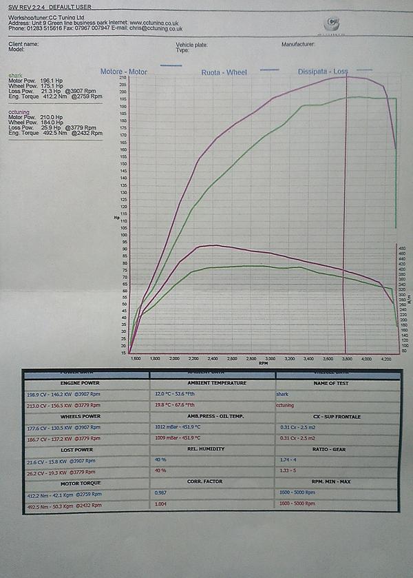

Saturday I popped down to CC Tuning in Burton for a re-remap  :signLOL: and to get rid of the Shark software. I had had it on the rollers a couple of months previous to this and it only made 200bhp average over the 3 runs. Chris said it felt very unresponsive and should hardly smoke at all at that power.
I had planned on having it done in the new year but seeing as he was doing a December offer I bit the bullet and went for it sooner. I had popped down earlier in the week at which time he read the Shark file. That night we were chatting and had found quite a few issues with it.
Wrong over-boost maps, maps altered for DPF when I have no DPF,  boost limit set to 1.7 but boost wants 1.85, smoke limiter pushed to a value where it no longer becomes a limit. This was the same for the EGT limit.
So Saturday we started again and also had a play with the cam timing but only found that made a difference of 3-4bhp. The biggest difference was to the smoothness of the graph.
I think Chris was a little stumped with mine as he had had a couple of 170's in that week that had made quite a lot more power. There are a few mechanical checks I would like to do. Reset the timing making sure I can get everything locked up correctly and the torsion value is as close to 0 as I can get it. Also check the set-up of the injectors as this could be causing issues if this hadn't been done properly during the recall.
I am also seeing, what I think to be abnormally low EGT temps so may have a sensor on its way out. Going to do the mechanical settings first and see if these change.
I went in with 196bhp/303lbft, loads of smoke and poor throttle response and came away with 210bhp/363lbft, alot less smoke and a car that goes like stink. He has also said I can go back once I've done my checks and can have to map updated FOC which is good.
As you can see from that graph it is much smoother.

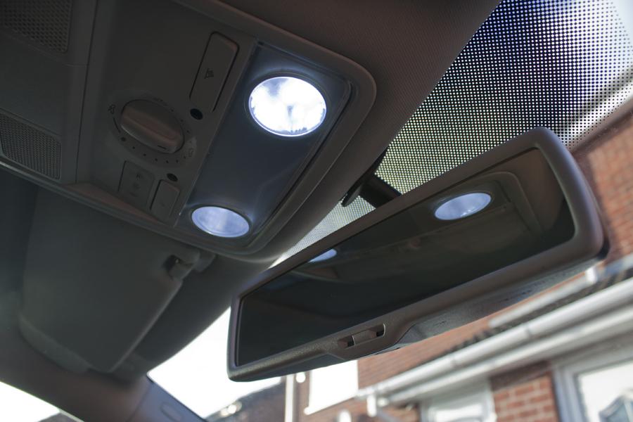

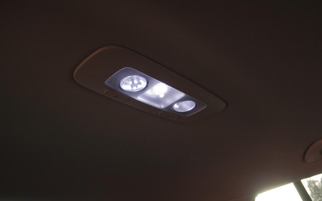

So a few more photos of what I have been up to lately. Firstly I got hold of the full interior LED kit that is advertised on here.
Front and rear interior LED's installed:

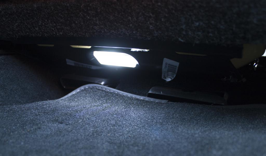

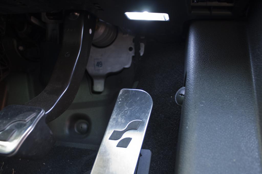

Front and rear footwell LED's installed:
The kit also come with LED's for the glovebox, vanity mirrors, boot and number plate lights. Light output is good and all are error free  :happy2:

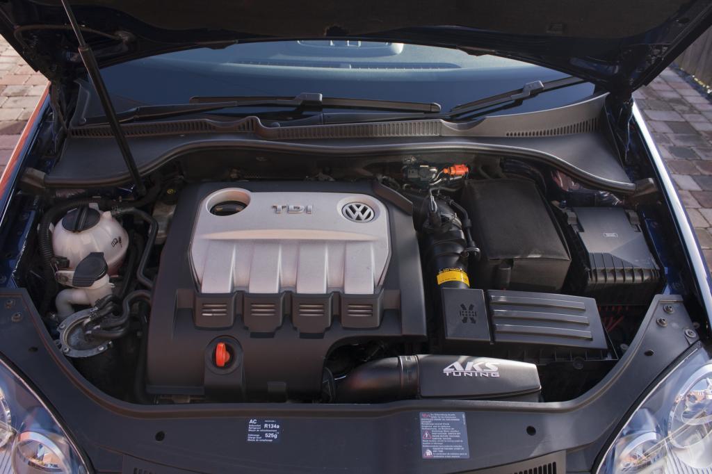

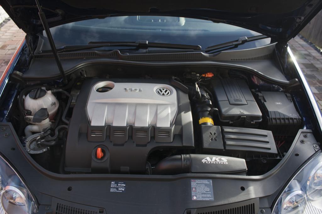

Next on the list was a little mod I had seen Torque777 do to his which was change the battery bag to the proper battery box. It just neatens the engine bay up.
Before:
After:

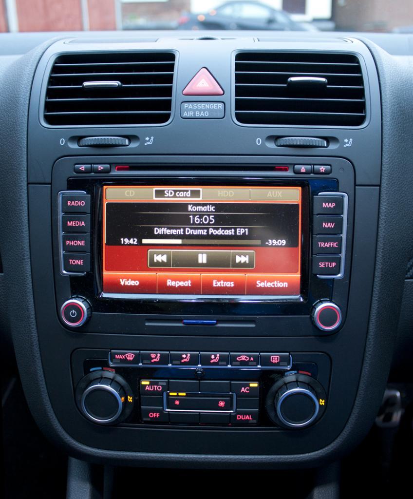

And most recently I have added the MK6 climate panel.

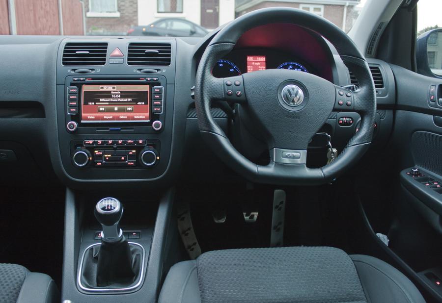

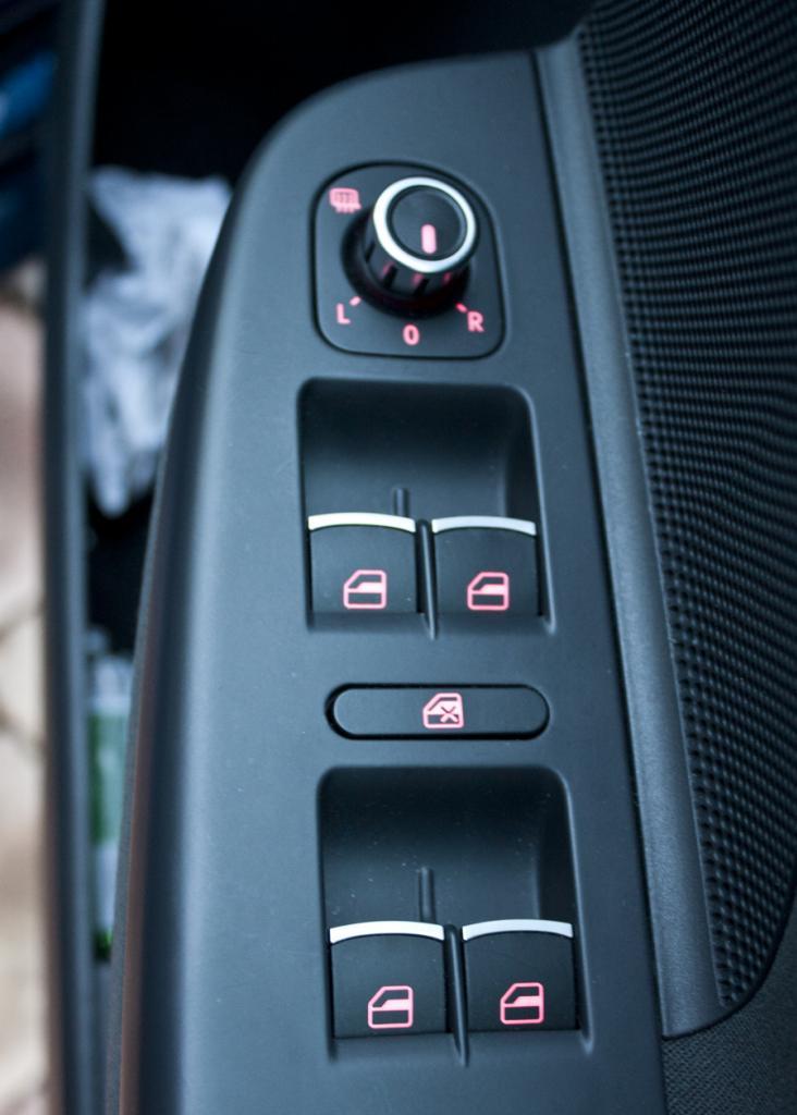

And one last photo which I haven't posted before is I finally got hold of some drivers side chrome window switches.
Thanks for looking  :smiley:
