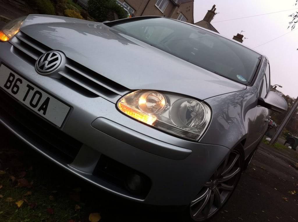

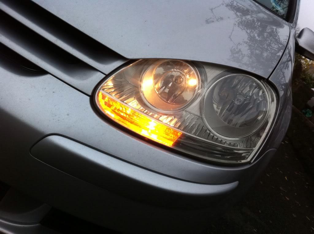

Poor quality pics uploaded from iphone, but they arent too bad!

Offline Zaf2616
  • Posts: 83
Re: Indicators on standard headlights as DRL's?
« Reply #43 on: November 11, 2011, 01:20:19 pm »
I like it, do they stay on when you have the dipped beams on?
Offline AjayB
  • Posts: 266
  • Golf GT TDI
« Reply #44 on: November 11, 2011, 01:34:17 pm »
Yeah, dipped and sidelights mate!
