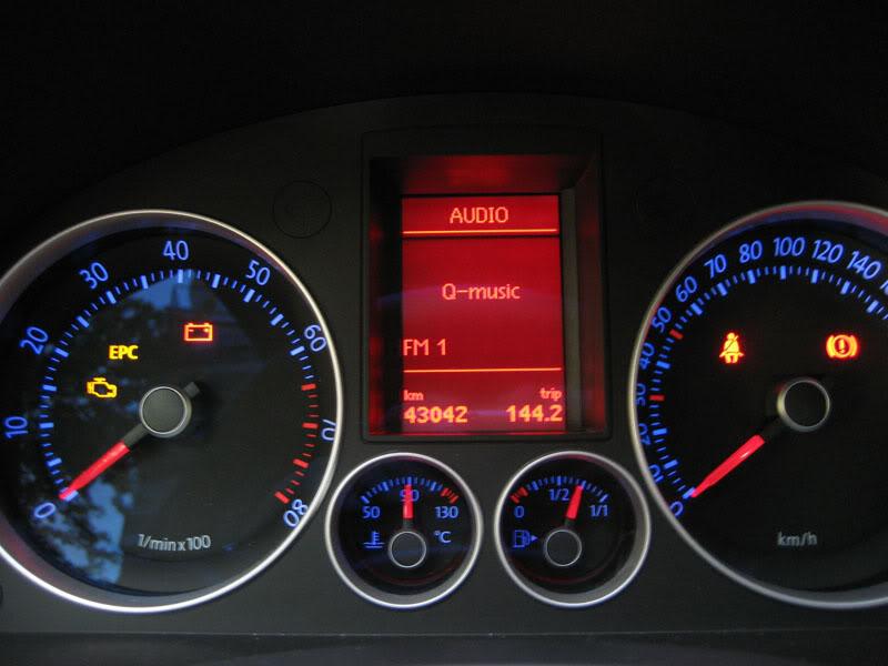

The only thing that Highline gives you if you have either the MFD or RNS units is another menu in the dash insert which would display for example, the radio Station (if you are in radio mode) or the track no (if in CD mode). It would also allow the MFSW (if you have it) to control track skip using the right up and down buttons on the MFSW.

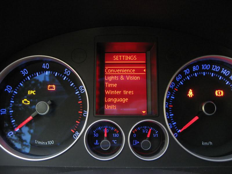

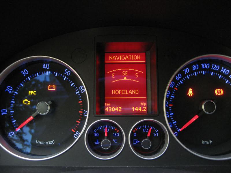

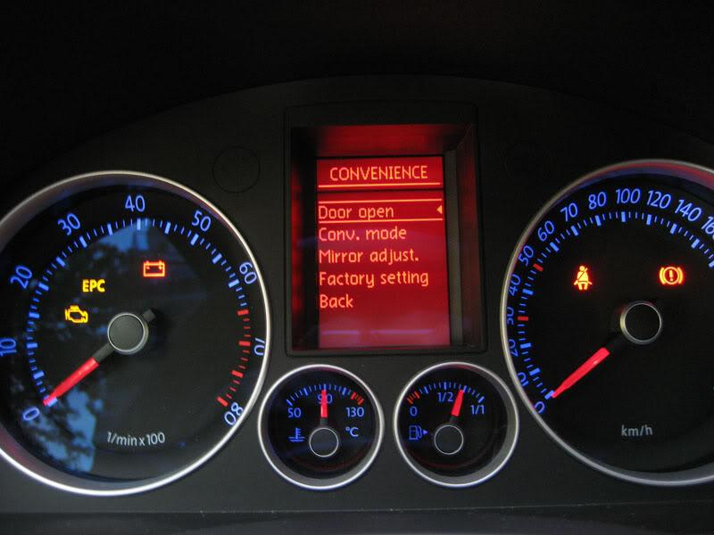

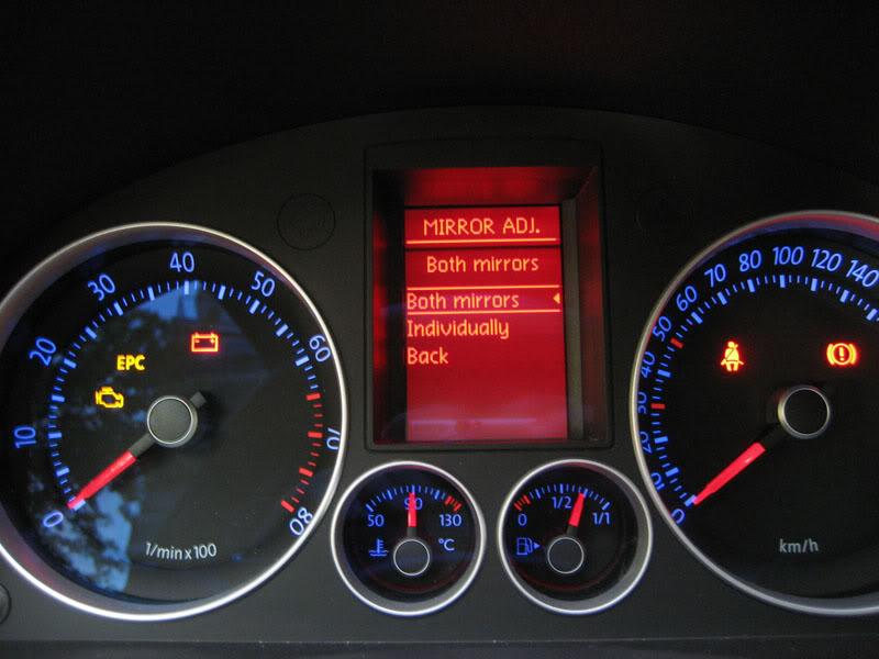

Also gives you NAV directions and a compass, it gives an expansive convenience menu that can be set (like how bright do you want the floor lighting, or mirror adjustment, door unlocking schemes etc..) and better explainations of warnings (such as bulb failures)

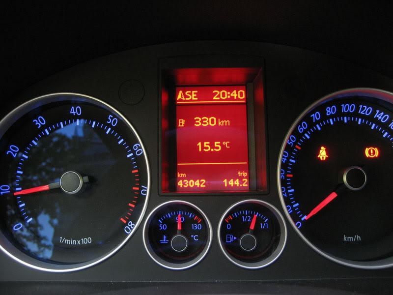

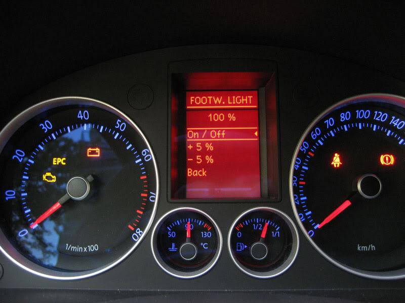

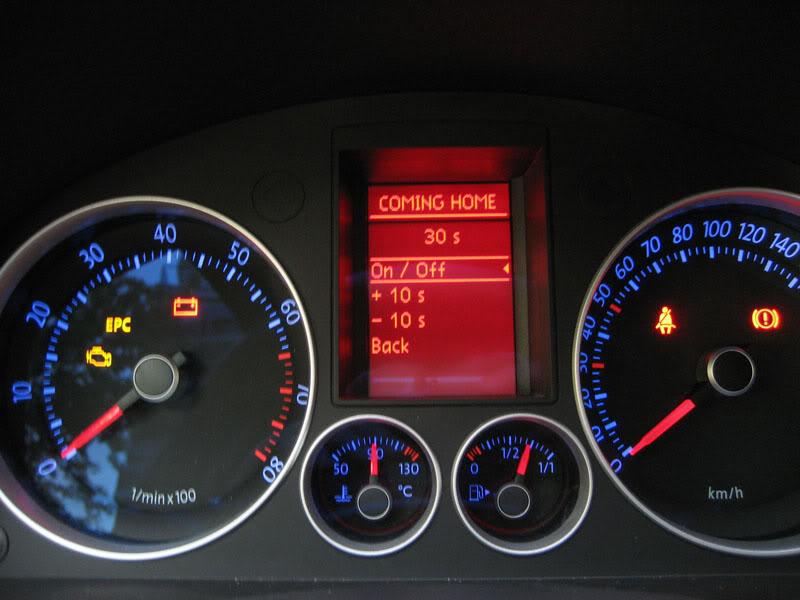

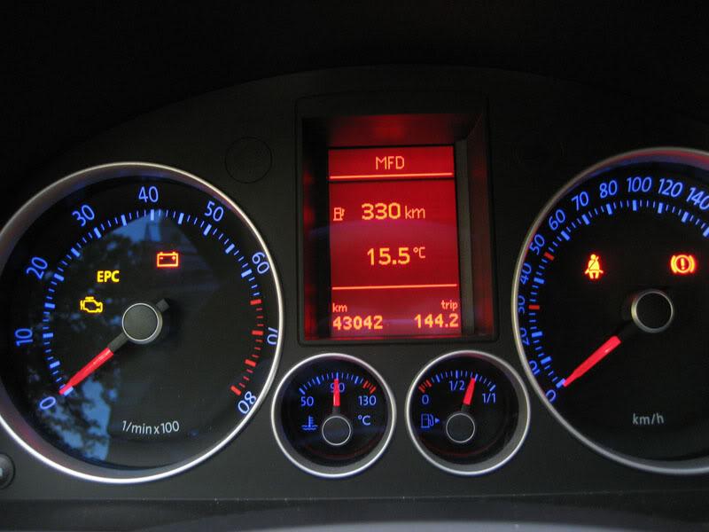

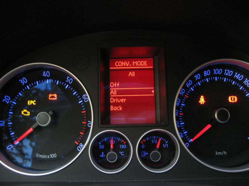

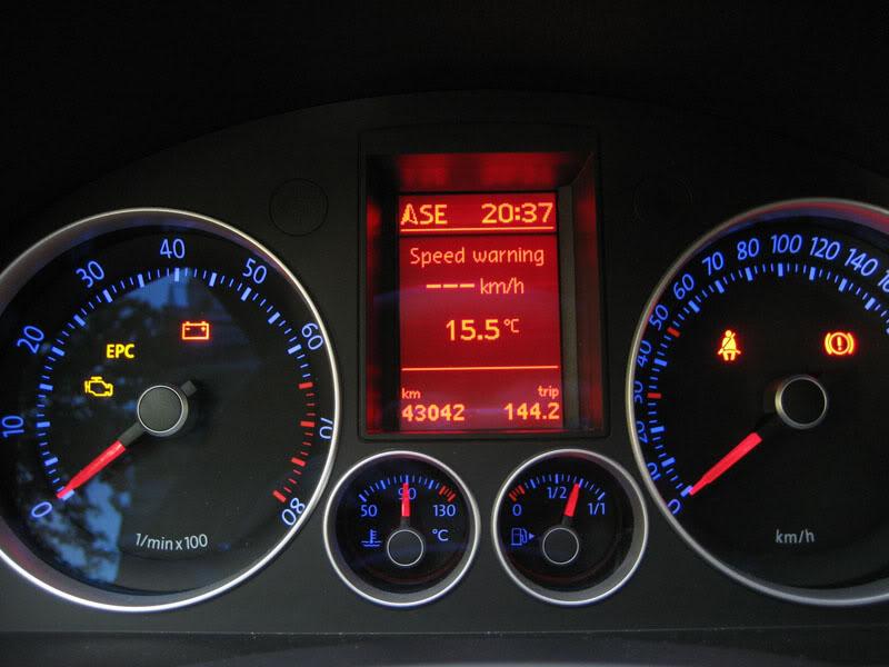

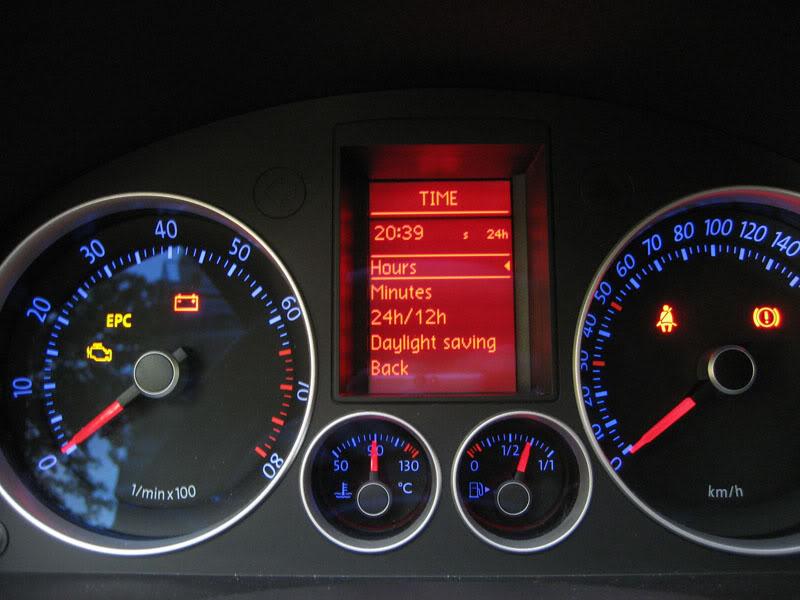

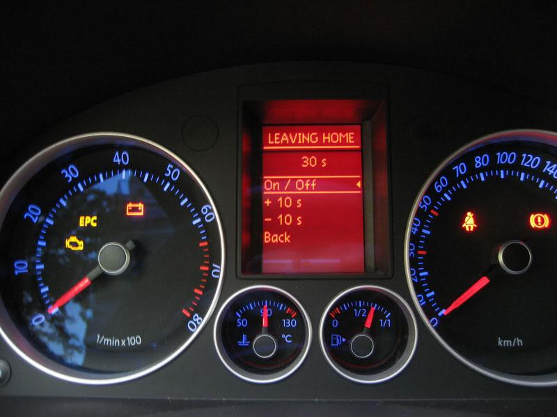

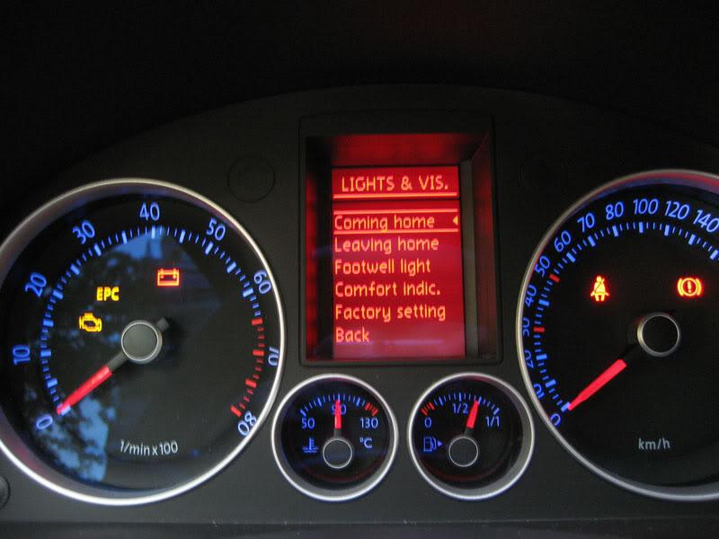

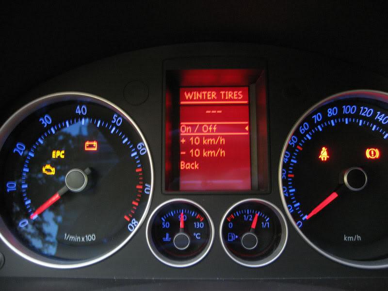

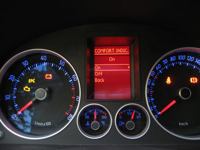

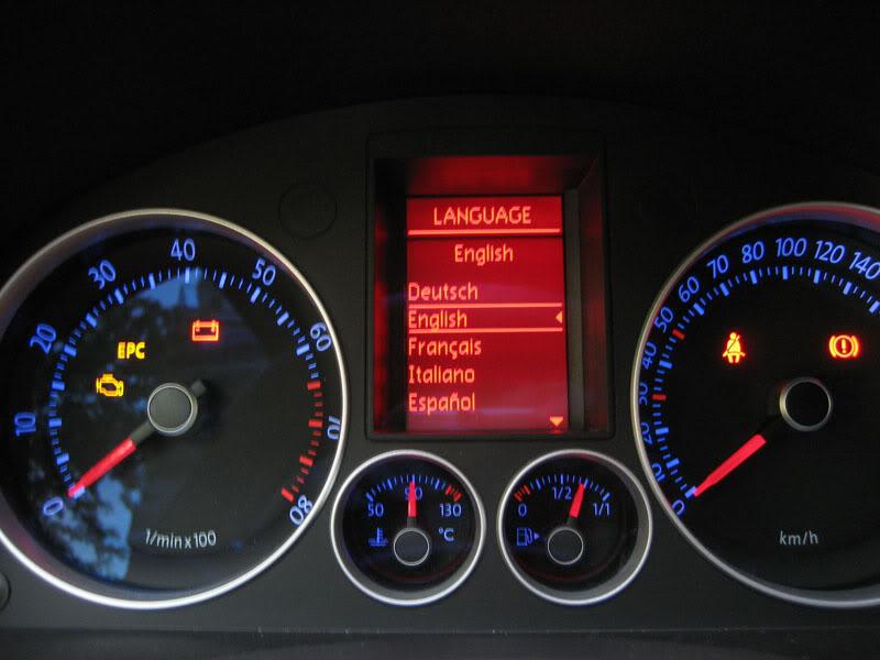

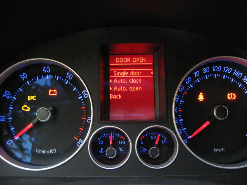

You do get the convenience menu but not all of the functions will show unless you have the full highline CCM module i.e on my retro fit i can only change the lighting, 3 flash indicators and winter wheels and clock time...other stuff like the alarm and locks are not on there I think that menu is some thing like ATA???
MARK_GTIV would you be able to take a photo of the highline menu's you have and if you have VCDS could you get the part number of your CCM cos im quite sure it will be different to the CCM that I have although possibly both highline modules there differ slightly in there functions.

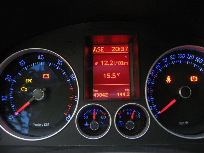

Darren

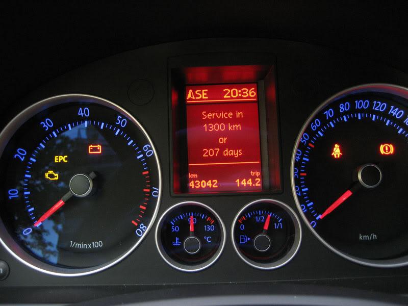

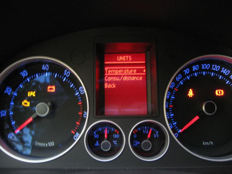

Certainly.. here they are... sorry for all the photos, there were a few menus  :fighting2:

« Reply #29 on: May 18, 2009, 02:01:23 am »
cheers mark :happy2: looking at that its just the convenience menu I have not got so i presume the convenience module it different??? looks like some thing else for my list of things to-do
