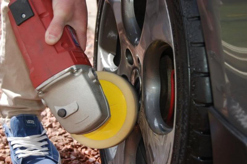

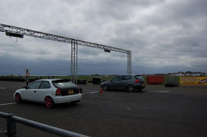

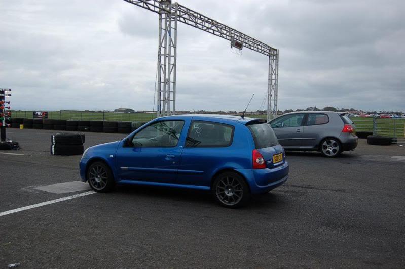

Had the golf up at the REVO vag vs ford day yesterday at crail. Still unchanged with the suspect 230hp map and in honesty the car struggled. All day I was having an absolute nightmare getting the car off the line, I eventually managed to get down to a 15.2 at 95.9mph. This was with a 1200rpm launch, it was the only one I tried like that, maybe another go would have seen a 14?
I dont know if any others were struggling as much on the line?
Anyway some pre crail and track pics taken by a mate  :happy2:
Cheers, Stu.

« Reply #50 on: April 30, 2012, 10:39:40 pm »
polishing your wheels won't get the time down :signLOL:

« Reply #52 on: May 01, 2012, 12:03:41 am »
 :signLOL:
Looks well smart in grey  :happy2:
Thanks mate!  :happy2:

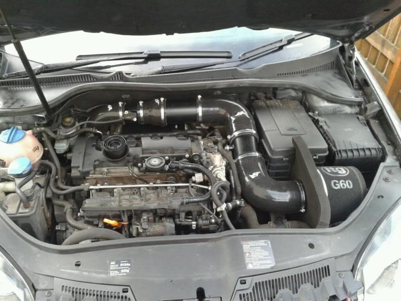

« Reply #54 on: June 02, 2012, 05:26:15 pm »
Drop looks nice on it. Sensible! Liking what you've done so far too mate, good work :)
Thanks mate  :happy2:

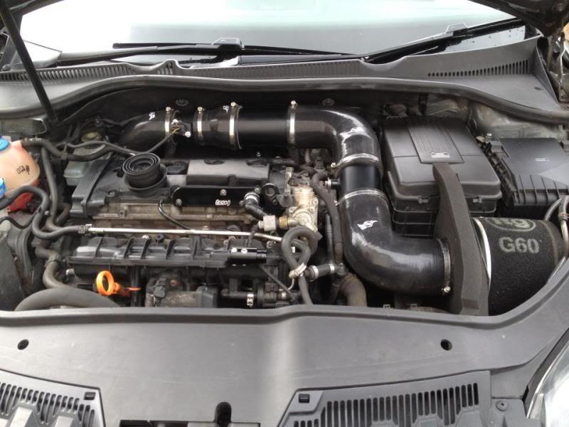

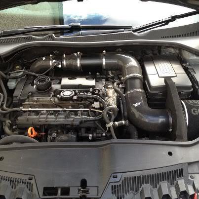

Iv just added another touch under the bonnet before my next remap ( hopefully next weekend if I get the time off ). Quite liked the sound of this mod, I wasnt having to much problems with my PCV but was advised that with a correct map a BSH one is an improvement.
Here are the pics...
Stu.
Slowly progressing. . .
Offline da_ansa
  • Posts: 153
Re: My GTI.
« Reply #55 on: June 03, 2012, 06:50:41 pm »
noticed any differences since changing the pcv? was it easy to fit? thinking of doing mine
Offline N13SCB
  • Posts: 140
Re: My GTI.
« Reply #56 on: June 06, 2012, 01:45:37 pm »
It was easy to fit, I reckon there was an hour in it at the very most.
The only noticable difference is the car idles smoother, I think with a new map though it will hopefully help things along a bit.
Stu.
