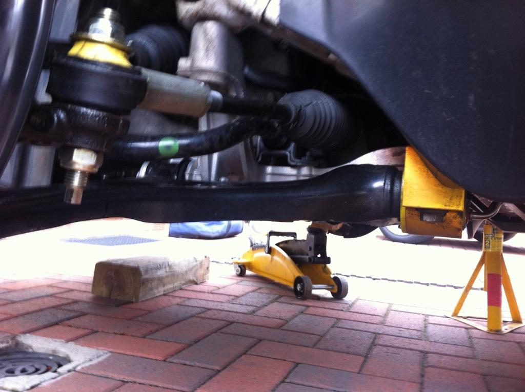

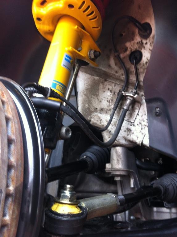

WALK and bump steer kit fitted along with B12 sport line kit

Impressions, mate !!  :laugh:

now my car is lowered i can feel the benefit of the BSK, on standard height it felt strange
now steering is much more positive. it actually takes a little getting used to as less steering lock is required to turn.
impressions of the B12 kit are excellent. excellent damping control, comfort as good if not better than OEM in my opinion as the ride is still firm but not crash anymore.
body roll reduced and cornering definitely feels more accurate.
The WALK is a good mod on a standard or modified car but the BSK is only worth doing on a lowered car i have found.
