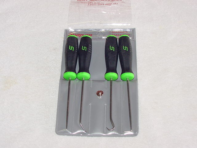

Step number four in the link sort of explains how to get the plug off if it breaks.  This is the pick I use (2nd in from the left):
