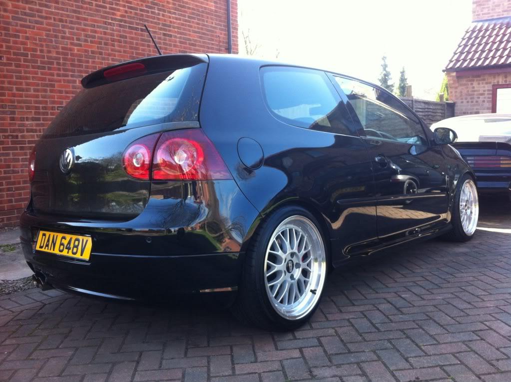

got a little sunshine so thought bugger this im getting my summer wheels on, so cleaned the car and fired them on!

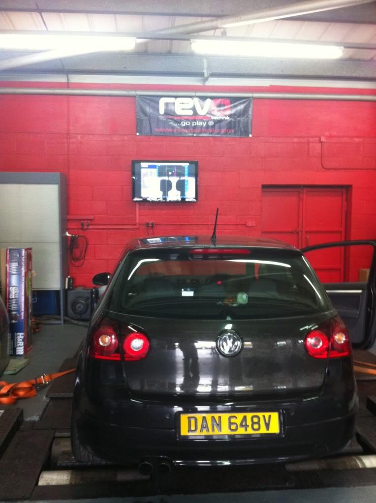

also my Statllers visit has been and gone!! had a good day and met Hurdy (nice guy and evil car!  :drool: )
got there bright and early and the car got strapped down by Steve, ran through what i wanted from the car and he got on it

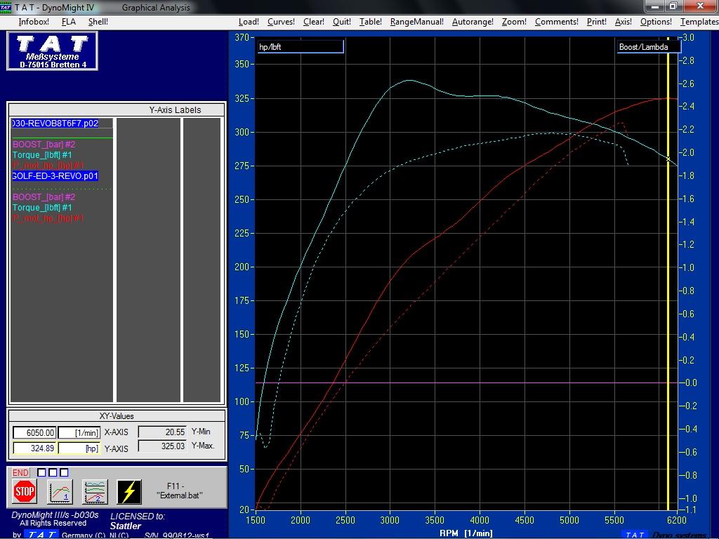

ran the car up on the settings it was on from when i was RDT and produced a figure, Steve plugged the laptop in and got busy running the car up while changing settings within the revo here and there. The more the car was run the better it started to sound, nice and crisp!
Steve asked what plugs were in it (NGK Iridiums) and said they could probs do with a change so i got some Nology Silver tipped plugs off him there and then! Made more power and more torque so happy with that for the money!!
Heres the graph from when we were done, broken lines being old power & torque, solid lines being new power & torque. Its meant to be abit of a heartbreaker dyno so im happy with that!
Originally when i drove into Statllers i was B6 T2 F8 and when i left i was B8 T5 F7, both times on a Stage 2 Revo Linear Throttle map.
The car now is so much better!! alot more low down pull as you can see from the graph and the car just keeps on pulling! All in all a happy lad and just wanna say thanks to Steve and Craig @ Statllers, nice genuine lads and good customer service!!

That looks excellent  :happy2:
What are the wheels exactly?

BBS LMs??

The wheels are BBS LM reps, 8x18 et42 front with a 8mm spacer and rear 9x18 et42  :happy2:
