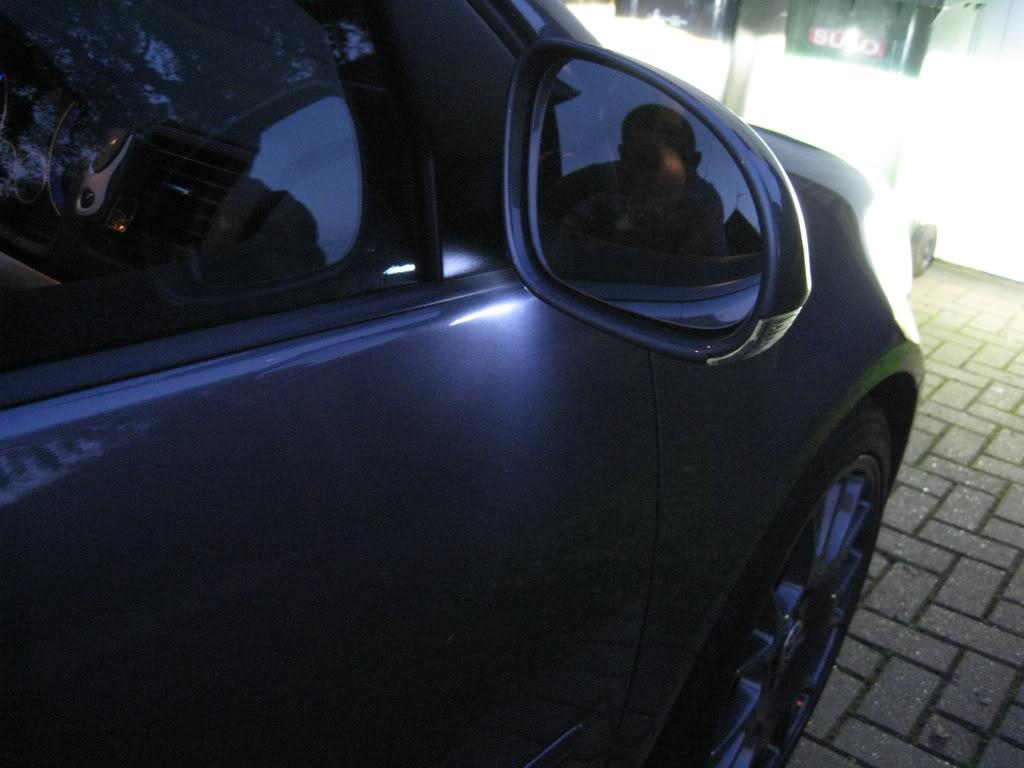

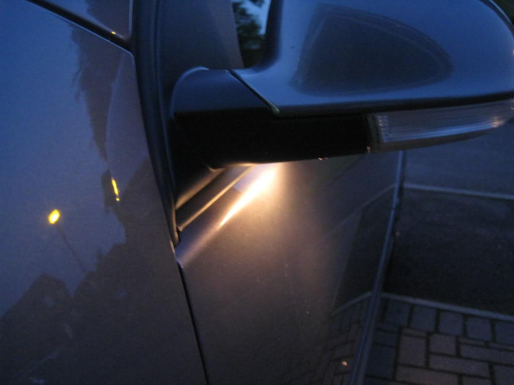

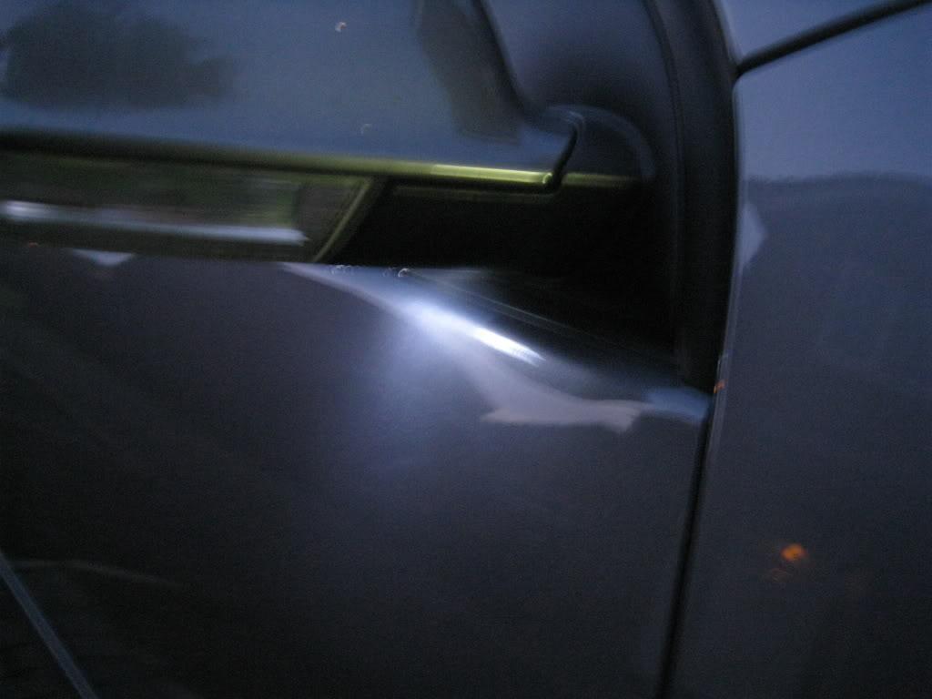

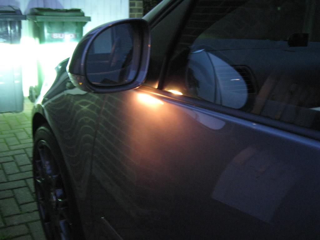

Here my next LED conversion, puddle lights  :smiley:
BEFORE: -
AFTER: -
In the twilight there aren't quite as bright as the stock yellow bulbs but once it's properly dark they look great  :happy2:
And the other plus there is no bulb check on puddle lights so no need for resistors  :drinking:

Yes on the puddle lights is just a bulb change, all you need is a small torx/star screwdriver, takes about 1 min to do  :happy2:
