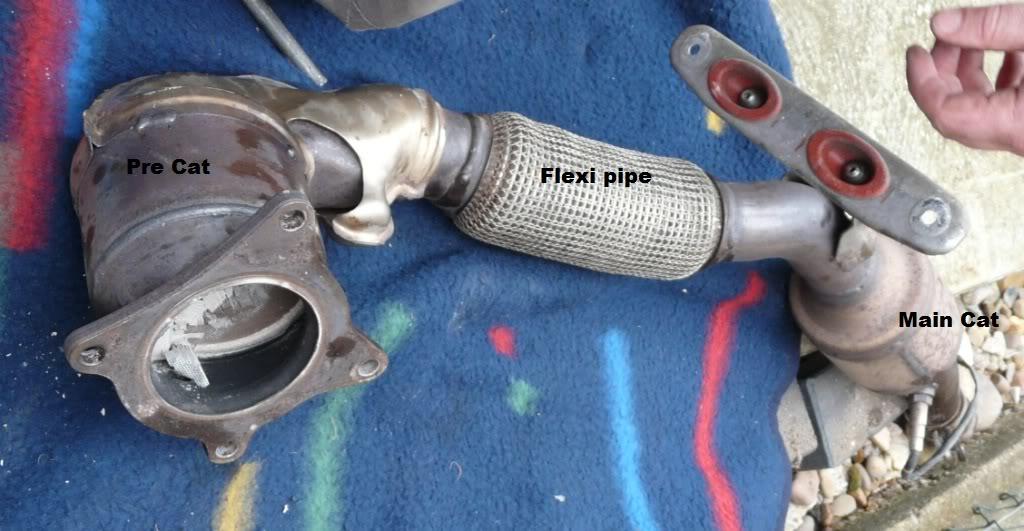

Offline Bogwoppit
  • Posts: 77
Re: Pre-cat. . . . . REMOVED!
« Reply #14 on: January 19, 2012, 08:22:54 pm »
Thought I'd post up my Briskoda photo on here if it helps:
