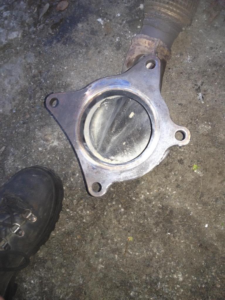

Thought I'd post up my Briskoda photo on here if it helps:
                                                                               I'm not understanding exactly how the standard exhaust separates.  You undo the four bolts at the turbo to release the exhaust, thats all good but then do you take the whole exhaust off, do you split it after the main cat, or does the pre cat come off the exhaust by itself?  I've seen a couple of photos with the precat on its own, but how does it come off?

There's a sleeve connection between downpipe and catback. It has a couple of bolts which are usually rusted and I had to cut them to separate dp from catback. After unbolting it, you just push the sleeve over the back section and downpipe drops down.

Thanks, I have seen the sleeve connection after the main cat (towards the back of the car, where you would put a cat back system on).
So the whole front section has to come off like in the pic above and its not possible to remove the precat by itself?
I suppose some exhaust paste would be a good idea when putting the sleeve back together?
Yeah the DP and Main cat is one section, (quite long, bad design) so take it al off, then just knock out the pre- cat, these is pics of mine.
Good luck...( you wont need it, easy as hell)

All cleared up, cheers.  Wot a pain in the hoop!
