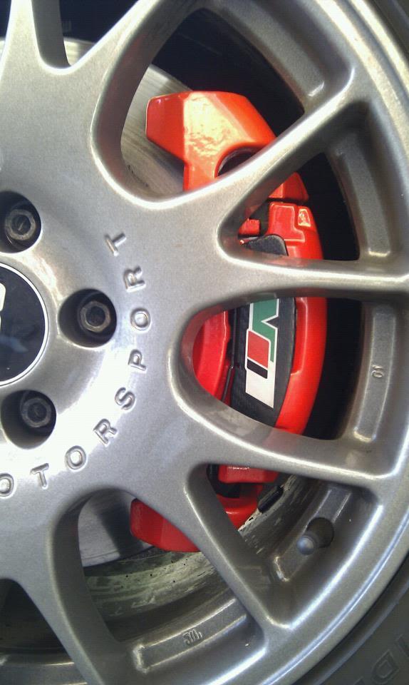

When they arrive I will be sitting on a front an rear set from a GTi and the original fronts from my vRS (essentially the same as the GTi) although the discs and pads are proper fooked, but I do have a new set of front pads.  The plan is get the GTi rears powder coated to match these -
 :evilgrin:
And fit on the vRS, then remove the carrier from the GTi fronts paint them in black hammerite and fit them on the front of the GT along with the GTi 312mm discs and the new pads.  I will probably try to sell on the 288mm if they will fit on lower models in the mk5 range, but not that bothered.  Eventually I will try and get some R32/S3 rears for the vRS at which point I will swap the rears over to the vRS.............does that make sense??  :rolleye:
