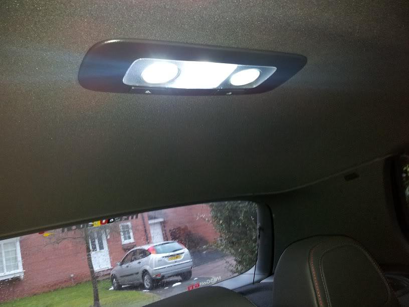

Phil,  I've got a couple of set of these recently for interior bulbs, work well and are very bright, one led on the nose and then 4 around the circumferance.  might provide a solution for you.  can drop a pair in the post to you if it helps with the development work.   :happy2:
http://www.ebay.co.uk/itm/ws/eBayISAPI.dll?ViewItem&item=180737742822&ssPageName=ADME:L:OU:GB:1123
That my friend might just be the answer im looking for, how bright are they? Ive got both my lamps fitted and when it gets dark later i will be out (scalextric powerpack in hand lol) to power them up and switch the side lights on, if you could post me a pair that would be great, let me know how much they are and i will paypal you mate :happy2:

Just taken a picture so you get an idea of the brightness.  They are very bright once it gets really dark.  PM me your address and i'll drop em in the post tomorrow, FOC.  :happy2:

i think you may find they are too bright will not match outers

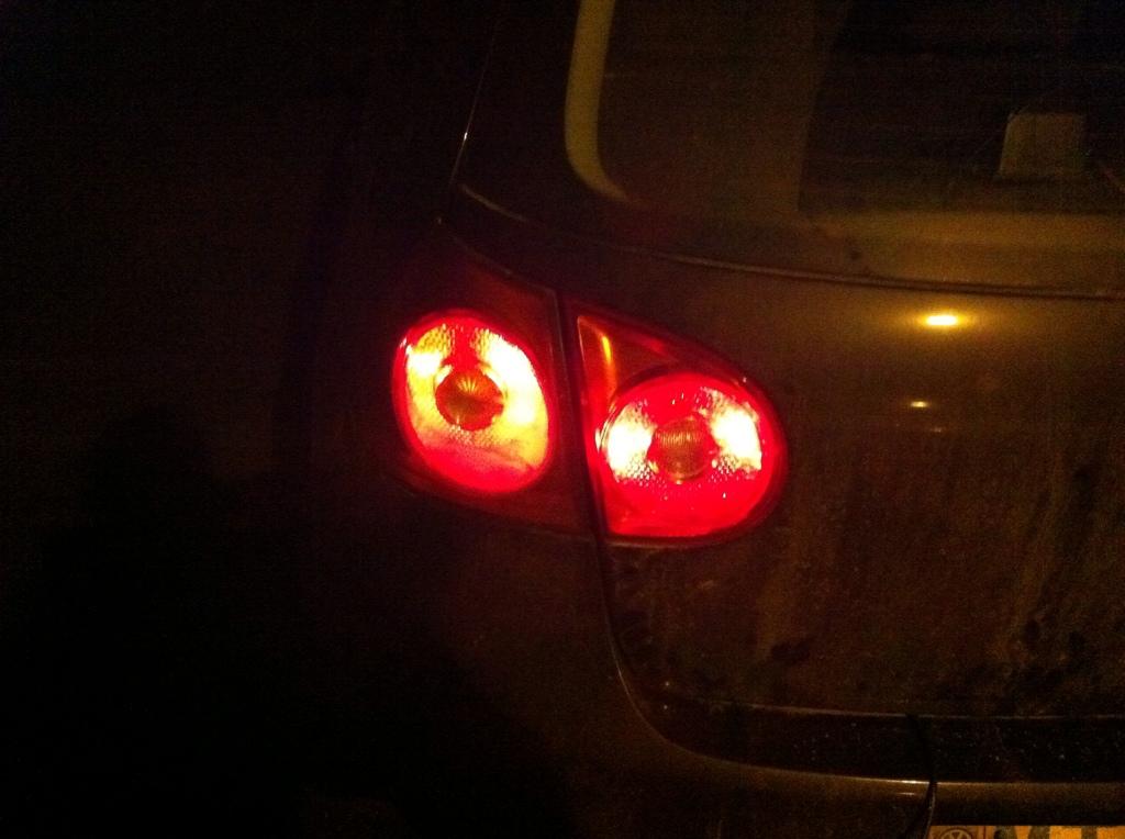

Right everyone its dark, been out with the scalextric controller  :signLOL: and im VERY pleased to say they are not much brighter than the filament outers, if i wanna be mega picky they are RED and the outers look orangeish, so i got my OH out to give me her thoughts and she said they look very smart and wants a set on her mk5 :pomppomp:
now as ive found out taking pics of lights in the dark is a nightmare so ive take a pic with no flash for your thoughts, the LEDs look to have a bright centre there not as bright as they look and im gonna try APPLES idea of sand paper, so here they are
i think the 360 leds will be to bright but if i can take the led on the top out of liting up then that could be a goer, will pm my address now mate :happy2:

What would be ideal is to be able to put a similar bulb in the outers, that way even if the brightness isn't exactly the same the colour will be.

best bet is to stand back away from car you will get a all round better picture of them and see how they match
well i was thinking the same thing mate :happy2: gonna have a look at canbus friendly 382 LED bulbs in red, that way the bulb out warning will still work and the lights will all be the same colour, all in all im really really pleased with them, just waiting to collect my VAG multi plugs so i can connect them to the number plate harness properly, i feel that after the last few days this mod has come on alot from a few ideas to working well
