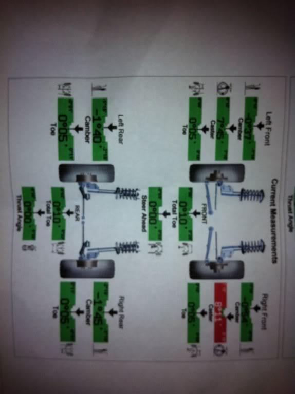

Hi, I recently had 35mm h&r springs, front and rear arbs and walk fitted, after which I had a four wheel alignment done. If my steering wheel is straight my car pulls to the right so i have to drive slightly turned to the left. Im going back on thursday, but can anyone tell me how these results look please.
Front
camber left -1.26
camber right -0.36
caster left +08.08
caster right +08.52
Toe left -00.01
toe right +00.01
Rear
Camber left -01.48
camber right -01.50
toe left +00.16
toe right +00.14
Any help would be much appreciated  :drinking:

Right front camber needs increasing :happy2:

they said camber is not adjustable? i thought that was a big difference though

There is a little movement in the 3 fixings on the top mounts.

Front
camber left -1.26
camber right -0.36
 :scared: A huge difference !! Both should have to be within +-10'.
Did you car have an accident? Possibly one or two struts are bent.
caster left +08.08
caster right +08.52
Not perfect. Same problem as above.
Toe left -00.01
toe right +00.01
Total +0°10' (5' + 5') recommended by Volkswagen. No problem to adjust.
Rear
Camber left -01.48
camber right -01.50
Almost perfect! I'd go for -1°30' though.
toe left +00.16
toe right +00.14
VW rec.: +10' total as on front. So a bit too much. This may cause some humming
with some tyrers (esp. Dunlop and Bridgestone).
"You get what you pay for."

I already told you the values. (degrees + minutes)
The total amount of camber on front is not adjustable.
You just have to keep both sides equal.
But this huge difference will be hard to center even when
shifting the subframe.

my car has WALK and bump steer kit. castor will be slightly high cos of walk but otherwise these numbers are a good range to shoot for. my car was about 1000miles old when i got this done and my rear toe was slightly out from the factory.
