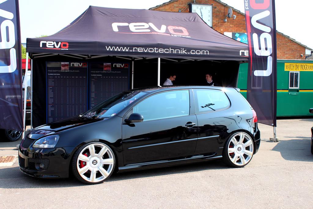

It is very possible. With the change in tyre size down to a 225/30/R20 the overall size will be the same as my 225/35/R19 or standard 225/40/R18  :happy2:
The width and the offset are important though.
A good size to aim for would be 20x8J ET45.
Someone on the forum had some 20" on a Rocco (I think).
Heres a few. Don't know who these belong to....

They look awesome!
Thanks for the info  :happy2:

The one with the Bentley wheels look mean
Which one?  :P

Ha ha, i thought that too.   :signLOL:

the 1st pic looks likes Reubens @ TuningWerkes old GTI  :happy2:

The second pic are 19", Same as the one on my car.
