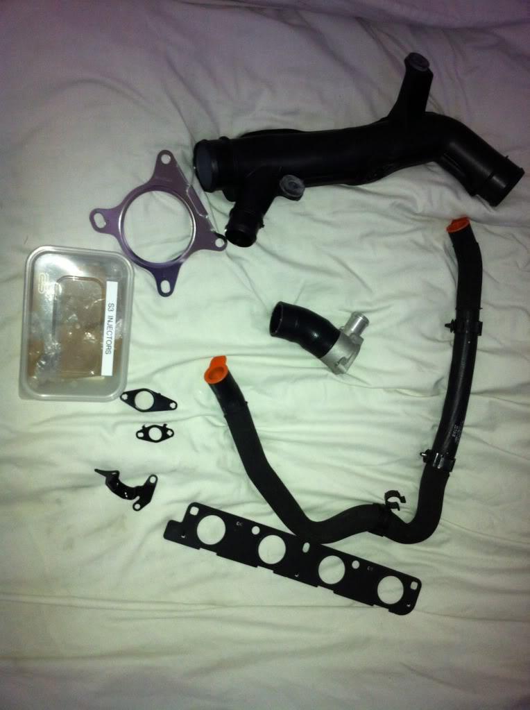

I am just about to do the k03s to k04 conversion, So far i have managed to get the parts for it through VRS Alex, Below are pics of what i have but i just want to be certain this is it all because the last thing i want is my car stripped down and then the need for more parts!
Alex has said this is all il need to do the conversion including the S3 injector upgrade and diverter relocation, Anyone who knows about this stuff help would be greatly appreciated, Thanks  :happy2:
This is the pic that has everything in it just not sure what is nessacary really:

Forgot to add i also have the discharge pipe, The parts i have doubts on are the k03s and k04 oil lines can they be re used from my k03s?
For the diverter custom wiring i am told that it can be extended and brought up to the front instead of making a custom wiring for it is this do able also?

I know what's needed as I fitted mine myself.
You need water and oil line crush washers also the clips for the dv relocation flange (unless you use jubilee clips)
2x m6 nuts to hold the dv bracket to the intake manifold. I presume you've got the fitting kit to go with the injectors? A dv harness is required, as I've said before there is no way the original wire will reach DV, it's about 1.5ft short.
I can't think of anything else at the minute.

I would get a new inlet manifold seal as you don't want to be taking that off again if it's leaking.
Dv wire fits no problem.  I pull the wires back to the end of the coil pack harness which is the perfect length to reach the dv round the front.
Some of the early cars have bolts rather than threaded studs for the dv bracket.

So it seems I have everything ready for the conversion then  :jumpmove:
Alex did you give me all parts needed for the s3 injectors also so plug and play?
All plug and play.   :drinking:
