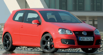

Volkswagen marked the GTI's 30th anniversary by producing the GTI Edition 30.
On sale in November 2006 from £22,295 RRP,with a (supposedly) limited production run of only 1500 (Europe models)
(but VW went on to produce an estimated 2400 ??)
The Edition 30 was available in 6 colours;
Tornado Red, Black, Candy White, Reflex Silver (Metallic), Steel Grey (Metallic) and Diamond Black (Pearl).
Check out the your favourite colours in >> The Colours Section <<

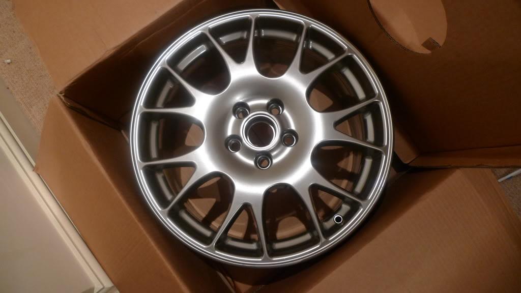

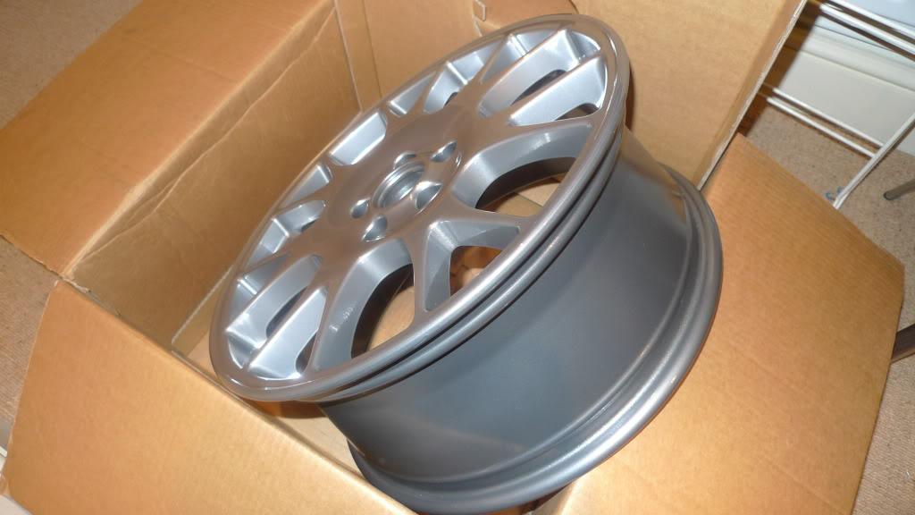

Standard specification
- BYD 169 kW (230 PS) Engine (very close relative of 8P S3 engine), with K04 turbocharger and remote front mounted dump valve
-  dependent on the destined market  the Edition 30 was available with
   UK market = 18" BBS originated 'Pescara' alloy wheels
   other         =  matt black versions of the 18" 'Monza II' alloy wheels.
   225/40/18 tyres of various makes fitted as OE
- Half Leather seats (Interlagos/leather) which are heated and have electric lumbar support
- All the lower skirts / bumpers around the ED30 are colour coded
- Smoked Rear Light Lens (common to R32)
- Lots of ED30 badges around the car and red stitching on the seats, mats,handbrake and steering wheel

Help!
Apologies if someone has already discussed this topic but I'm new to this site.  I own a Edition 30 GTi on an 07 plate which requires 2 allow wheels refurbishing.
My VW Bodyshop in Cambridge tell me that they can't match the wheels to to the existing ones so I will have to have all 4 painted.
This is utter madness - is there anyone out there who knows what the paint code is?!!!
Thanks in anticipation
Lisa
Re: Volkswagen Golf MkV GTI Edition 30 : FAQ
« Reply #10 on: April 27, 2010, 12:58:06 pm »
Welcome Lucy. It is true VW cant match there own paint work on your alloys the pescari's  :grin:
It is indeed very difficult for anyone to get the correct shade for some reason with them. Depending on how bad the damage is it might be worth ringing up a independent, who should beable to match the paint and repair for about £50 a wheel ( if it's just a couple of scuffs).
Failing that it would probably be cheaper to get all four wheels repainted at a specialist than getting VW to paint just two wheels.
Where are you based, we could probably find you decent refurbers nearby.  :happy2:
