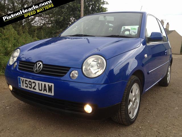

Car was collected on 18th August. Most modifications completed by 26th August. :)
This is Gemmas new car doubling up as our joint daily. Low mileage, excellent service history. Good options for a Lupo. 60+mpg.
As advertised on Pistonheads.
Lupo TDI Sport by LukeDeakin, on Flickr

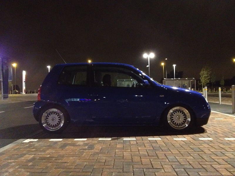

How the car sits now with the slightly improved ride height. Looks great imo!!
Lupo Slammed on Lenso BSX, Coilies and G60 brakes by LukeDeakin, on Flickr

WOW!! What an awesome Lupo. Lovely colour as well. Are you planning to colour code the lower sections of front and rear bumpers and that interior?
Ride height is spot on!

It's had to go up a little bit. The driveshaft was catching on the chassis majorly. It was literally at air ride height. Lol.
