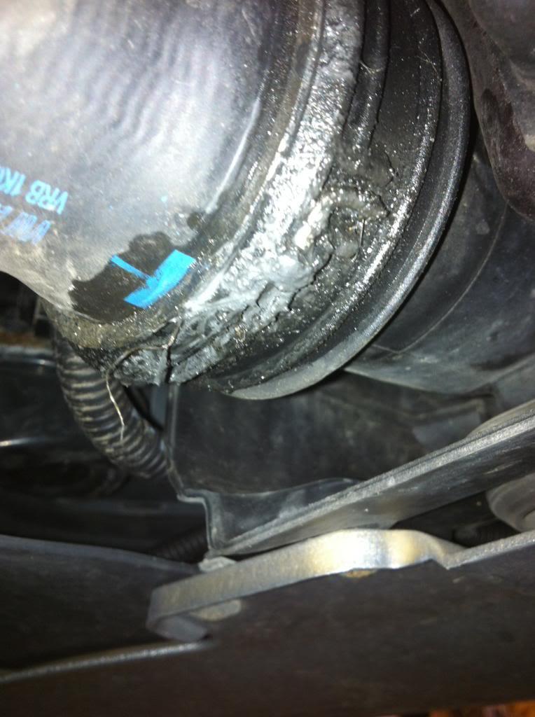

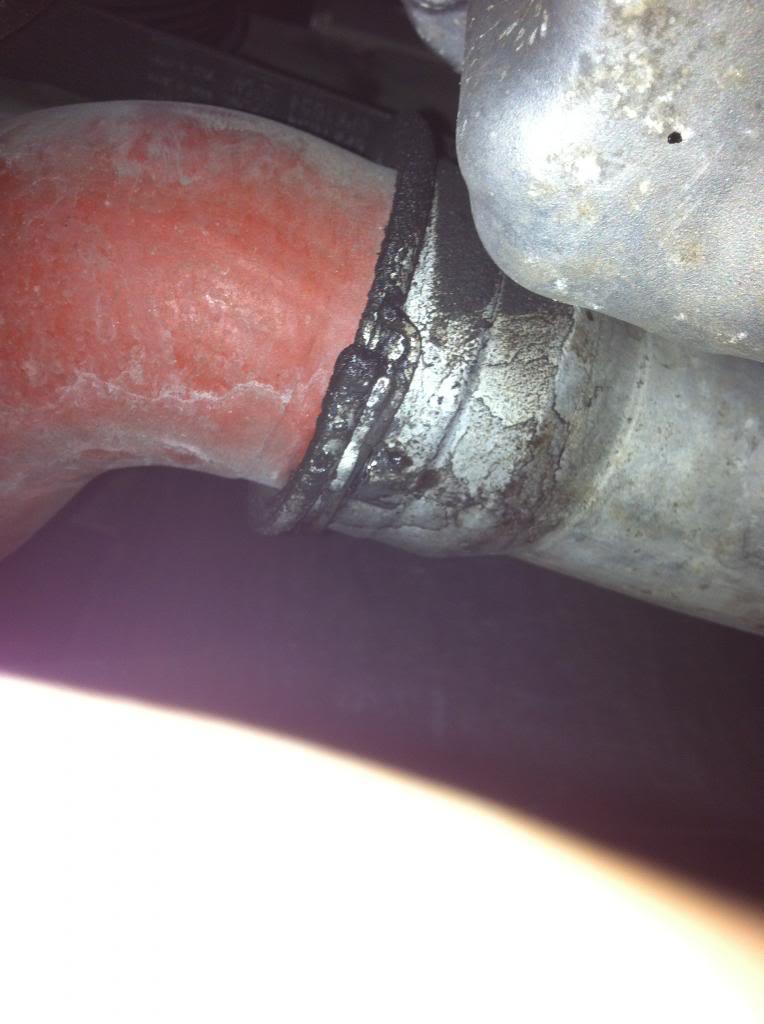

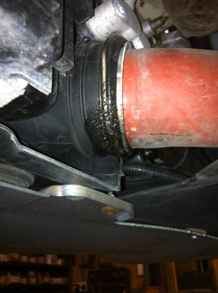

Tonight I got the car up on the ramp to have a look round the hoses to see if there was anything untoward...
There is a slight oil weep at different joints on the main turbo pipes.  If I am incorrect with naming the pipes please say...
This is the Joint at the Inlet to the intercooler(???)
This is the joint just back upstream from the inlet
This is the intercooler outlet joint(???)

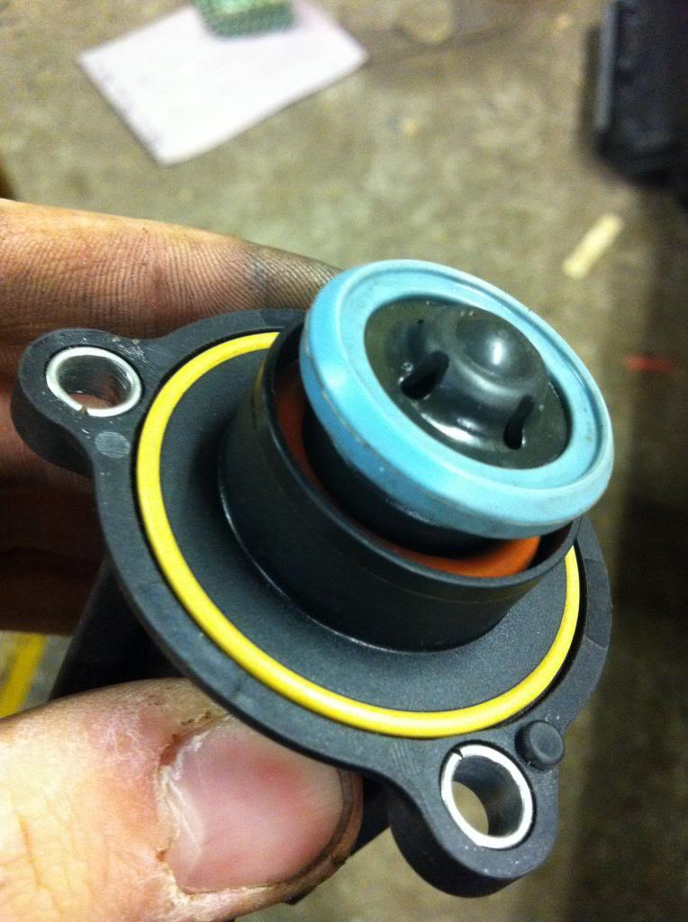

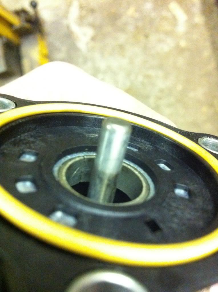

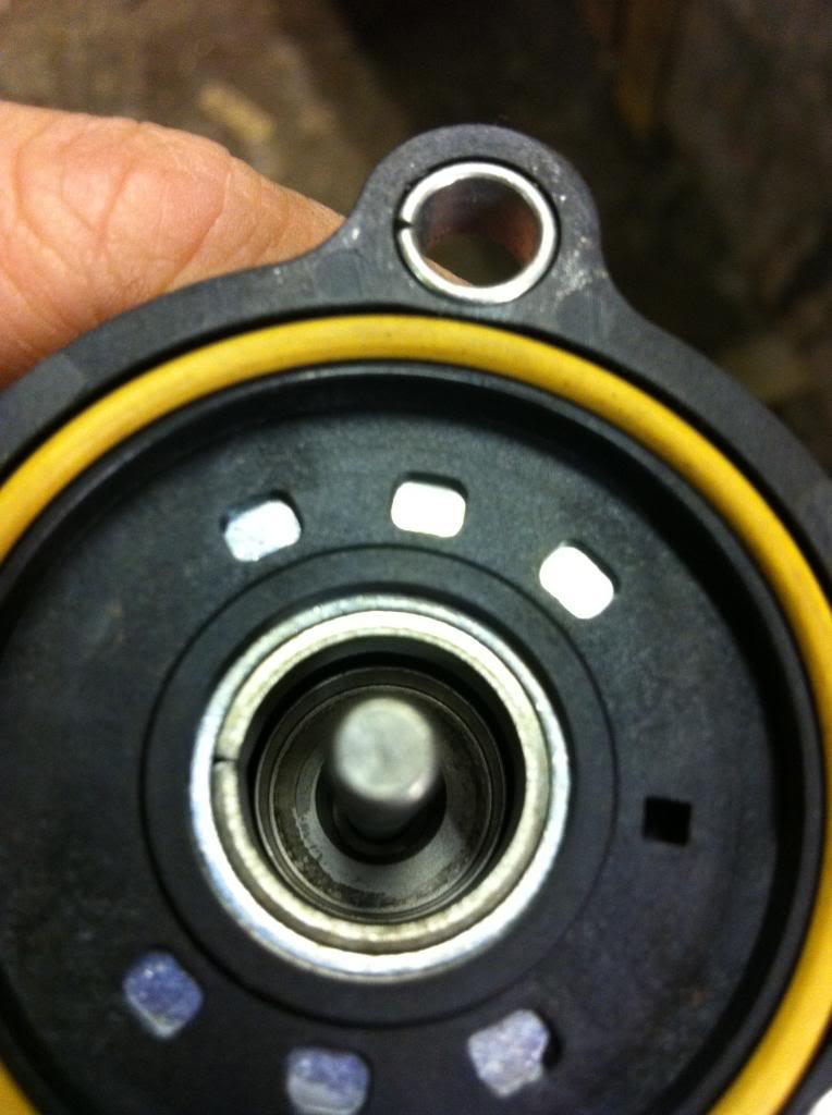

And here is a few pics of the DV...seems ok to me...
Sealing face on the valve is in good nic.  Never took a pic of the diaphragm but its fine too.
This was a bit concerning but I'm assuming its a split bush thats meant to be split and it hasn't cracked!  You can see in the pic that there is a bit of wear where the split is, possibly the valve stem rubbing a bit???
And again from the top
Apart from this, my inexperienced eye, could see nothing else that looked potentially problematic.  Could someone please tell me if any or all of these things are normal??  Too me, if oil can weep from those joints then air must do aswell so that could be the issue?? and also if the valve stem/shaft is rubbing on the bush this could be restricting the valves movment and therefore won't be functioning normally???
PLEASE HELP!!! :scared:

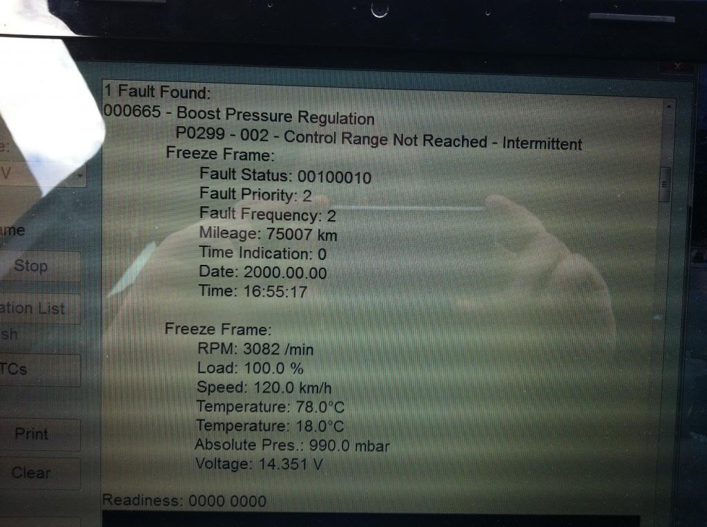

Got my mate to scan for faults on vagcom and this is what came up...
Does anyone know or has had/seen this falt before?  According to vagcom its only happened twice but its a lot more than that!
Any ideas on whats up with the car???

Just found this on rosstech website.  Where is the charger pressure control located?  Hope its not the Turbo! :scared:
 16683/P0299/000665 - Boost Pressure Regulation: Control Range Not Reached
Possible Symptoms
    Reduced Power Output
    Limp Mode
Possible Causes
    Hoses/Pipes incorrect connected, disconnected or leaking
    Charger Pressure Control defective
    Turbocharger faulty
    Diverter Valve faulty
Possible Solutions
    Check Hoses/Pipes to/between Components
    Check / Clean / Replace Charge Pressure Control      <<<<< WHERE IS/WHAT IS THIS???
    Check Turbocharger
    Check Diverter Valve
Special Notes
    When found in 2.0l TFSI:
        Check Boost Pressure Control Valve (N249), for cracked rubber diaphragm. A new/optimized Valve is available under Part # 06H-145-710-D (or newer).
            RoW vehicles see: TPI 2016331 for details.
            NAR vehicles see: TSB 01-07-70 or 2013392 for details.
        When stored in conjunction with misfire codes and/or fuel trim faults see the notes associated with the following faults regarding PCV failure: Crankcase Breather Valve
    If the Turbocharger is faulty due to mechanical / internal problems or the exhaust system is restricted (typically the Catalyst) this fault may be the end result.
    When found in VW Golf/Jetta (1K): 2.0l CR-TDI (CBEA/CJAA):
        Verify the mechanical part of the Exhaust Valve Control Module (J883) is not siezed or binding.
