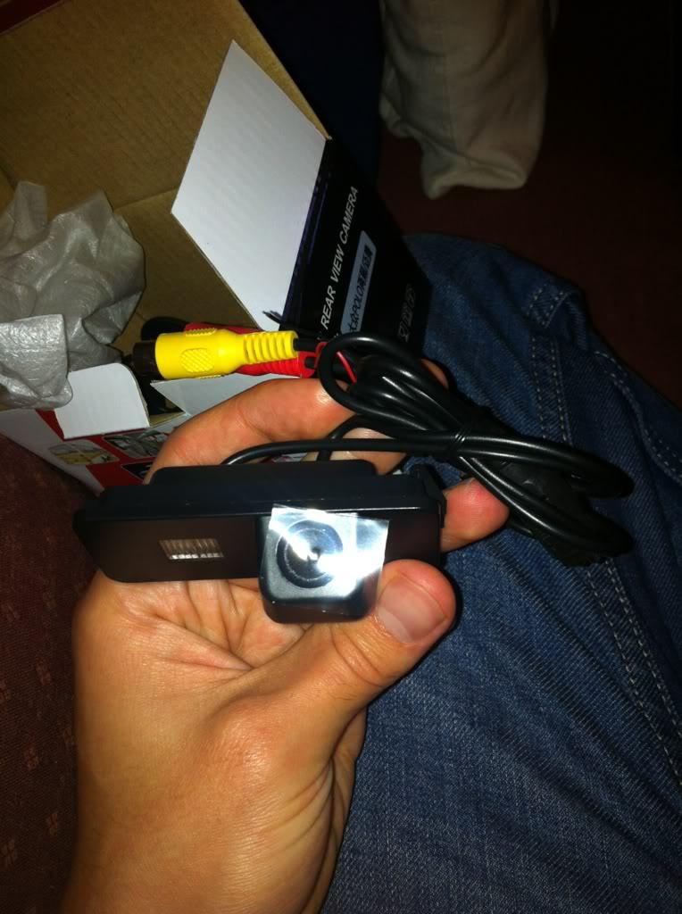

« Reply #17 on: October 17, 2012, 06:34:35 pm »
Arrived today, no instructions but looks simple enough.

i mentioned earlier that i've used these for a while and they are ok, but not perfect. the one joe has is the same.
you run a 12v, GND and video cable to the HU. assuming it is OEM or has a CAN box then it works automatically in reverse. with my zenec i can have it running on screen permenantly if i wanted.
there is no bulb out error when removing one light but looks better with a CANbus white festoon opposite it to blend in.
that particular camera 95% fits the bulb holder location but it's pretty much hidden.
have run a few cheapo cameras in on different cars. don't expect it to match a £300 OEM camera but they're more than good enough.
