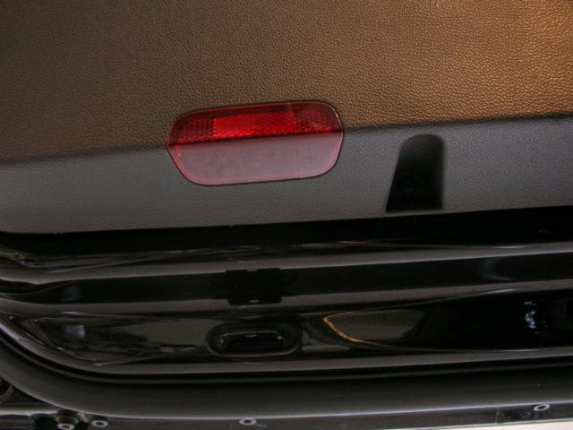

Or stick with the OEM Reflectors (no additional cost or effort required) part number 1K0 947 419 A

Daytime....
NIGHTTIME....
