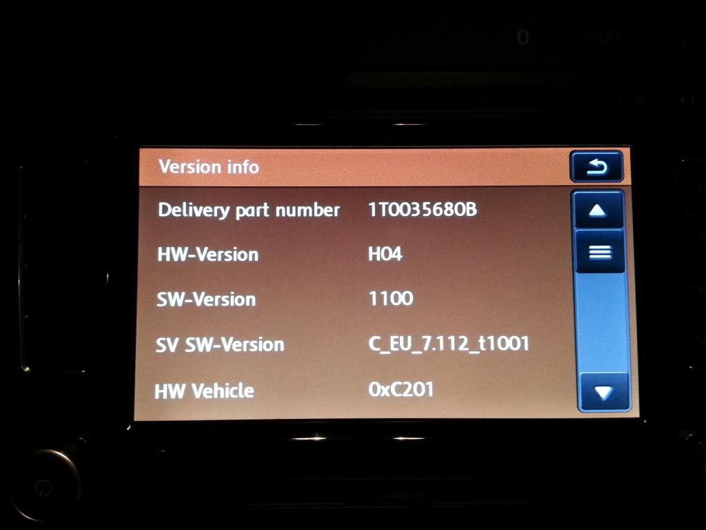

I've only got 2 32 gb cards unfortunately :( just been out by the car and took this there is an "I in the top corner and this is the version number.

thats really early firmware 1100 and you have a version B unit, i'm positive you can only use a 4gb card in it for now, you can update the firmware on the 510 at some point to allow bigger cards and for it to do other stuff but this will defo be your problem mate.

Ahh that sucks will my unit take the latest software? If so is there anyone on here that could sort me out or is it a case of download and burn? Cheers for the help
