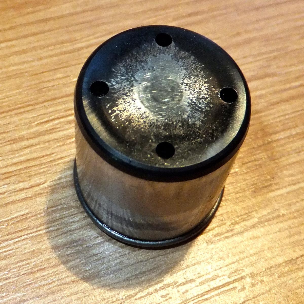

Stage 3 only happens if you have an early A camshaft.   Only goes domed shaped if the cam is f*cked.  So I would say your cam is fooked and the follower will already be dead again.  You need a B cam and a new follower.  Get it checked asap.  Is your gti an early one?
It's a 55 plate, with 105k on it drive fine
Keep an eye on it.  May drive fine for now but it looks like you have the early cam.

Re: Cam follower - you're all perverts!
« Reply #73 on: December 18, 2012, 12:03:16 am »
Looks pretty simple to do yourself! Does anybody have a part number for this part??
Thanks
....For Mk5 GTI it's 06D 109 309 C.
Here's mine when replaced at 100,000 miles when I changed to an APR fuel pump:
