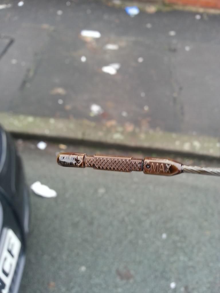

Hi, I am abit confused with the dip stick after few times checking the engine oil level..it this considered low? because there is some oil on the max indicator level even after few times swiping it off and re-dip..

That's low-it's on the minimum line. Get it filled asap.
Stuff on the max line is just a bit that's been caught on the stick somehow.

Thanks mate, based on your experience is that a 1L fill up required?

low,
I wuld sa more like 1/2 a litre. ake sure you dont over fill it.

Thanks for the help..filled 500ml up..only half way through..need to buy another 1L..any direction for best price Castrol 5W40?

Min to max is 1 litre, that could have taken 1 litre with no trouble  :happy2:
Keep checking your oil regularly, your car (like my old gti) obviously burns some. You don't want to be letting it get that low again. Turbo cars rely on oil to keep the turbo lubricated. . .
