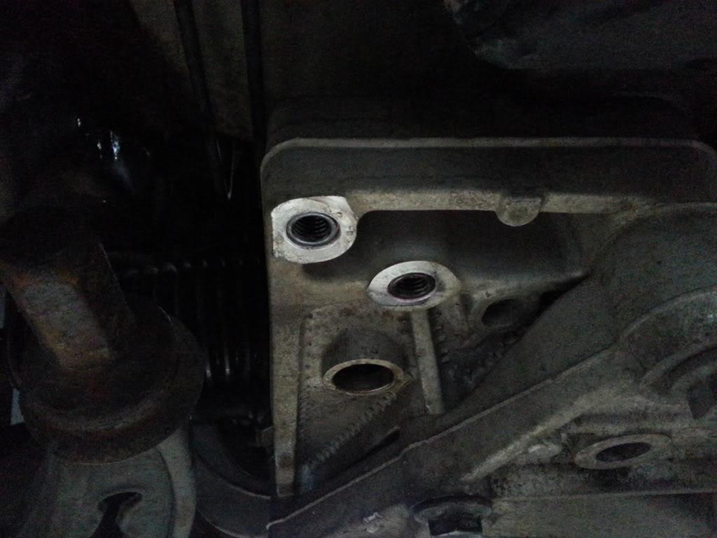

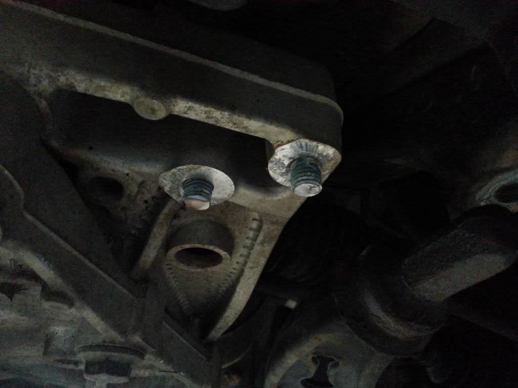

Looks like £33 for fitting it. Only trouble was one of the bolts snapped in half when they were removing the old parts and so I had to wait 2 weeks for them to get a new centre console in stock (the big metal plate that sits underneath the front of the car). So that cost me another £150 including parts and fitting. For the price altogether I wish I had gone with a set of ARB's instead!
I had three bolts snap in my other car which is an Altea on Xmas Eve when swapping from the WALK to the SALK.  I just drilled the old bolts out and replaced with Timeserts and new bolts.  Had a bolt snap in a GTi the other day too.  No need for a new section of subframe.
TBH if the rear toe bolts have seized then they will need new bushes and bolts.  Had to cut quite a few off recently and replace with poly bushes.  No other way around it, but I can usually get enough twist in the bush to get the alignment better.  Never had camber bolts seize even on very high mileage cars.
[/quote]
[/quote]
They've told me that both the toe and camber bolts were seized up!

These console bolts are a pain - they stand proud of the aluminium, gather dirt and suffer galvanic corrosion, resulting in them galling horribly when you try to remove them. Happened on my car, but thankfully the bolts sheered with enough of a bolt still above the aluminium, so I removed the affected parts from the car, welded a nut on the top and then turned the bolt out through what would ordinarily be the top.
Had the same fun removing an ARB droplink on my other car recently - ARB droplink ballt joint / pinch bolt made of steel, hub made of aluminium......
