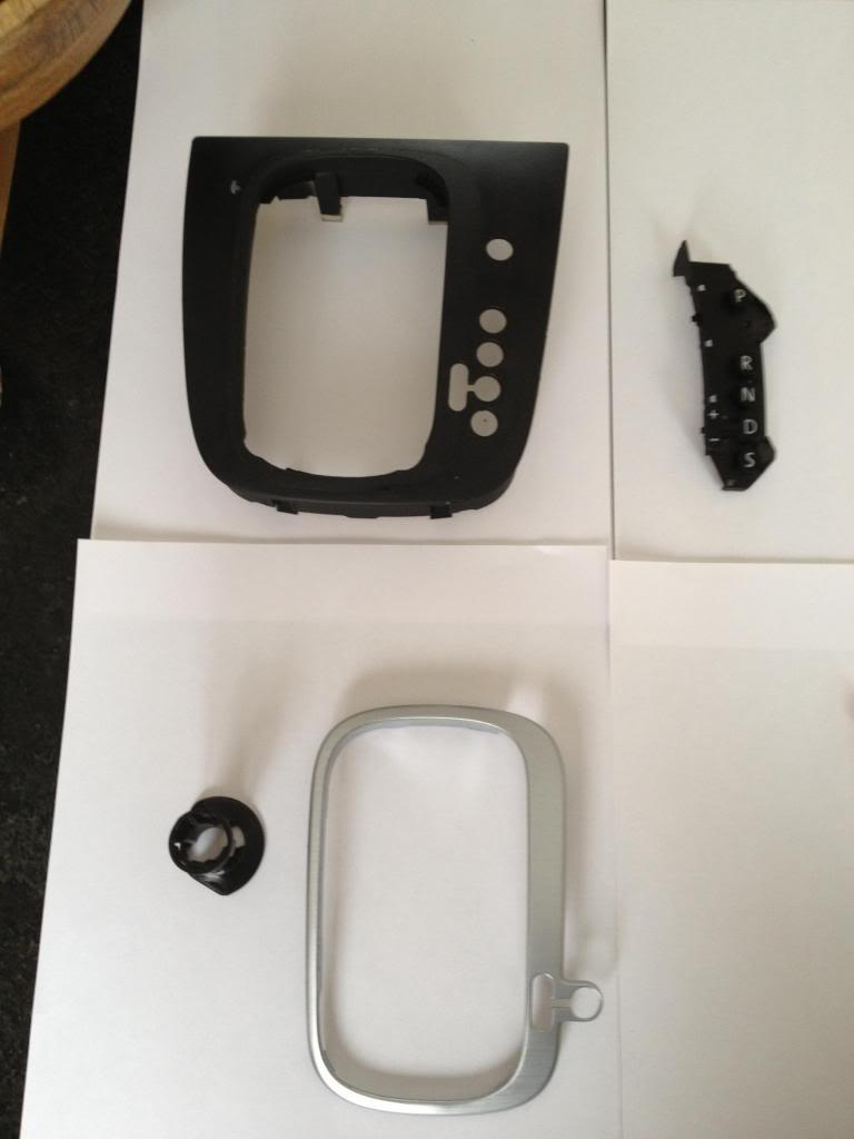

Here are some pics to show you what i did:
All Taken out:

Very nice, going to do this myself, did you get the black colour option carbon? Also how do you take the surrounding off for the gear lever don't want to break anything
Offline GTI-Ross
  • Posts: 1057
  • Learning All The Time :)
Re: 4D Carbon Fibre Wrapping Looks Real Nice !!! - Pic Heavy
« Reply #3 on: January 26, 2013, 06:13:00 pm »
Easiest way to do it is, slowly but firmly pull up on the gaiter, should just pop out. The hardest bit for me was getting the gear knob off the gear stick, dont know if mine was just stiff or what, but i had to give it a massive pull, finally came off. Then (if DSG) undo the circuit board for the gear lights.
Once full out, simply just pop the silver part off, best to turn it up side down and do it. went pretty smooth, all in all took about 1h 30min including removal from car.
Well worth it though as my plate was scratched and a new one would have cost about £150+ - so nice easy mod.
I chose the black colour - got 3000m x 0.75m - had plenty and a bit spare.

It's come out real nice fella!  How was it on the fiddly bits??
Surprisingly enough, it was quite easy. As long as you take your time and most importantly, get a very sharp stanley or medical knife.

Old thread I know, but how did you get the circles so perfect around the PRNDS?
guess steady on your hand and a very sharp knife would help and a heatgun.

Did it by just cutting a small X in the middle of circle, then used heat gun to send the flaps inwards, waited for them to re-harden and cut with a sharp scalpel.
Just go slow and steady mate.
