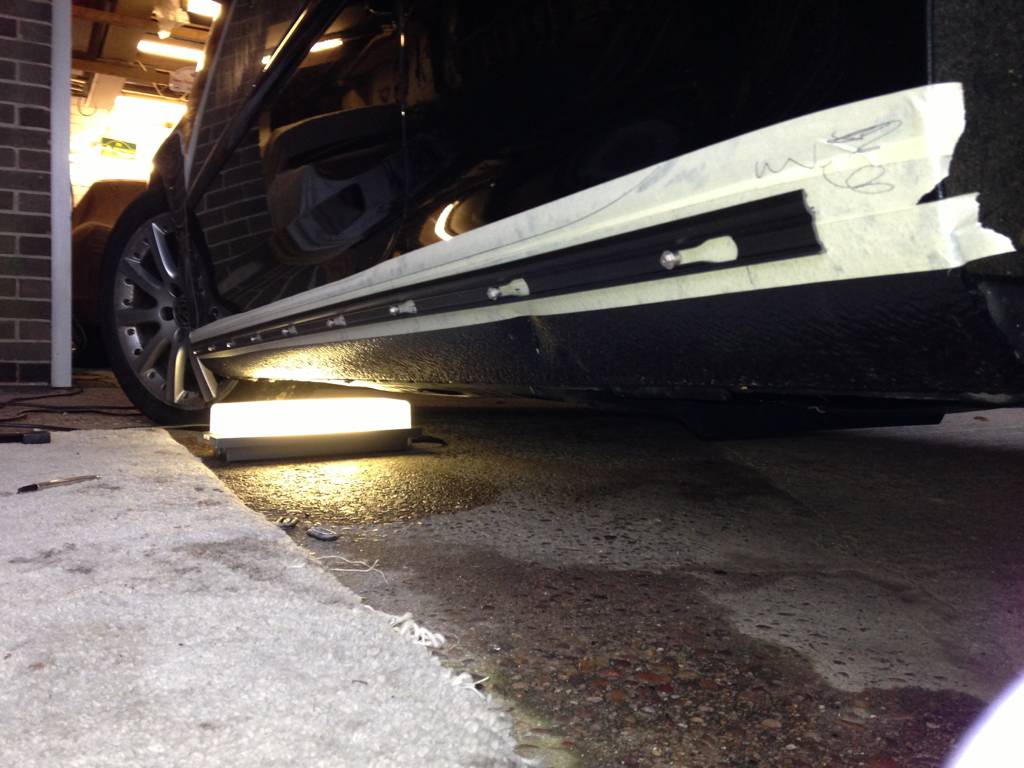

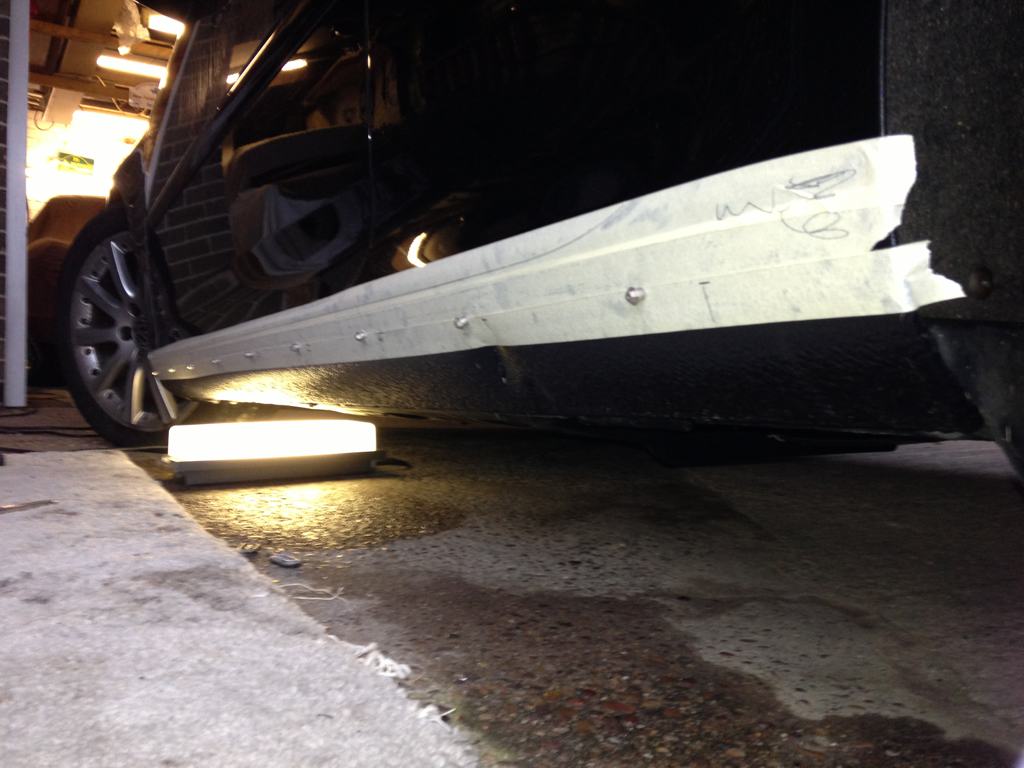

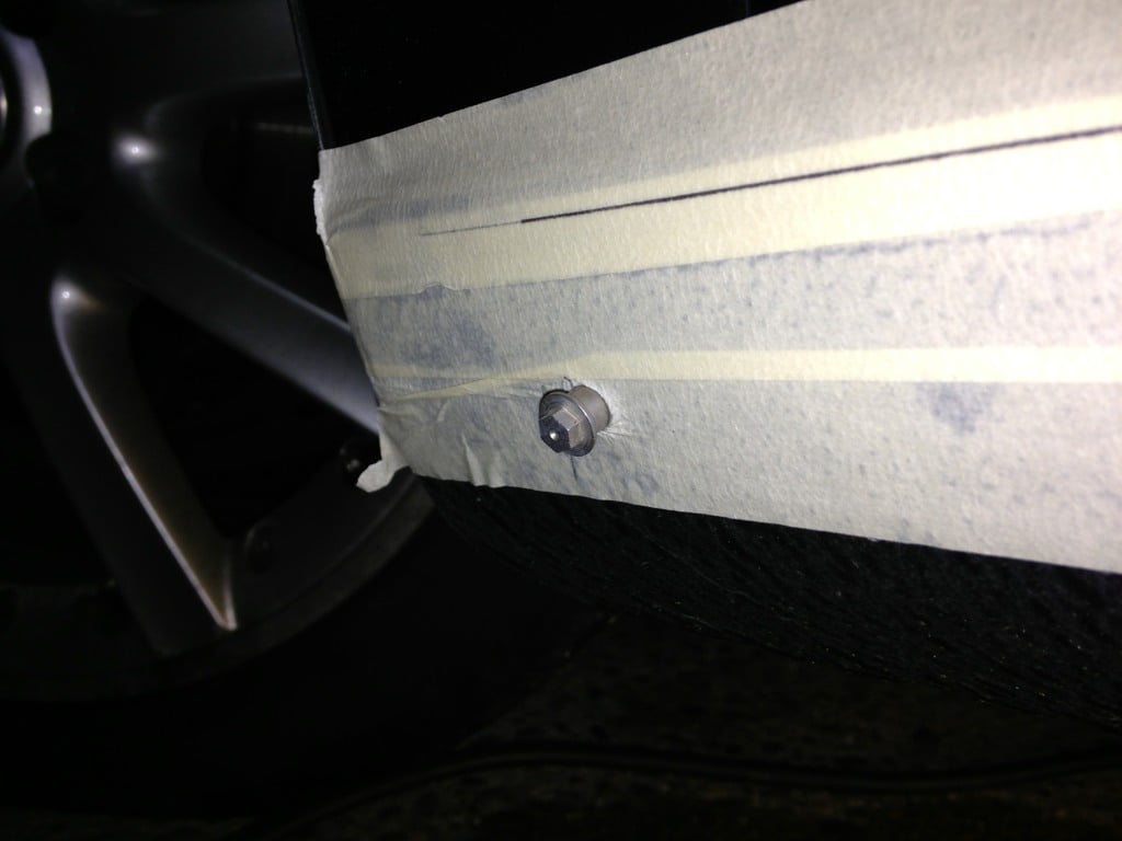

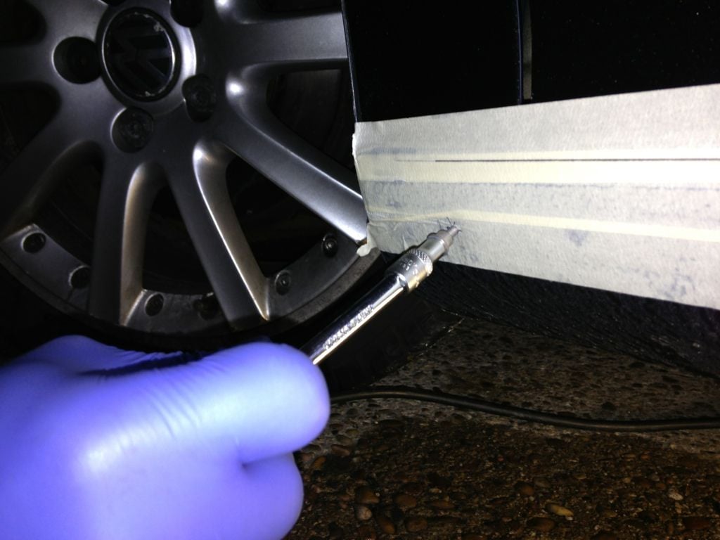

Masked off the area that the screws were to be drilled and fitted into.
Offered up the sideskirt and marked the top part in pen. I measured down from that line. And marked off the holes I was to drill.
After marking the holes punched a small indent to guide the drill in.

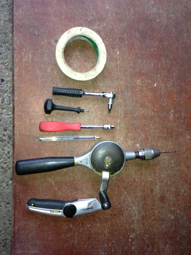

Using a retro hand crank drill with the correct size drill bit started drilling the holes.then began fixing the screws in (bloody ball ache)

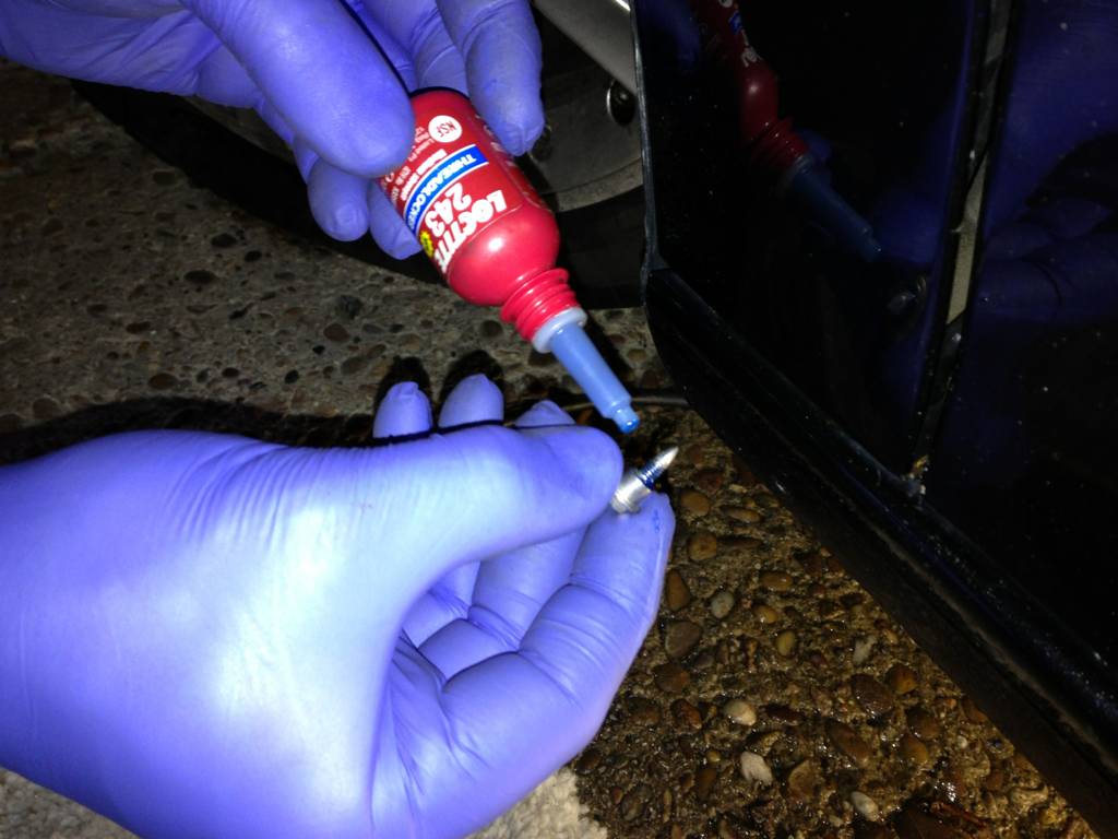

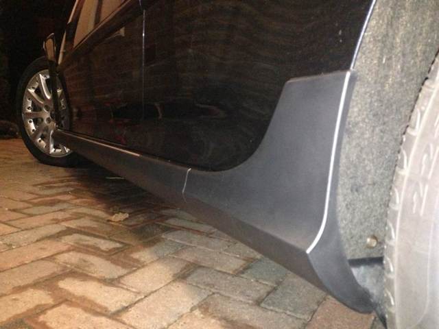

all bolts inretaining strip located.
Then removed all tape, used some loctite on the screws. And hooked the side skirts on. final job was just to put screws in the front arch. Two underneath, and one towards the rear of the skirt. Remove the sticky protector on the sill and stick onto bodywork when all in place and secured. Finally a pic of my tools of choice for the day :)
