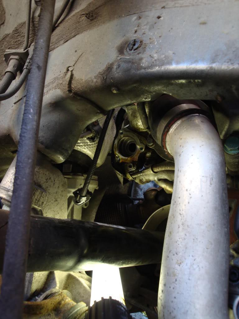

Fitting is quite easy.  Remove OSF wheel and front of the wheel arch liner - the bit with the vent for the brakes (you will know it when you see it).
Once removed the DV is just behind the inner wing.  The photograph in the first post will help you recognise the location.  It is fastened on by three 5mm alan bolts.  They are a little awkward to get to but not that bad.  I have a Halfords Micro Pro socket set - about £30 if not in one of the 1/2 price sales.  It is the best bit of kit I have ever bought, for just over a tenner and the instant replacement of broken bits for the pro range can't be beaten.
The kit has all the adapters in it to remove the wheel arch liner and the alan bolts.
Use a bit of thread lock before refitting.
All in all took about one hour from start to finish.
Hope this helps.
