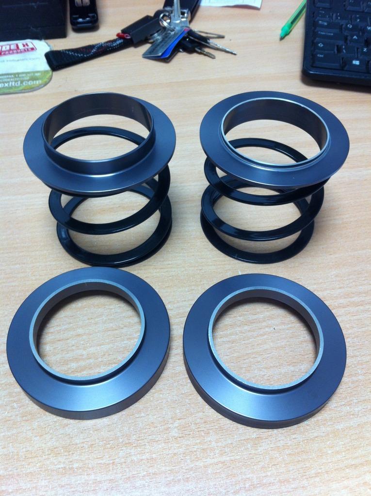

I know it's an old thread, but other than fab5freddy, has anyone else recently taken the Ohlins plunge?
Trying to get technical details and advice on the upper rung coilovers is quite tricky as so few people use them.
My queries are:
Do they REALLY need 30K rebuilds?  It's a road car only, so this would be annoying.  I know some people say you don't need coilovers on a road car, but I disagree.  It's just a method of attaching a spring/damper to a car.....the DFV dampers are still a benefit on the road.
Where can I get 1" longer springs for them?  I want to run them at factory ride height.  Even -20mm is causing me clearance problems on the road with stock wheels (no spacers).
Can these be used with the Race spec Ground control top mounts?
Basically, I'm aiming to get the flattest cornering without using ARBs.  I'd rather do it with springs, dampers and geometry.
Thanks!
@Bernhard30 and @fuscobal might be able to weigh in with the rebuild scenario. Mark uses his for road use only i believe, whereas Fuscobal would do a lot of track days, so might be varied results there, both are probably around that mileage now possibly??
These just landed today  :jumpmove: Finally getting them fitted on Wednesday
This was the missing piece of the puzzle to mate them with the ground control camber plates.
