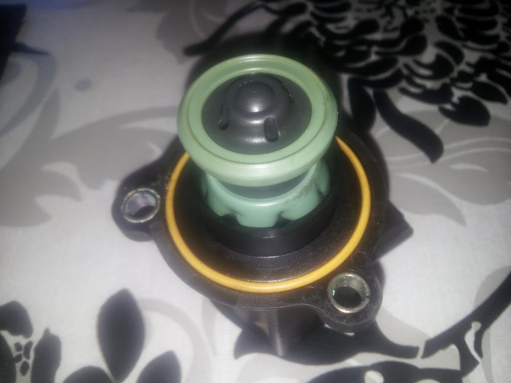

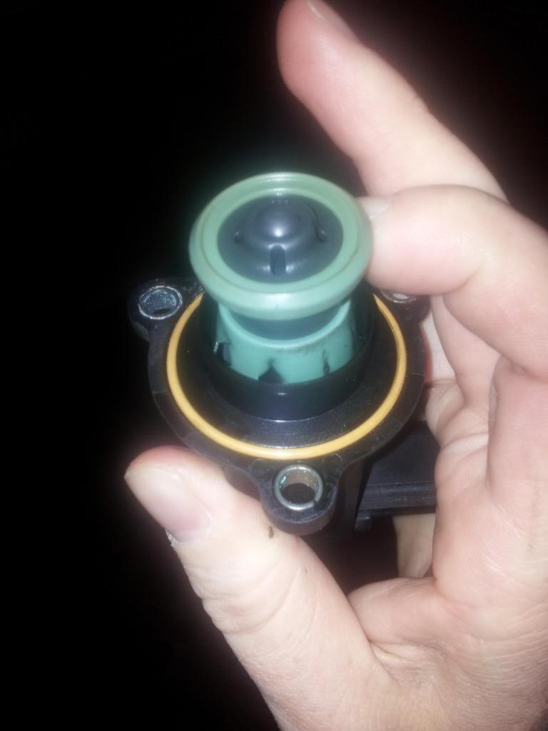

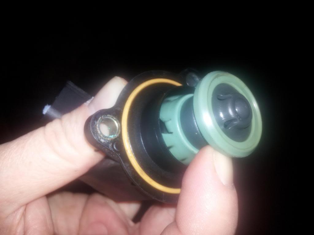

DV changed....OH MY GOD!!!!
« on: April 01, 2013, 08:12:47 pm »
Finally got around to changing this on Sat and replaced it with a Rev G, as you can see by the pics it was absolutely knackered and I'm actually wondering now if the car has even been on full boost since I got it because Christ on a bike what a difference.....I was supposed to be getting rid later in the year but I am going to struggle now, I've just fallen in love with it all over again.  :grin: :grin: :grin:
Re: DV changed....OH MY GOD!!!!
« Reply #1 on: April 01, 2013, 08:17:01 pm »
 :laugh:
That's in shocking condition! Bet it feels like you've just had it mapped.

I want to know if mine is 'cracked'. I have no fault codes, does this mean that my DV is still good, or can this also happen without causing faultcodes?

I was thinking that, how do you know when the DV is ***** or is it just advised to do it? What was your motor running like before replacement?
« Reply #8 on: April 04, 2013, 07:33:24 pm »
For a £35 part its worth changing as a precautionary measure, yours is probably going to be the original one (unless you've already changed it) so its well worth it IMHO.
« Reply #9 on: April 04, 2013, 07:53:56 pm »
Look at the rubber diaphragm.... if its torn you need a new one.

But CAN or CAN'T you see it in vcds?
Offline olufsen
  • Posts: 105
« Reply #11 on: April 04, 2013, 08:06:40 pm »
Boost requested, Boost Actual is a good indication no doubt.

Is there a vague idea of what mileage these are expected to fail at?  Mine's only at 60k and seems to pull lovely and strong (though I've just gone from a PD130 to a 2.0 TFSI)
Offline beetie
  • -Given: 34
  • Posts: 178
« Reply #13 on: April 04, 2013, 08:53:53 pm »
What about if you have a rev D. Do they still split, aren't they plastic and not rubber?
Might still change it if it's recommended, especially as it's so accessible on an ed30
« Reply #14 on: April 04, 2013, 09:22:18 pm »
^^^^ they don't split, they leak.
