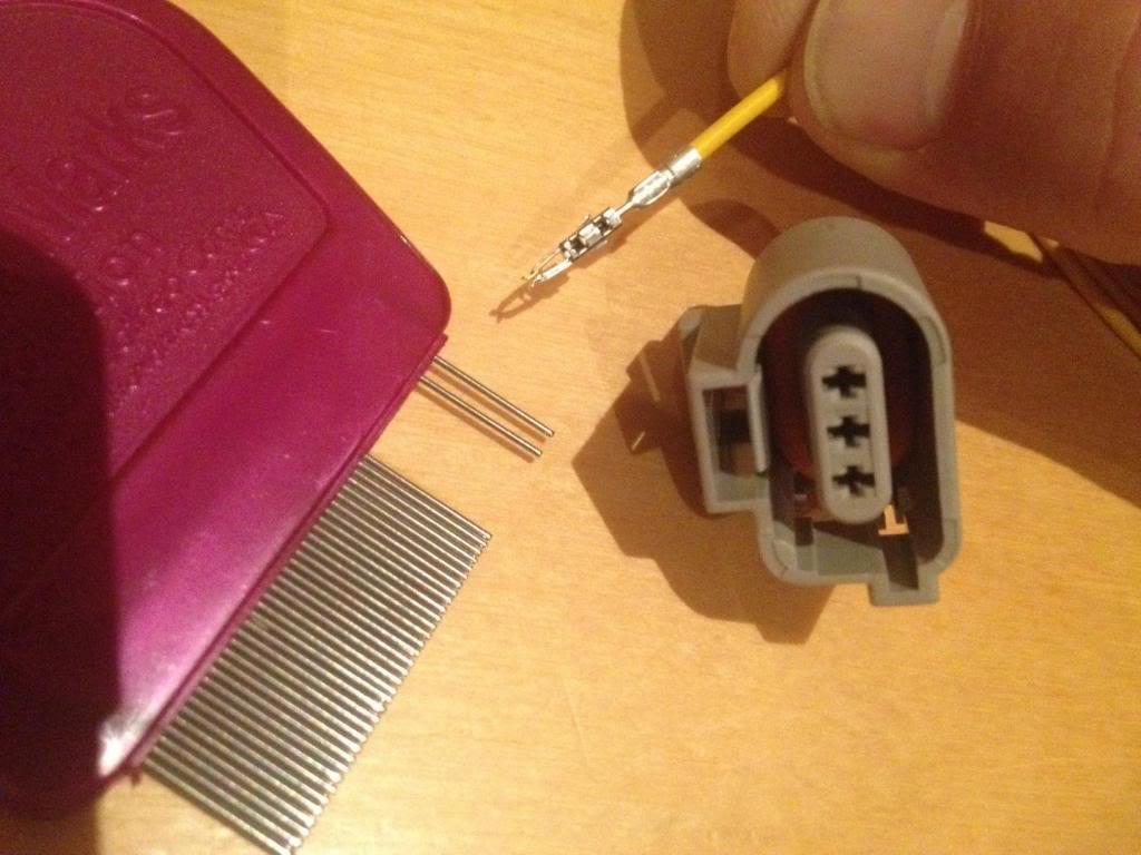

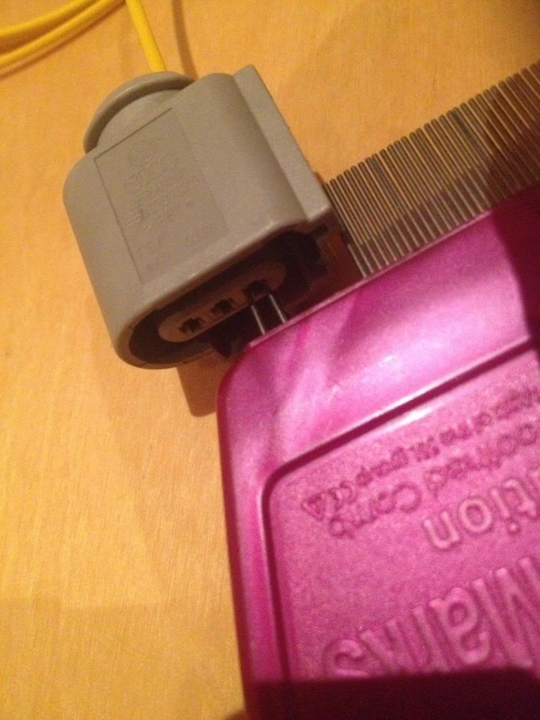

I managed to break the connector to my fuel pressure switch whilst I changed the fuel pump cam follower last week and not wanting to buy the bespoke tool to remove the wires from the connector I've come up with a cheap solution which works perfectly and is available on every High street in the country.
A nit comb!!
I've removed a few tines to the correct distance apart which allows the two remaining tines to slip down the sides of the connector releasing the crimped terminal end. I've removed the middle two from a block of four and will then remove a few more to allow free access to the centre terminal. The only thing to watch is if the tines pull out of the handle.
I have used a paper clip previously but this seems more reliable.

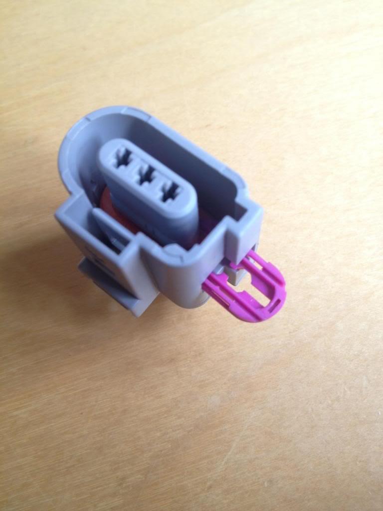

Plug - 3BO 973 703 G
Pic of old plug
Repair wires - 000 979 131 EA
Should be able to release the original loom wiring from the broken connector but if that proves difficult, the repair wires will slip straight into the new connector once the purple lock tab has been slid out.

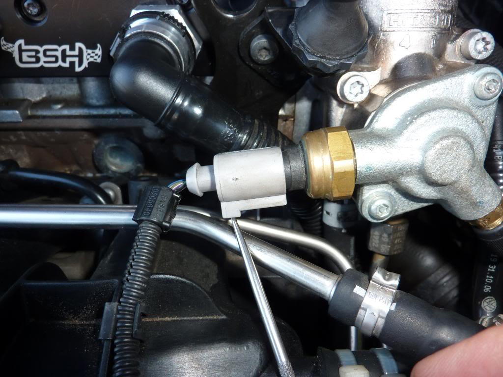

Cheers mate, just to confirm before I order. This is to plug in the top of the fuel pump?
This one:
Offline galaxie500

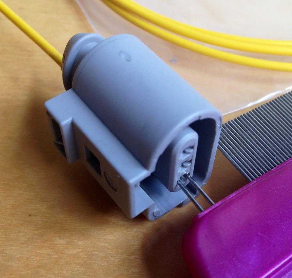

I put the wrong pic up of the 'tool' in use!
Here it is with the nit comb tines correctly positioned for terminal removal!

That's the one. Mine was spun 180 degrees round so the clip part easier to see. Even more stupid that I broke it!

The terminal release tool (Nit comb model) is only required to release the wires from the plug. The terminals just click into place once the purple Lock tab is removed. Repair wires are just in case a terminal breaks and can be used for a number of different plugs.

A little tension on the wire as the tool is inserted should ease it's passage out of the back of the plug.
