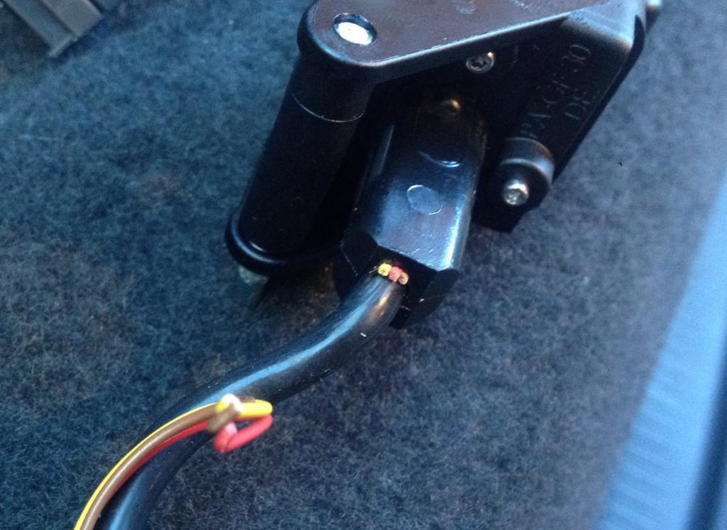

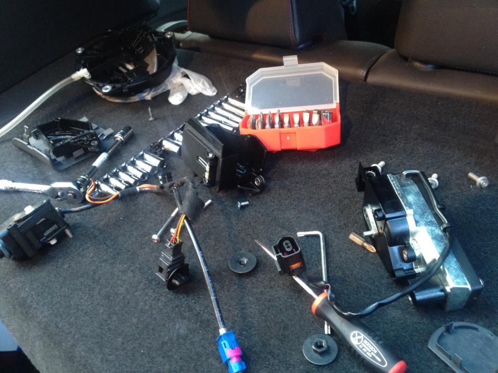

I fitted a MK6. RVC camera last year and the other week it just died on me so called Eddie-NL who told me it was probably the one of the small wires that go into the camera itself.
Took the badge apart -
Found that ALL three of the wires had snapped clean off!!!

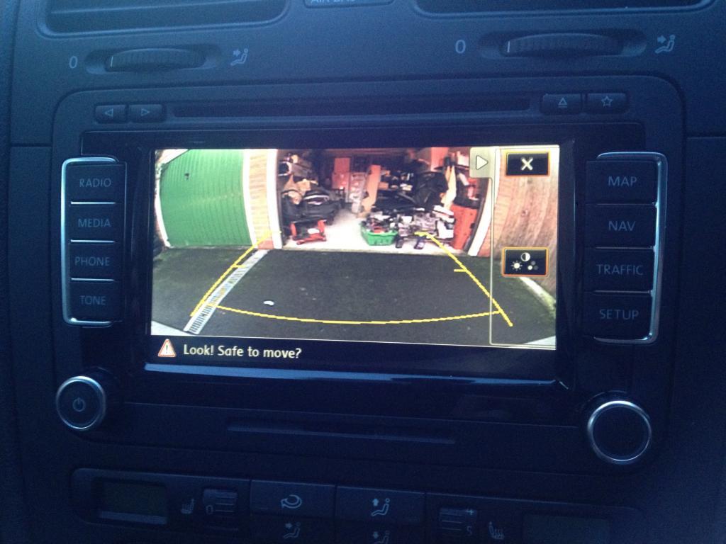

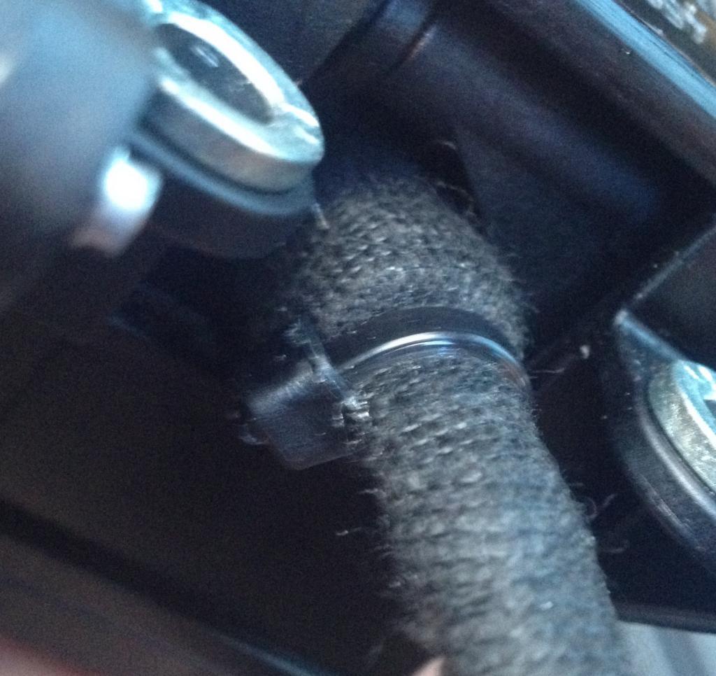

There was no way of repairing them and as luck would have it Eddie had a replacement camera in stock - paid for it yesterday and got it today.  In an effort to relieve some stress on the wires I covered the end in liquid rubber, taped it up and put a cable tie round the end.  The cable tie had to be positioned right cause it was fowling the mechanism first.
YAY!!!!! Its works again - amazing how dependant I became on the camera.  Really noticed not having it.  Big thanks to Eddie-NL who, as always, was really helpful in getting it working again  :happy2: :happy2: :happy2: :happy2: :happy2:

Nice job, glad it is sorted
never seen all three broken before, poor design from VW
Not what I'd expect from VW, especially when you consider the size of the coaxial(?) cable. Thanks again for the assist  :drinking:

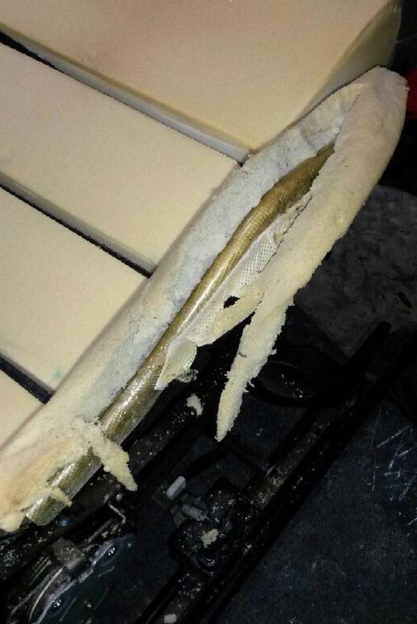

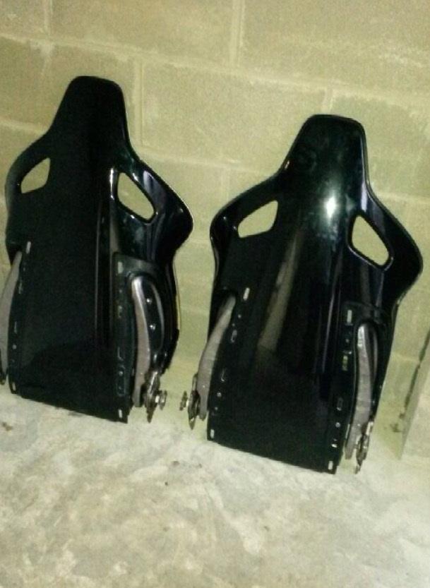

Update from Del @ Optimus Trimmers
Seats backs off ready for paint...
Drivers bolster a little more knackered than first thought so he is going to swap passenger and drivers base and repair this one
He has got the leather and the embossing stamp is being made up - just waiting for a sample then it'll be full speed ahead  :happy2:
