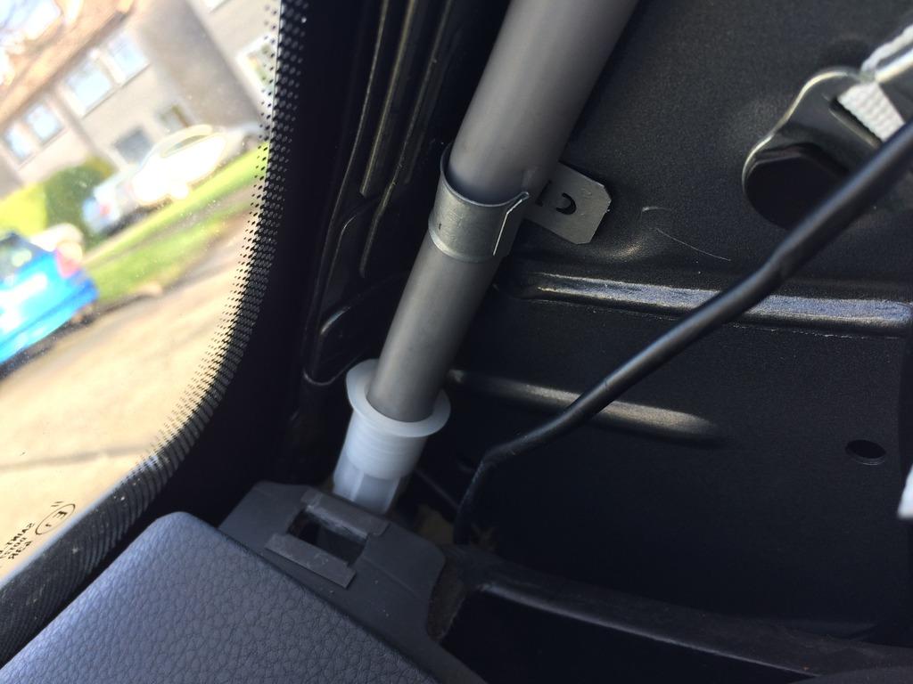

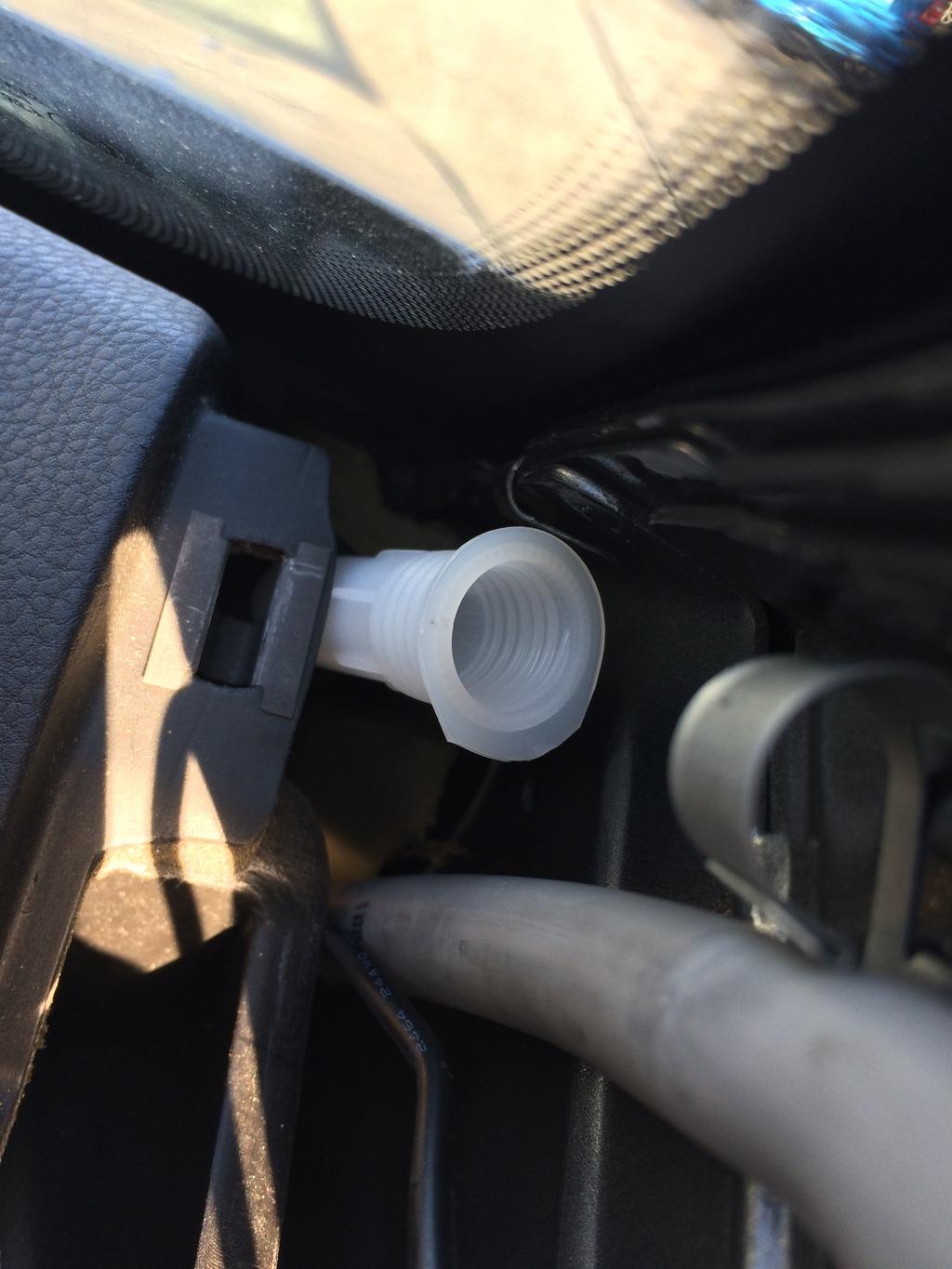

Drainage pipe is a pain.
I think there's just the one in the front driver side corner. It follows through a small pipe down the driver side A pillar and out the engine bay eventually spilling out near the front.
They can become unhooked and will flood the car. Happened to me so I had to make an extension piece.
Personally I wouldn't be removing all the trim to clean out the drainage hole unless a leak appeared. You can clean the inlet to the drain at the sunroof area though.

Many thanks Luke, any chance of a picture?

I would be keen to see a pic of where the drainage hole is, as I can't find it!

These are photos of the A pillar removed and the cone shaped attachment (tec-7 top) I used to channel the water from the hose into the outlet pipe.
