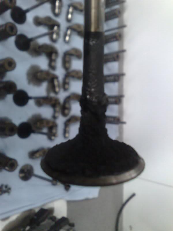

heres jonnyc S3 8P (still the 2.0 TFSI) intake valve from a stripdown at xx,xxx miles :
jonnyc's S3 stripped
why ?
heres a useful diagram.
The key thing to remember is that the TFSI doesnt have a catch can (but everything else is relevant) , and oil fumes / water vapour and related gumph are ported back into the engine to try and achieve good emissions...
On most cars this is not a problem as fuel washes constantly keeping everything clean.
The bad news is that TFSI is direct fuel injection (injectors spray directly into the combustion chamber), so the only thing passing the intake valves is air (and the oil and water vapour gunk), this is really bad news.
(thanks Robin  :wink:)
this happens to both standard or remapped cars, but the increased boost pressure is liable to make the issue worse.
