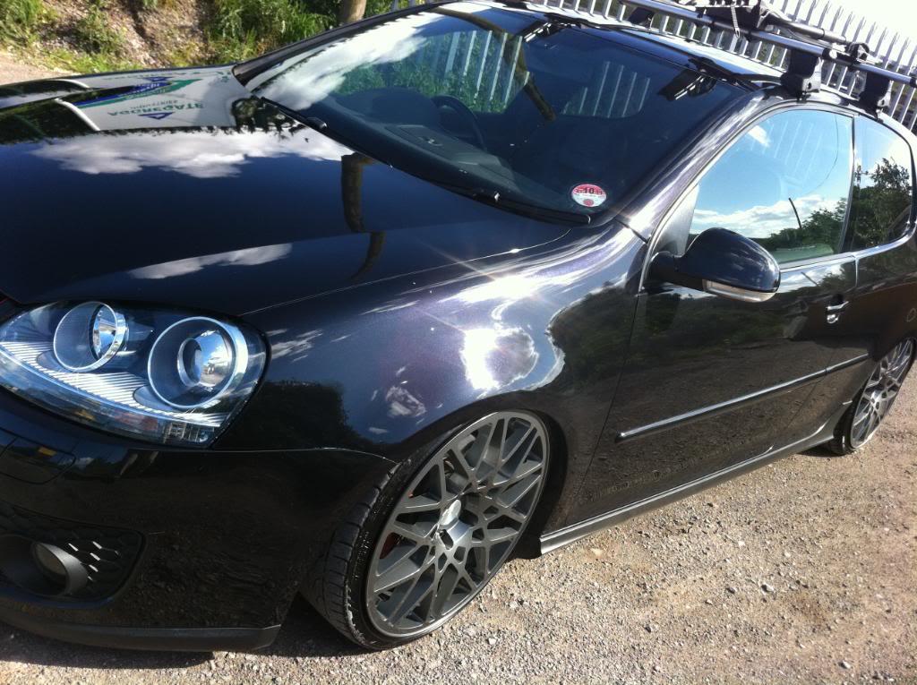

hi everyone,im Craig and id like to introduce myself and my car. ive owned the car for around 3 1/2yrs now and its seen many different guises as in the title but heres a few pics to give you an idea but sadly ive lost the pictures of it as a standard car so ill strat with my earliest
this is before edition 38 3yrs ago.

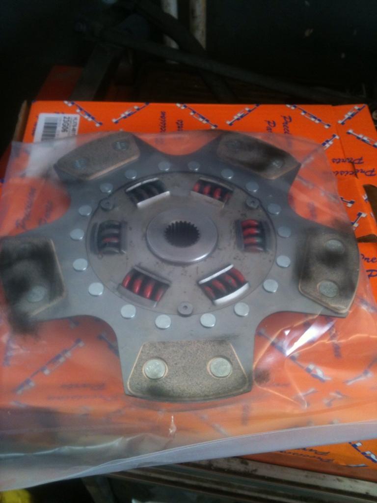

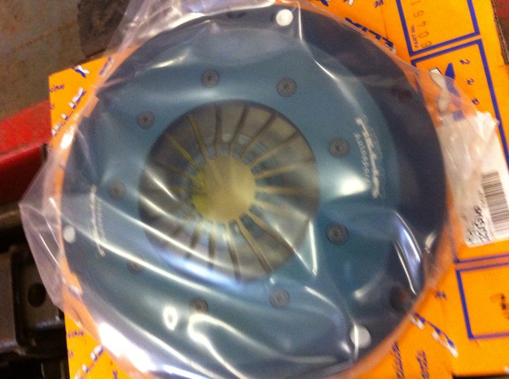

Now with a forged motor in the pipe line with an excess of 500bhp I then decided 2wd isn't good enough so I began to get the 4wd running gear.

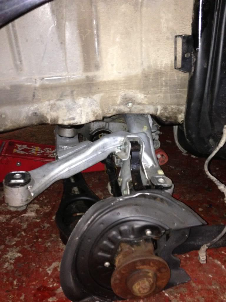

Now for the read end to accommodate the rear diff but first I needed to remove a few obstructions
And I'm left with this
Finally I can start to alter the rear
Solid plate welded in with strengthening box section underneath
Now to chop out for the secondary in tank fuel pump
Now all the fabrication and altering is done I can now start to build it back, new Quattro fuel tank with s3 in tank pumps
Before I could install the tank I needed to alter the o/s/f rear brake line as its routed different via the rear axle
Quattro tank in
Rear diff ready to go in.
Rear diff in
No I needed to build the axle by installing my brakes and shocks
I've thinned the pics down so you get the general idea but my aim is to make a 4wd 500bhp gti and hopefully I'll have the car fully built and starting the running in process within the next 6 weeks but ill keep this updated. Thanks for reading
