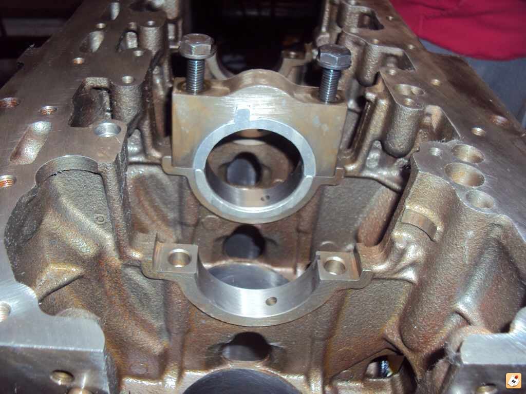

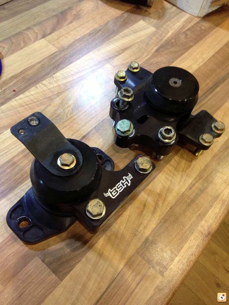

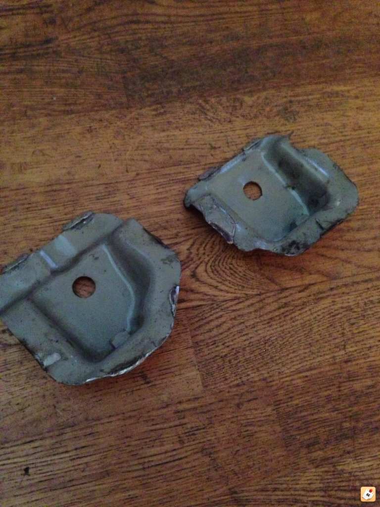

Hi guys, left this alone for a while due to work commitments but I've managed to plod and get some bum it's done, here's my work
Managed to source some 2nd hand centre bearing mounts
Also picked up some r32 rears
Also got myself some bsh engine and gear box mounts

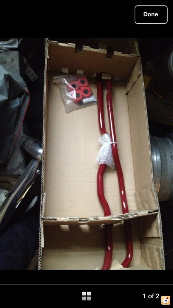

Also picked up some brand new r32 arb's at a steal of a price

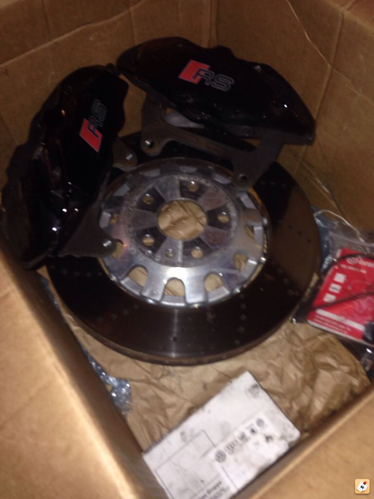

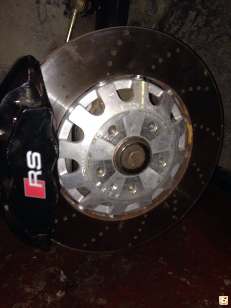

Also got hold of a full ttrs front brake set up too

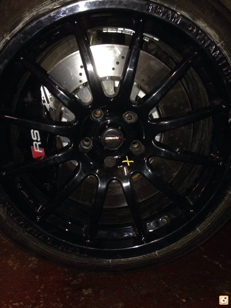

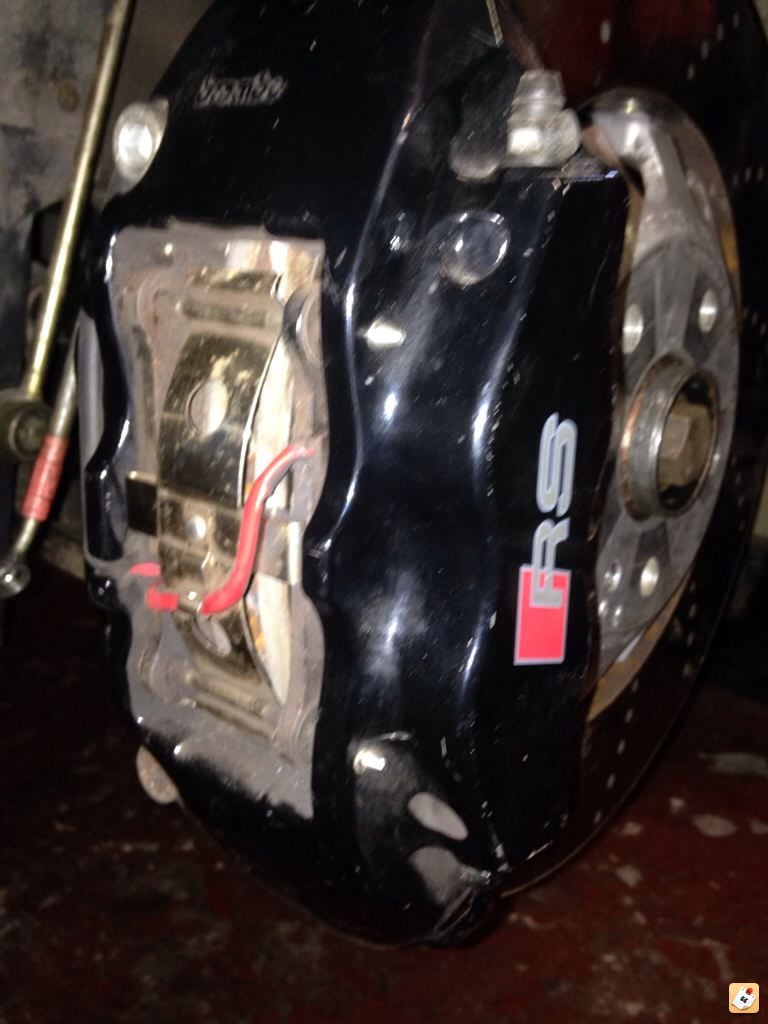

Ttrs brakes trial fitted

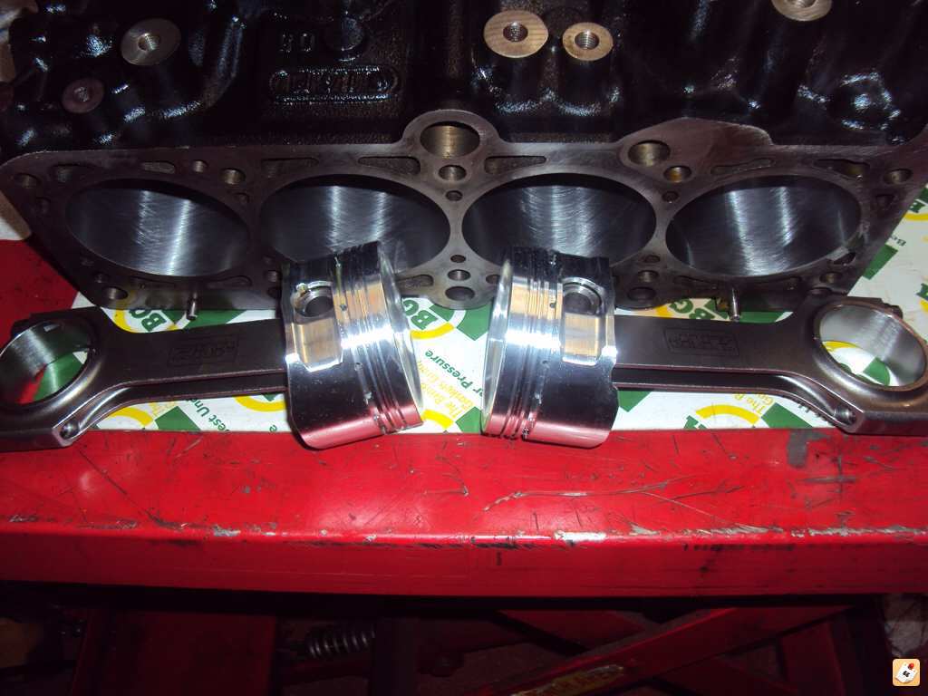

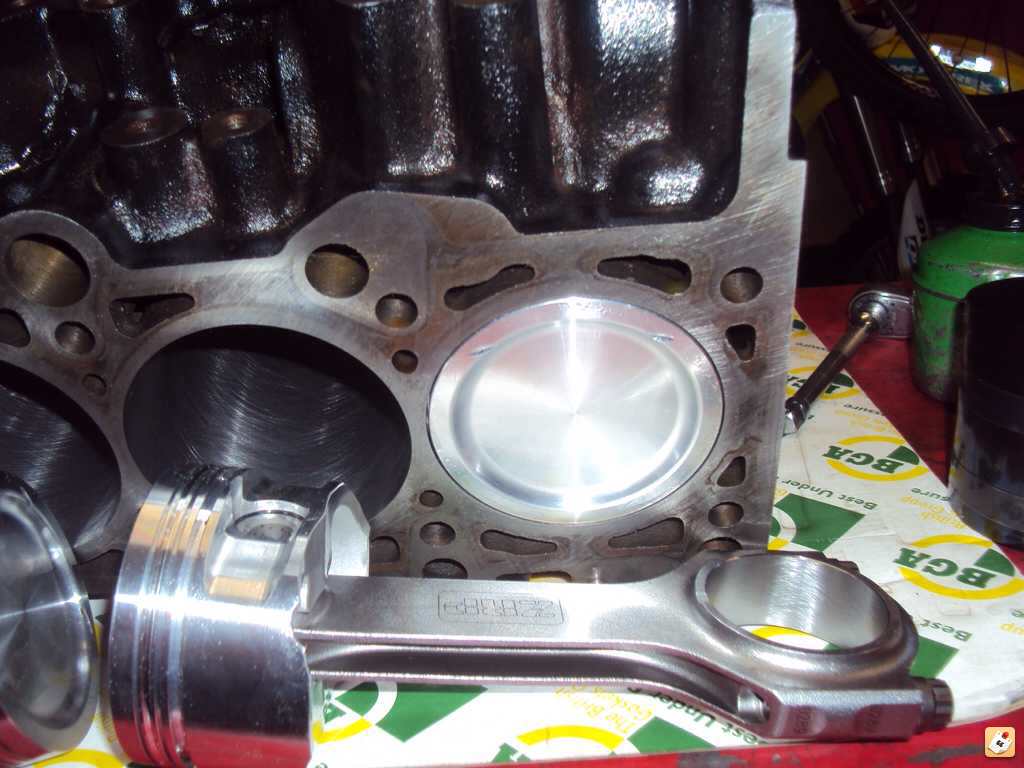

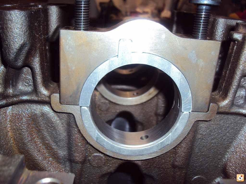

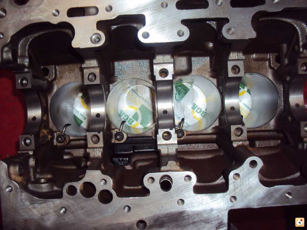

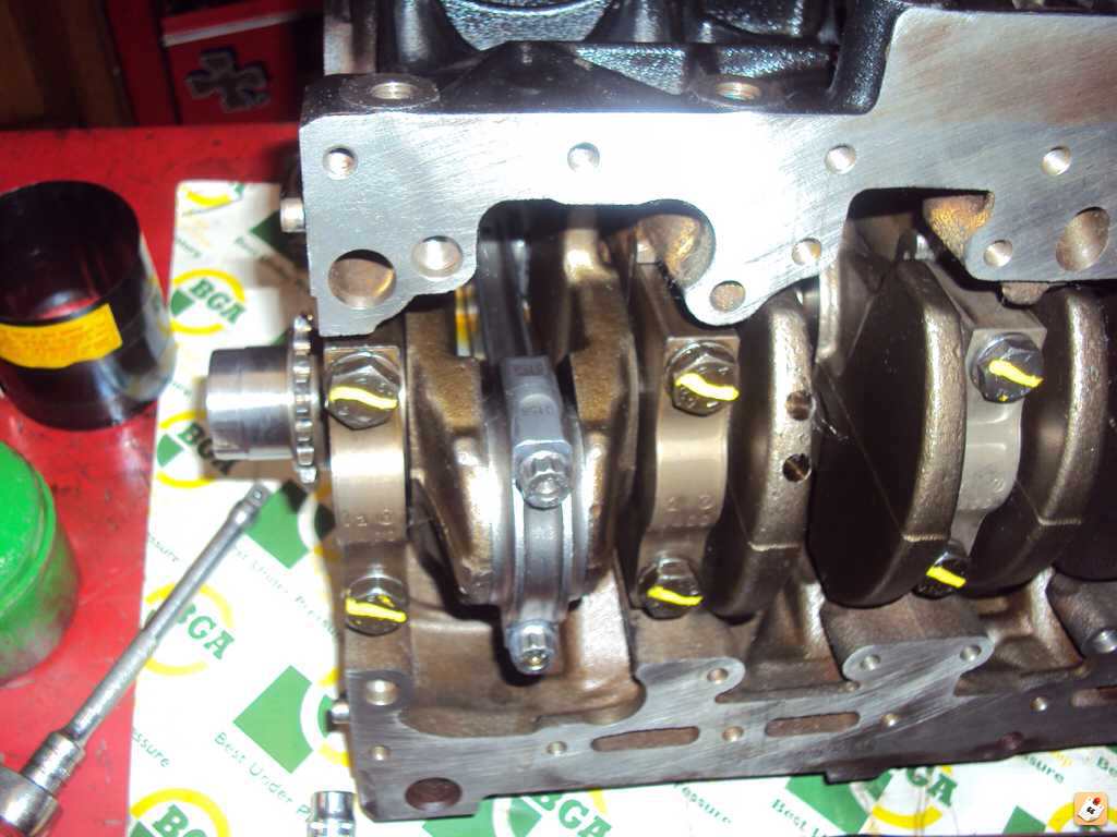

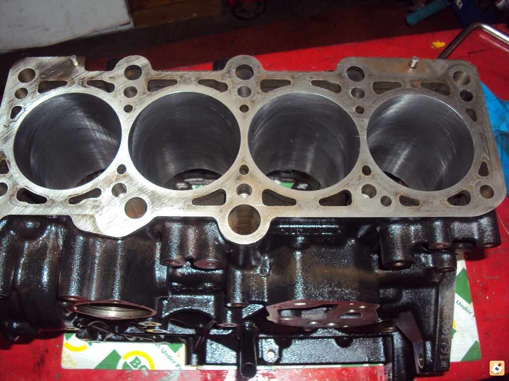

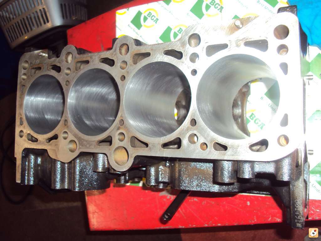

Here is what pictures I managed to get of the engine being rebuilt
This is after being overbored by 0.5mm
Sent from my iPhone using Tapatalk - now Free

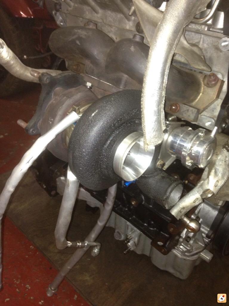

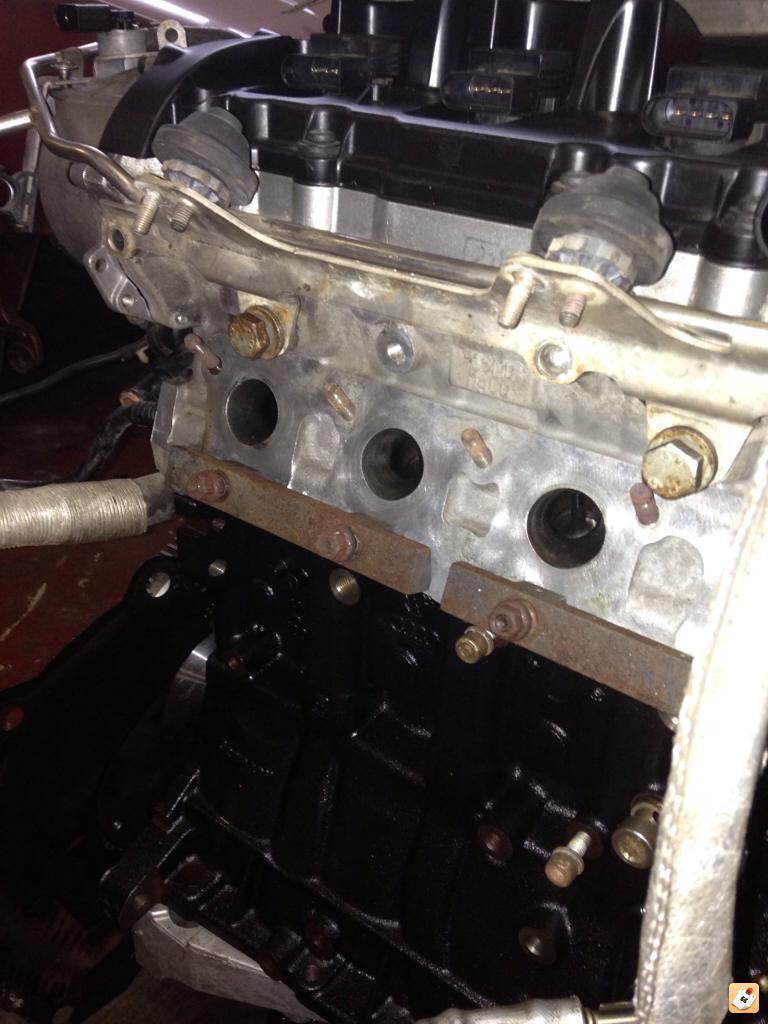

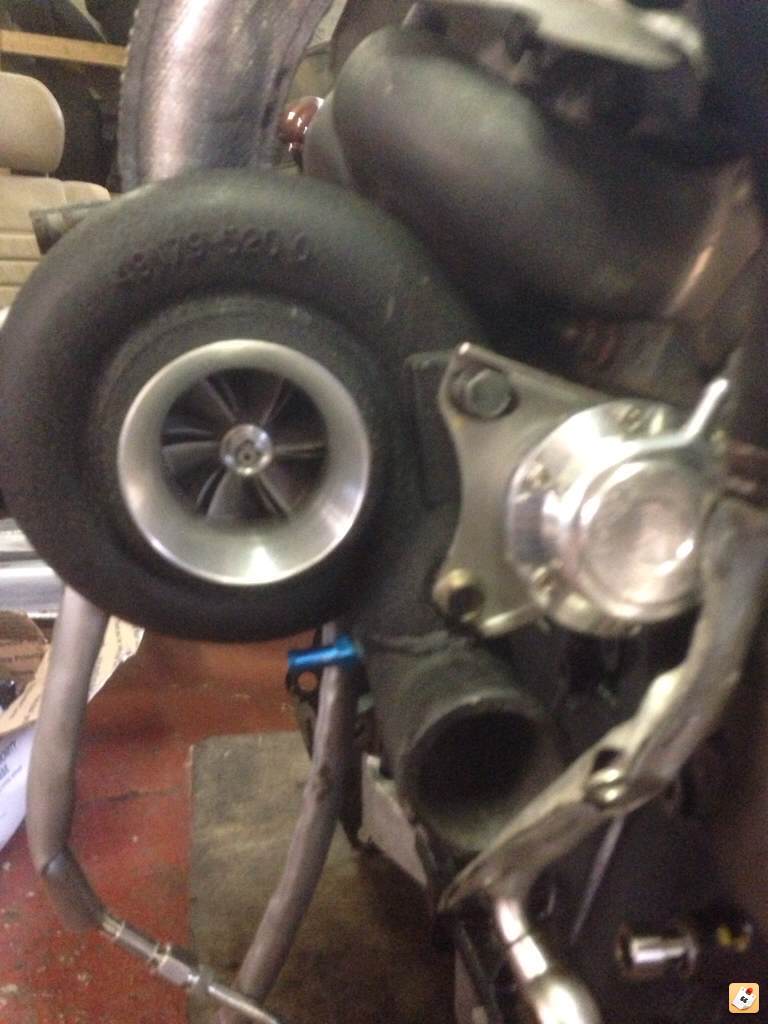

After receiving the engine I got to work bolts in the turbo and inlet on

HCP BM3 M5 800BHP
Offline tony_danza
  • -Receive: 112
  • Posts: 3013
Re: mk5 gti - from scene queen to mean
« Reply #53 on: October 15, 2013, 08:52:36 pm »
Wonderful, I do like a different build.
I think your brakes are a backwards step, the VWR ones, particularly the Project Mu versions you have are faaaar superior. Performance wise, maybe not 'scene' wise.

« Reply #54 on: October 15, 2013, 09:08:28 pm »
yeah how come your changed the vwr brakes for tt ones?

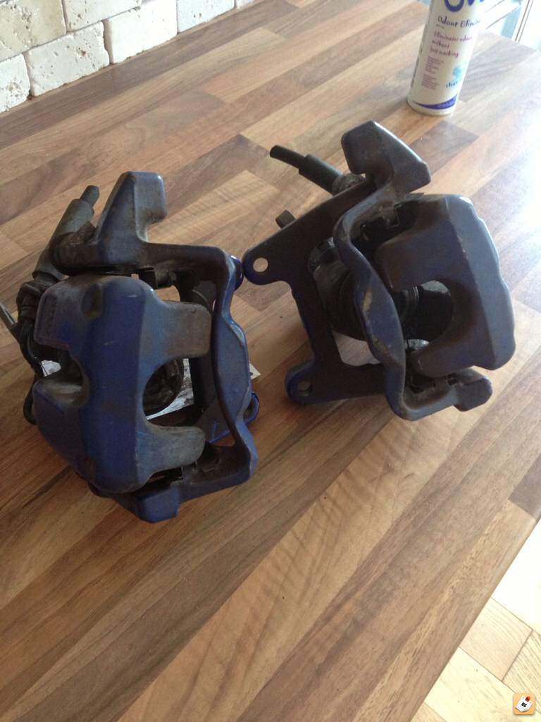

I took the vwr ones off as they kept warping discs and they had uneven pad wear too so I decided to split them to service them and I assumed they were ap but they weren't, I asked a vwr but they didn't help much so I the researched a company called ap Caparo and they were very helpful but the seal kit they sent wasn't for these so I got sick of chasing around for them so I chose the ttrs as they are lighter, have bigger braking area and generally were a quick fix as I didn't have anything to loose.
