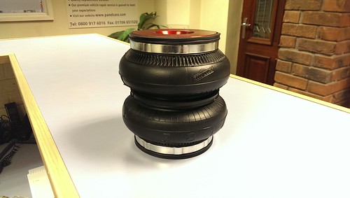

bags and valves cleaned up.
need some new top nuts for the valves just to make them look nice, then on monday rear bags and rebuild kit will be ordered

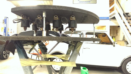

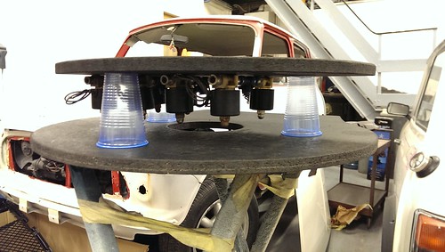

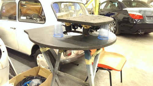

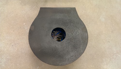

so with that little lot ordered i built the housing part of it
heres the main base and how it will sit in the wheel well
IMAG0843 by cuprajake1, on Flickr
IMAG0845 by cuprajake1, on Flickr

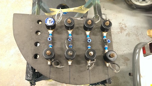

after that i made a mount for the valves
IMAG0851 by cuprajake1, on Flickr
this will sit on top with the valves underneath hidden away with only the four shreader valves sticking up, the whole thing will be covered in grey carpet
IMAG0855 by cuprajake1, on Flickr
IMAG0854 by cuprajake1, on Flickr
the plan is to have the tank at the back next to the rear panel, then the compressor on the right hand side
jake
Tornado red ed30 #0728

Those valves look similar to the ones I used when I started my build on the corsa. They didn't seem to work for me unfortunately. They kept sticking shut and even after taking them apart they still wouldn't work. Hopefully you have better luck than me mate :)

Time will tell
I used similar ones in the past with good results. So hopefully there ok.

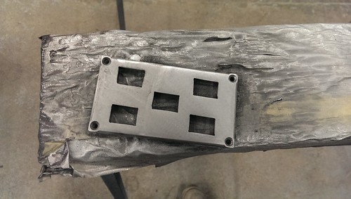

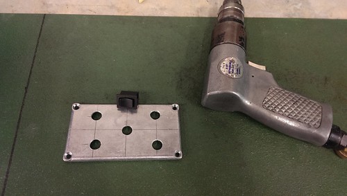

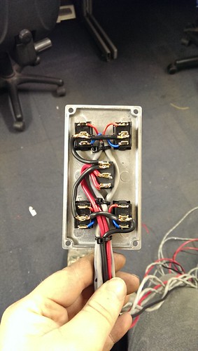

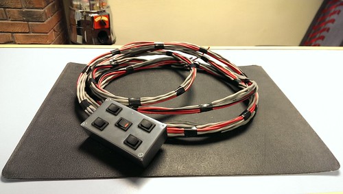

then made a switch box,

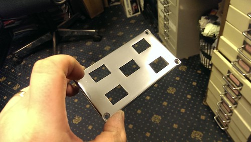

i bought an ali case and some switches, along with wire,
marked and drilled
IMAG0858 by cuprajake1, on Flickr
holes cut
IMAG0860 by cuprajake1, on Flickr
polished
IMAG0862 by cuprajake1, on Flickr

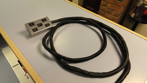

and built up
IMAG0876 by cuprajake1, on Flickr
IMAG0877 by cuprajake1, on Flickr

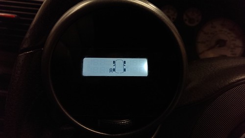

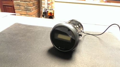

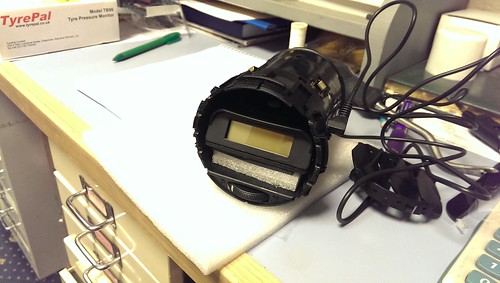

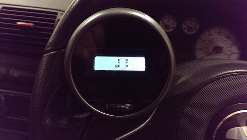

after that i set about my digital display, i stumbled upon a system called tyrepal, its a wireless tyre pressure system works over 100psi with a funky display
IMAG0881 by cuprajake1, on Flickr
its going in the side vent
clear front added
IMAG0887 by cuprajake1, on Flickr
done
IMAG0885 by cuprajake1, on Flickr
IMAG0882 by cuprajake1, on Flickr

You could have bought an AVS switch box that looks like yours :P cracking effort though, it looks amazing so far mate. Going to definitely follow this build.

The avs one didn't cost £10 lol. But you are right. Everything has to be imported so it's got $70 shipping on it right away.

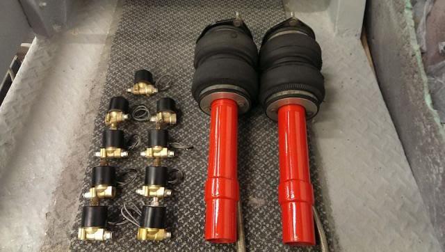

box of goodies turned up today
IMAG0903 by cuprajake1, on Flickr

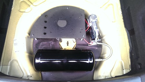

rear bags, comp and tank
mocked up how it will sit in the boot
IMAG0891 by cuprajake1, on Flickr
then added my outer case to the cntrol unit wires
IMAG0899 by cuprajake1, on Flickr
still waiting on the pressure switch and the rebuild kit,
ive also wired the valves up, and then ran a bit of the pipe to the valves with tee's getting ready
im going to try and get the boot set up ready to bench test for leaks as soon as the compressor comes
