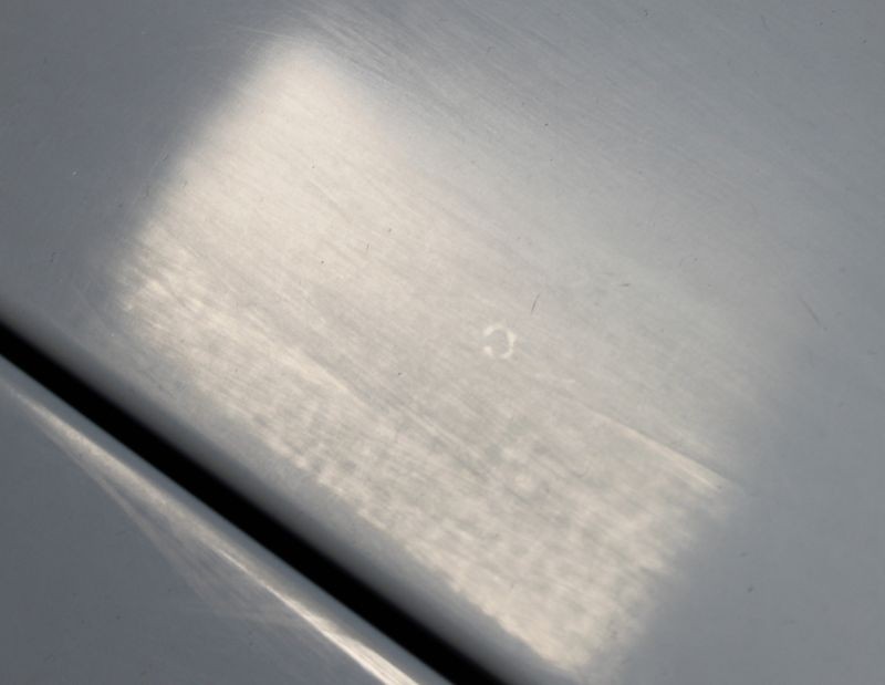

Here are some heavy swirl marks
This is caused by years of very poor washing techniques, sponges and chamois, water blades, dirty cloths, etc

Firstly you need to be able to inspect your paint so the best tool for this is a SUN GUN.
This can be a really bright torch, phone light, whatever. However you need something really bright.
Phone lines are only really good on really dark cars and you get a very narrow angle of viewing (as the light power is quite weak)
The best thing for the money is what's called a Brinkmann Dual Xenon which is what I have.
It is a rechargable flashlight where you can adjust whether there is one or two bulbs. It charges up from a US socket (adaptor) or from your cigarette lighter which if you're a traveling detailer or valeter it can be charged while you're driving about.
This is to help you spot the swirls to begin with. This is very important both from a "diagnoses" point of view, that being you are assesing how bad the paintwork is and also when you are in the process of actually correcting the paint, an easy way to verify your progress and ensure you're actually getting the results you want.
Swirls are based on seeing fine imperfections in the paint at many angles. Therefore a stronger light is good so you can move around and see more clearly. It's possible for example, that you may remove a scratch when you look at it from one angle but when you look at it from another it's there clear as day. This is where a sungun and/or strong light source help you. Being handheld it's easy to move about and get a much better view as well.

I did not know you should apply wax in straight lines...... bugger!
You don't HAVE to it doesn't change anything.
Just that straight line scratches are much easier to remove , and much harder to see, than circular scratches.  :happy2:

Machine polisher work in circles  :grin:
Tornado red ed30 #0728
Offline xjay1337
  • -Receive: 377
  • Posts: 4916
Re: Jay's detailing Guide ^_^
« Reply #13 on: November 06, 2013, 09:47:40 am »
Yes they do, by removing layers of paint. They work in a fixed pattern (as in constantly rotating about a given point at a given speed). A small amount of dirt will normally be broken down by the pad/polish/machine - No ill effect will be had.
Using your own hand will result in RANDOM patterns.. By hand you can't get that sort of power. more likely to cause marring.
Using circular motions on the panel when washing/drying/applying waxes, means if you are going to put swirls and scratches in, rather than being straight line scratches, which are only visible from certain angles in certain light, you are going to put circular scratches and swirls in, which are visible from most angles and most lights. Basic rules of light  :happy2:
