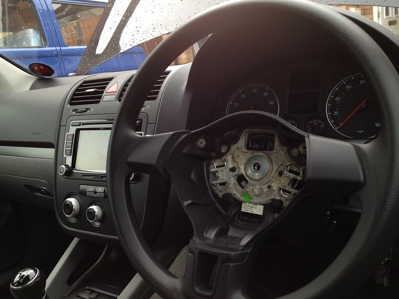

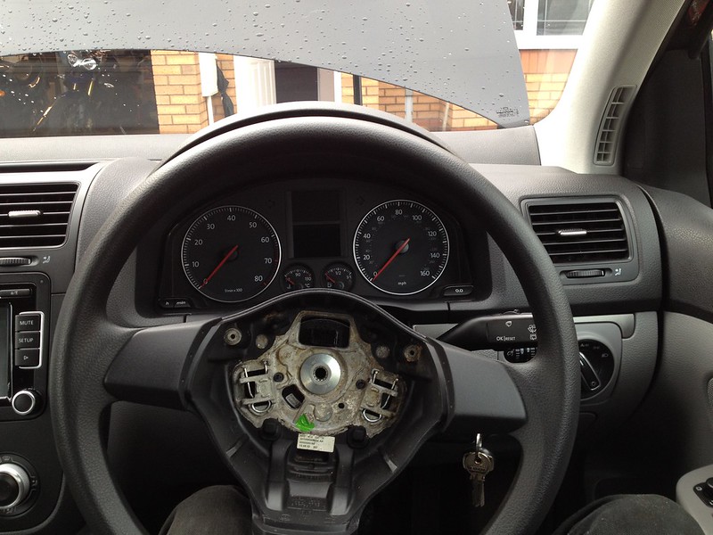

Don't know if anyone is interested in this, but I got my wheel and test fitted it.
Just waiting on the airbag now, and I can put it in properly. :smiley:

I trust you have ordered the proper airbag, an easy mistake to get the wrong one with so many different versions

What do you mean different versions? My plan was to get a polo 6R airbag and horn push and splice the mk5 connector onto the polo loom

the loom will work ok, but will need a bit of modifying to get the horn to work.
look at your wheel and see how the airbag clips in
and compare it with this one
http://www.ebay.co.uk/itm/VW-Golf-flat-bottom-GTI-steering-wheel-with-DSG-/121212560002?pt=UK_CarsParts_Vehicles_CarParts_SM&hash=item1c38d4e282#ht_583wt_1170
your wheel and the one above uses an airbag type like this
http://www.ebay.co.uk/itm/VOLKSWAGEN-GOLF-6-MK6-PASSAT-CC-SCIROCCO-GENUINE-DRIVER-AIRBAG-5K0880201-/190970050934?pt=UK_CarsParts_Vehicles_CarParts_SM&hash=item2c76b3b976#ht_2621wt_932
(although the one above won't fit your wheel)

Okay, so the difference being that is a GTI wheel, but a non-GTI airbag?
Sorry if I'm not getting it :signLOL:
Also, what sort of modifications will I have to do to get the horn working?
Thanks for your help :smiley:
'87 MK1 Cabby - To be 20vT'd.
MK5 Daily.
Instagram - woahnowboys
Offline Eddie-NL
  • Trader - 2014
  • -Receive: 298
  • Posts: 2639
Re: Fitting a 6R (MK8) Polo steering wheel into a MK5?
« Reply #10 on: November 20, 2013, 12:23:42 am »
If you look at the GTi wheel there are 2 lugs
Look at the airbag and on the base that clips into the steering wheel there are 2x metal loops that clip on to the lugs
Compare that with your wheel which has 2 spring type clips (also lower than the lugs)
The airbag cover is correct for both the GTi wheel and your wheel, but the base is different
Hope you understand as I can't explain it any better

Okay, I think I've got you haha, I just need to make sure I get a picture of the back of the airbag, so I can see if the fittings line up and are the same type of fitting?

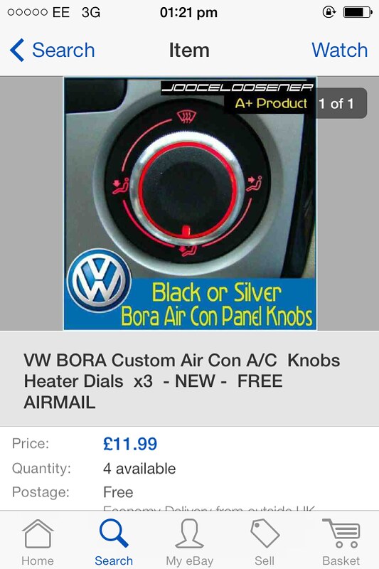

Altogether ended up costing about £200
I think it'll look awesome with the horn push :jumping:
PM me with what heater contols you have please mate
Can you share with everyone what heater controls these are? eBay?
Offline woahnowboys
  • Posts: 308
« Reply #14 on: November 20, 2013, 01:32:42 pm »
Of course.
I don't have access to a computer right now, so a phone screenshot will have to do. I'll edit this and add a link when I get in.
Should be easy enough to find from this though :smiley:
It's a MK4 set, the ones I bought are no longer listed :confused:
Don't quote me on this, from what I've read online, they are the same.. Probably worth looking into this though, I haven't found much info.
