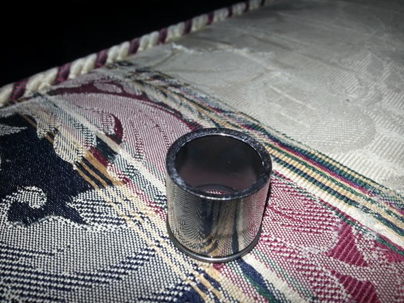

So I've got a 2005 GTI (95k on the clock) and was/am? suffering from the following problems:
1. Lack of power above 3000rpm (only just noticeable)
2. Occasionally went into limp mode when thrashing it - particularly on the motorway
3. When left for a couple of days, takes a lot of cranking to start the engine
4. P2293 - Fuel Pressure Regulator 2 Performance when code reader used on ECU
After a bit of googling it seemed that all or a mix of the problems above point towards low fuel pressure caused by a worn cam follower (reducing stroke on the HPFP).

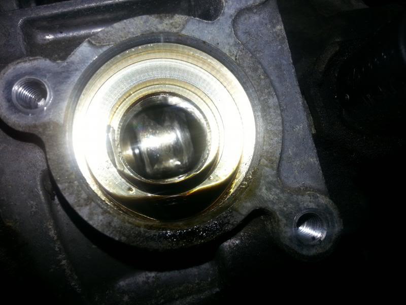

So I bought a new one and fitted it today, the picture below shows how my old cam follower was completely worn through, which was causing the fuel pump plunger to rub directly on the cam shaft. You can see in the cam shaft photo that it is pretty ruined, there is a V shaped groove in the cam caused by the fuel pump plunger.
So fitting the new cam follower has increased the stroke and therefore upped the fuel pressure at the pump, which seems to have "fixed" it, although I'm left wondering how quickly the cam and cam follower are going to eat each other now that there is worn surfaces?
Anyone have any experience of this?

ouch. The cam follower looks like it has not only failed but eaten itself!
Can't really see how bad the cam lobe has worn but going how badly the cam follower has worn I would think you'll be needing a new cam pretty soon.

Do NOT drive the car until you have the camshaft changed.  The worn cam will eat straight through the new follower, and it sounds like the fuel pump will need replacing too.
Would do an oil change too as all the bits of the follower, cam, and fuel pump are now floating around the engine.  Needs the sump removing and cleaning out too.
Keep using it and you will have a much bigger bill.

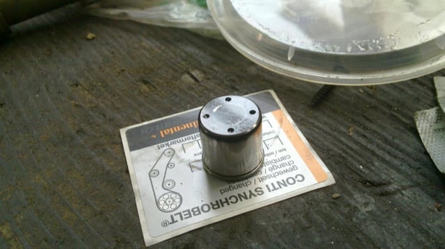

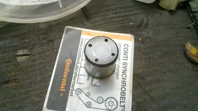

This is a replaced cam follower after 30km!! The previous one was worn through

Where did the worn bits go?
