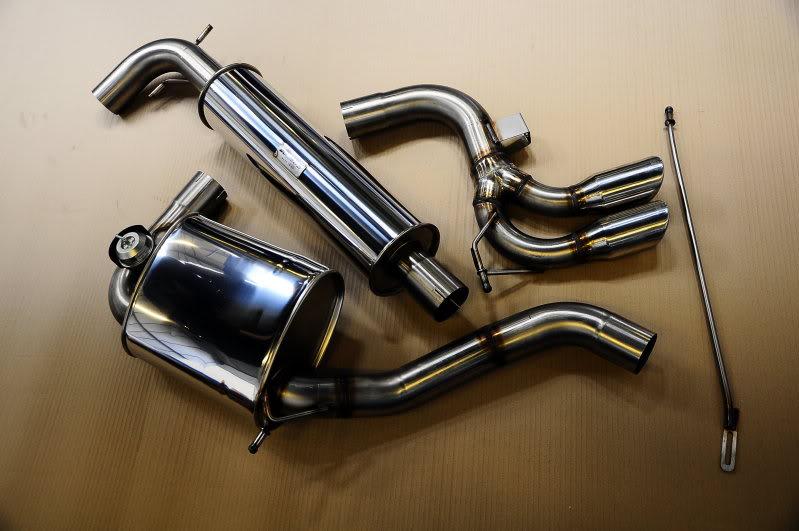

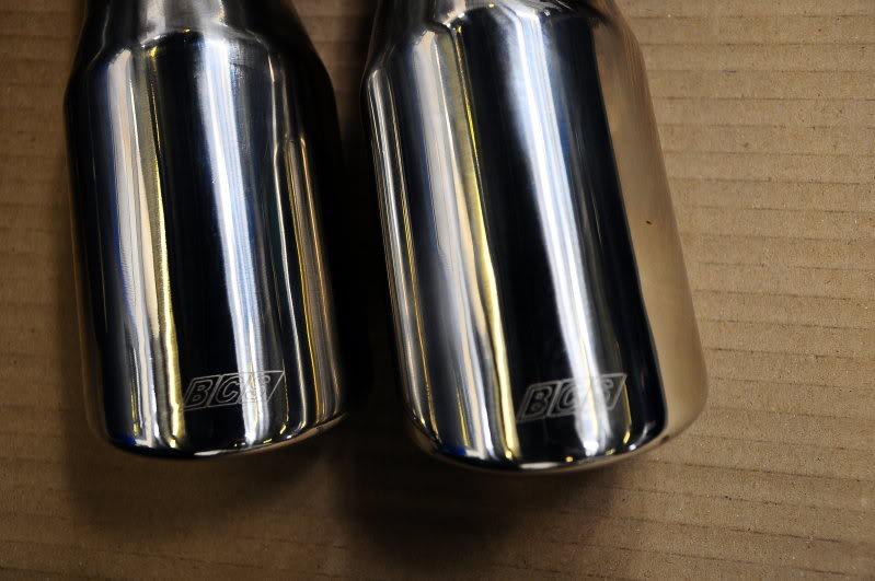

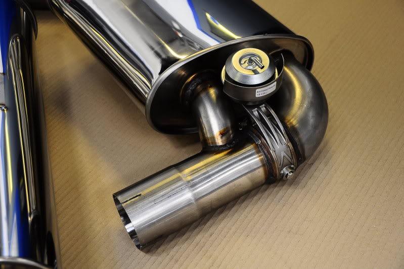

BCS Powervalve
I started off by replacing the standard exhaust system with a BCS Sport Powervalve 200 Cell Sports Cat TBE system with 80mm rolled tips. It's a real piece of art to look at and (for those who know what they're looking at) its an incredibly well made system. As well as being nice and quite, dare I say OEM quite, while pottering around town (albeit with a slightly deeper burble) the BCS Powervalve sounds awesome on WOT, with the boost activated valve opening, all hell's let lose and a truly addictive soundtrack is forth coming (well for a little 2.0T FSI anyway).
I don't have any pictures of my BCS Powervalve system before it was fitted so I'm nicking a pic from Tamiyoman showing the BCS system that was on his old car, it's the same TBE as mine and also a link below to his review. A "tap off" kit is needed to get the valve to operate as its boost operated. I have the fitting kit from Forge (also a pic and a link below).
~~ Clicky here ~~
......and a link below to the BCS Powervalve website....
~~ Clicky here ~~

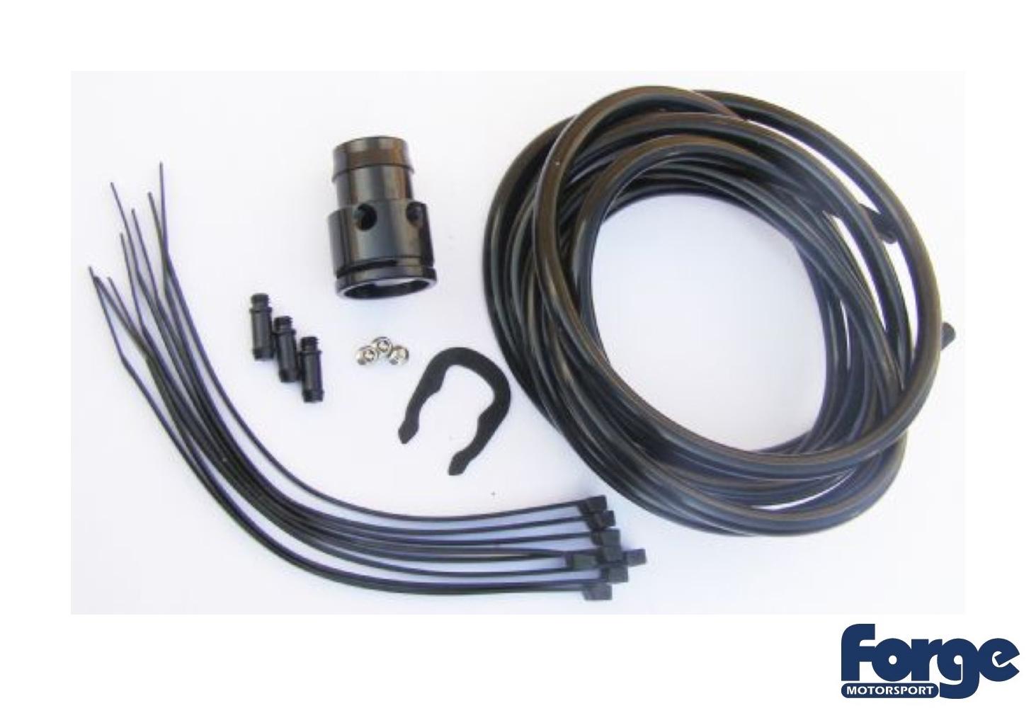

Forge Boost Fitting kit....

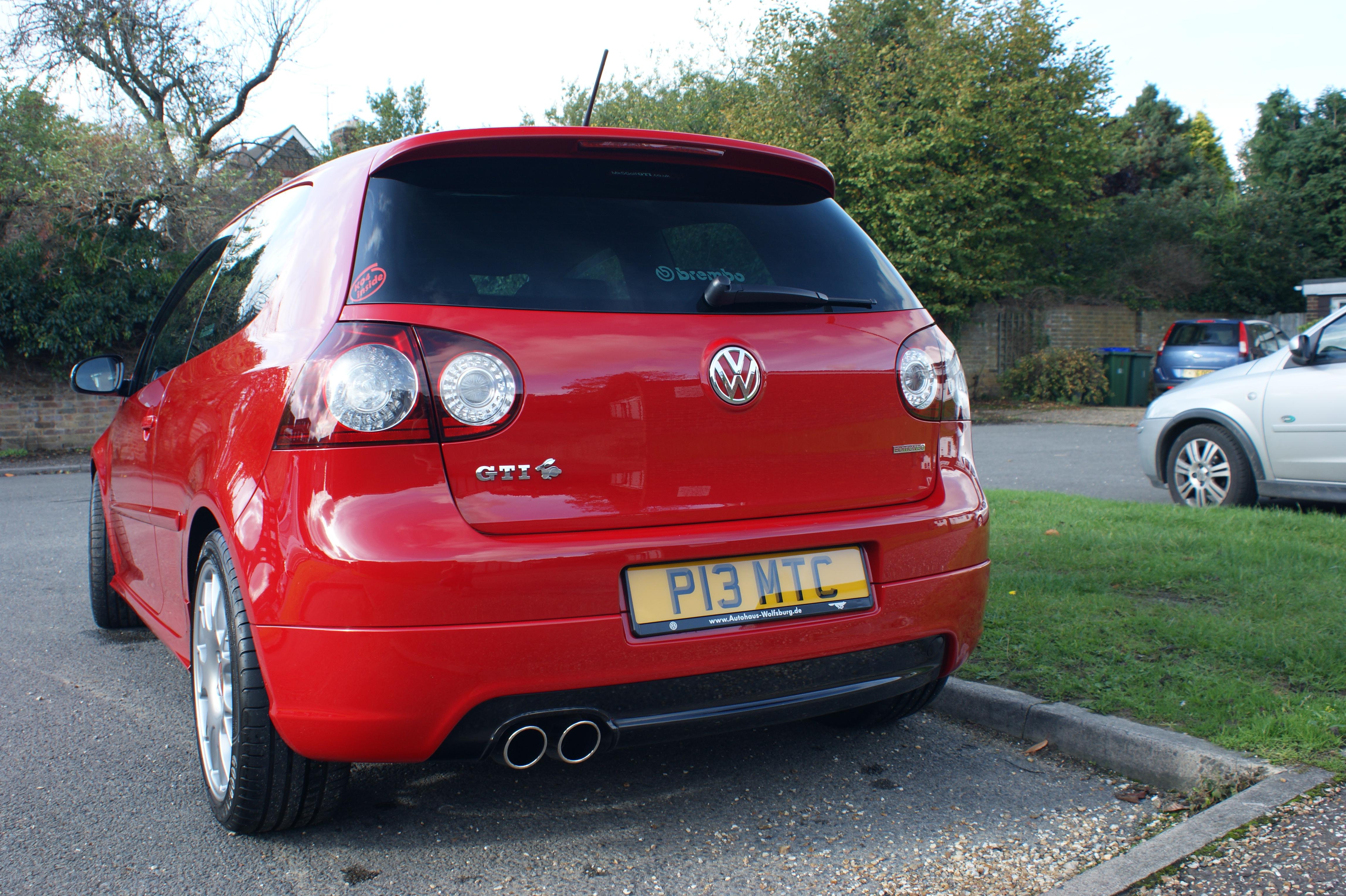

Zorst in place...
Next, bit of Whooosshh disssssssh was needed....

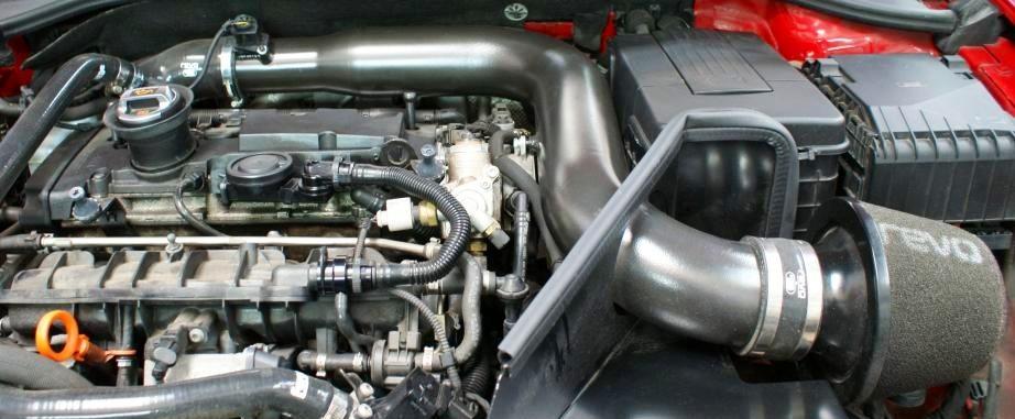

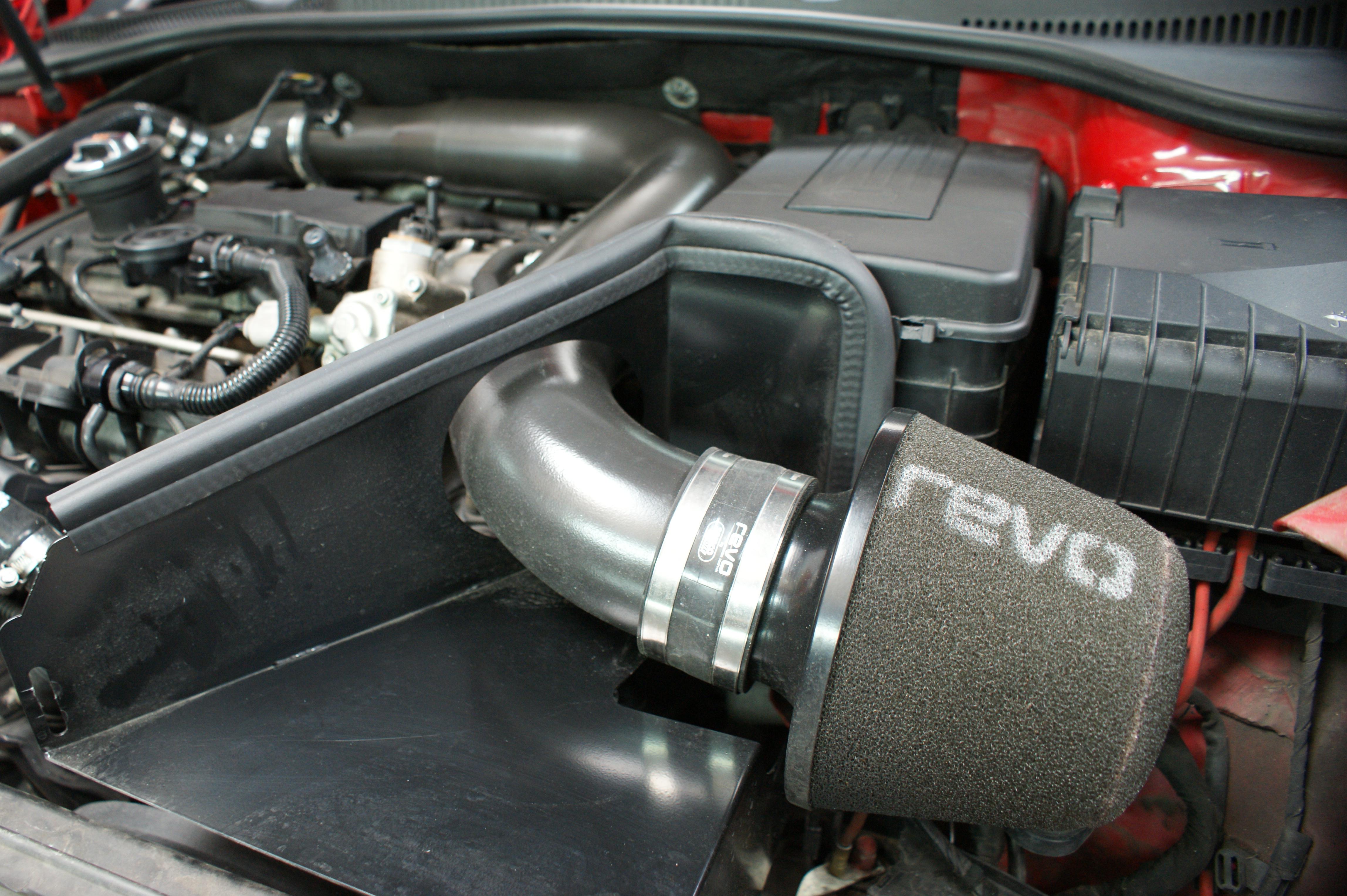

REVO
After trying a couple of Cold Air Intakes (an ITG Maxogen and an EVOMS), then retuning to the standard OEM engine cover and Pipercross panel filter for a while due to my dislike of the noise of the CAI's that I had owned I decided on the REVO Intake after a fair few recommendations. I had one supplied and fitted at AKStuning.
The whoooshh diisssssssssh noise of the REVO intake isn't overly load in the cabin and IMO is less aggressive sounding than my previous ITG Maxogen, so no longer living with Darth Vader.
A link below to the REVO website and relevant info on the Intake....
~~ Clicky here ~~

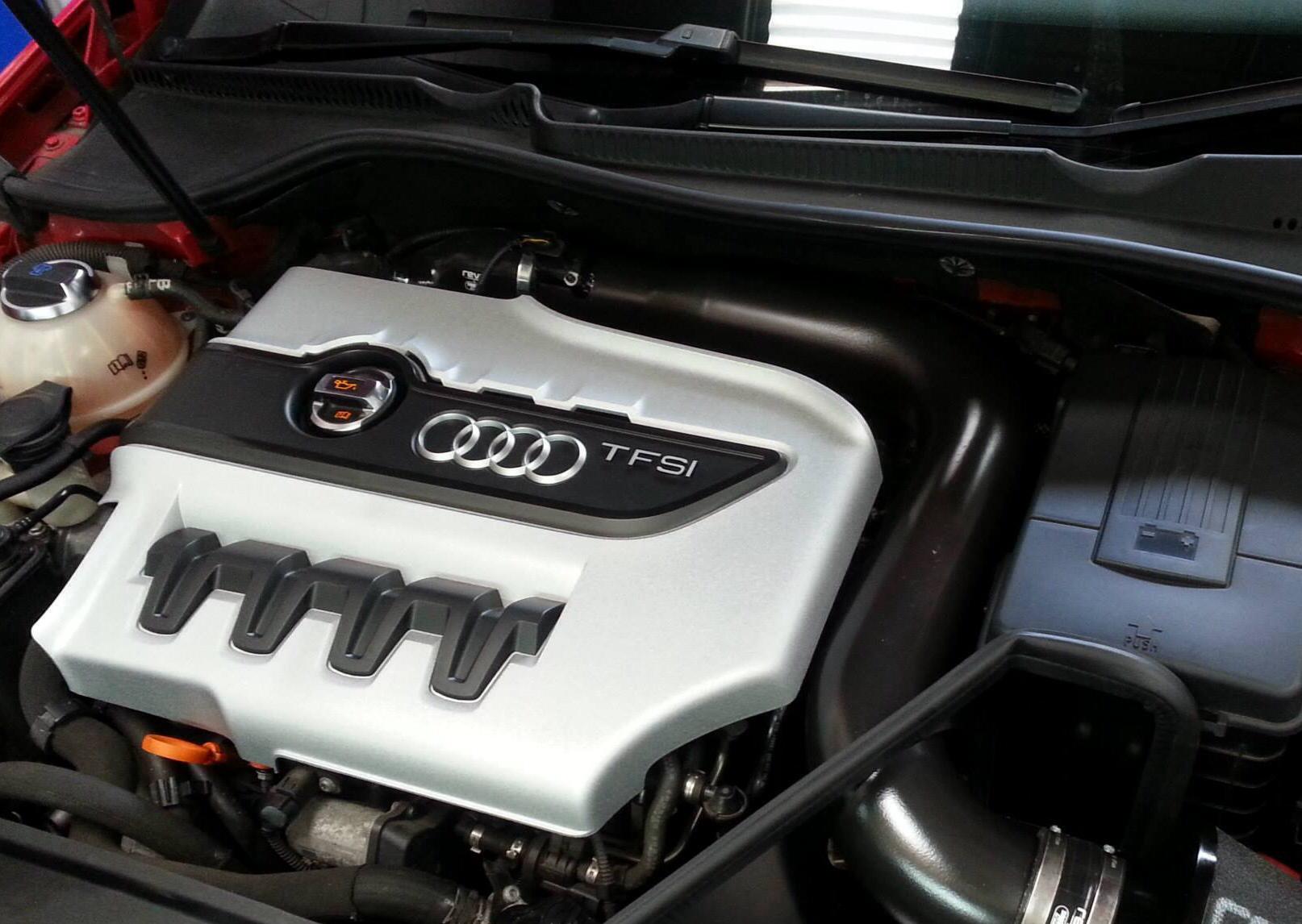

At the same time as having the REVO CAI fitted I also bought (and had fitted) an Audi TTS Engine cover and their associated fitting bolts. IMHO its looks a LOT better than a modified OEM cover and fits the curves of the REVO Intake perfectly.
Part numbers for the Audi TTS Engine Cover and lugs....
Engine Cover.    06F 103 925J
Front Lug.             06E 103 164E
2 x Rear Lugs.       WHT 000 731A
After the TTS Cover was initially fitted..
I wasn't overly keen on its Audi OEM appearance so I gave it a make over. First I removed the Audi rings then filled the gap with several layers of Isopon flexible bumper filler, a lot of sanding then 2 coats of plastic primer, more sanding between the coats, then 2 coats of Matt Black and/or Gloss Black with more sanding in between. Put it all back together, added a VW Motorsport badge and et viola!
One modified cover.....

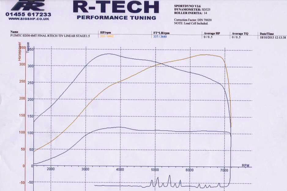

After adding a TBE and CAI a map was needed, where to go?  :confused:
Only really one place as far as I was concerned.........
After reading many reviews/comments and much praise on their maps and after speaking to them and hearing their genuine enthusiasm for their trade my mind was made up. So I made the long trip to see them and was met by the nicest bunch of peeps you could wish to meet. My requirements were not just listened to but more importantly they were adhered to.  As for the R-Tech custom linear map itself, quite simply, its brilliant. I asked for a "usable" linear map without the aggressiveness of other maps and after a few hours doing his thing that's exactly what Niki gave me. The car feels SO much smoother than in its standard form, the power is now delivered smoothly and without drama. Don't get me wrong, it you want it, ITS THERE!! Plant your foot and your held snugly against the Interlagos shod Eddy seats with some force. The car just pulls and pulls and pulls all the way to the red line and licence losing territory is reached before you have time to release the exclamation of excitement that had built up while being propelled down the road at alarming speed.
Totally normal map when pootling around and totally NOT when needed.   :notworthy:
More ponies and torque will be forthcoming but are they really needed? No, not really
Is any more power going to be usable in a FWD with me at the helm? I doubt it
Will I continue?  :evilgrin:

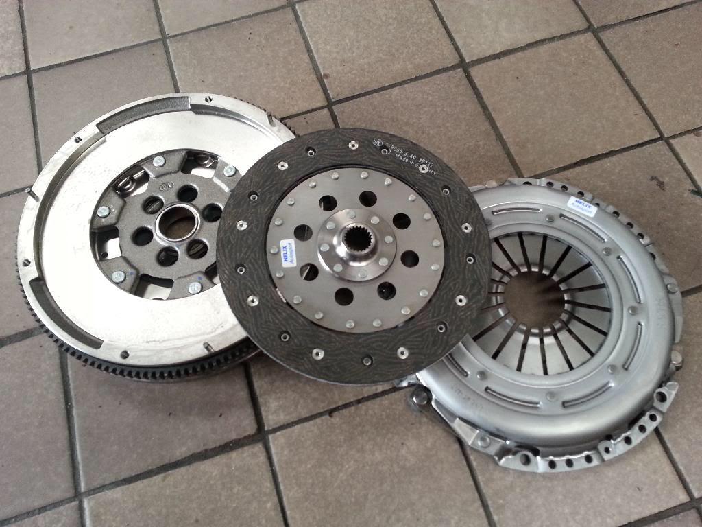

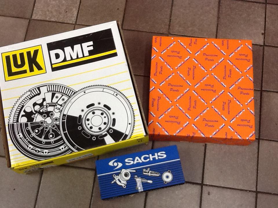

While at R-Tech for their Stage 1.5 map the clutch started to slip STRAIGHT away (no real surprise there) and not too annoyed as I'd planned on an uprated clutch anyway so a trip to see the ever helpful and friendly Alex (vRSAlex) at AKStuning was arranged and a new Organic Helix Clutch later all is good again, the car feels great. I was a tad apprehensive about getting an uprated clutch but the pedal feel of the Helix one combined with a new OEM DMF is great, slightly stiffer (I'd say 50% over OEM) but no doubt even that will settle down a wee bit after some time/miles.
Organic Helix Clutch and OEM DMF....

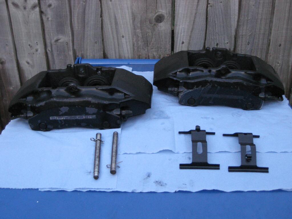

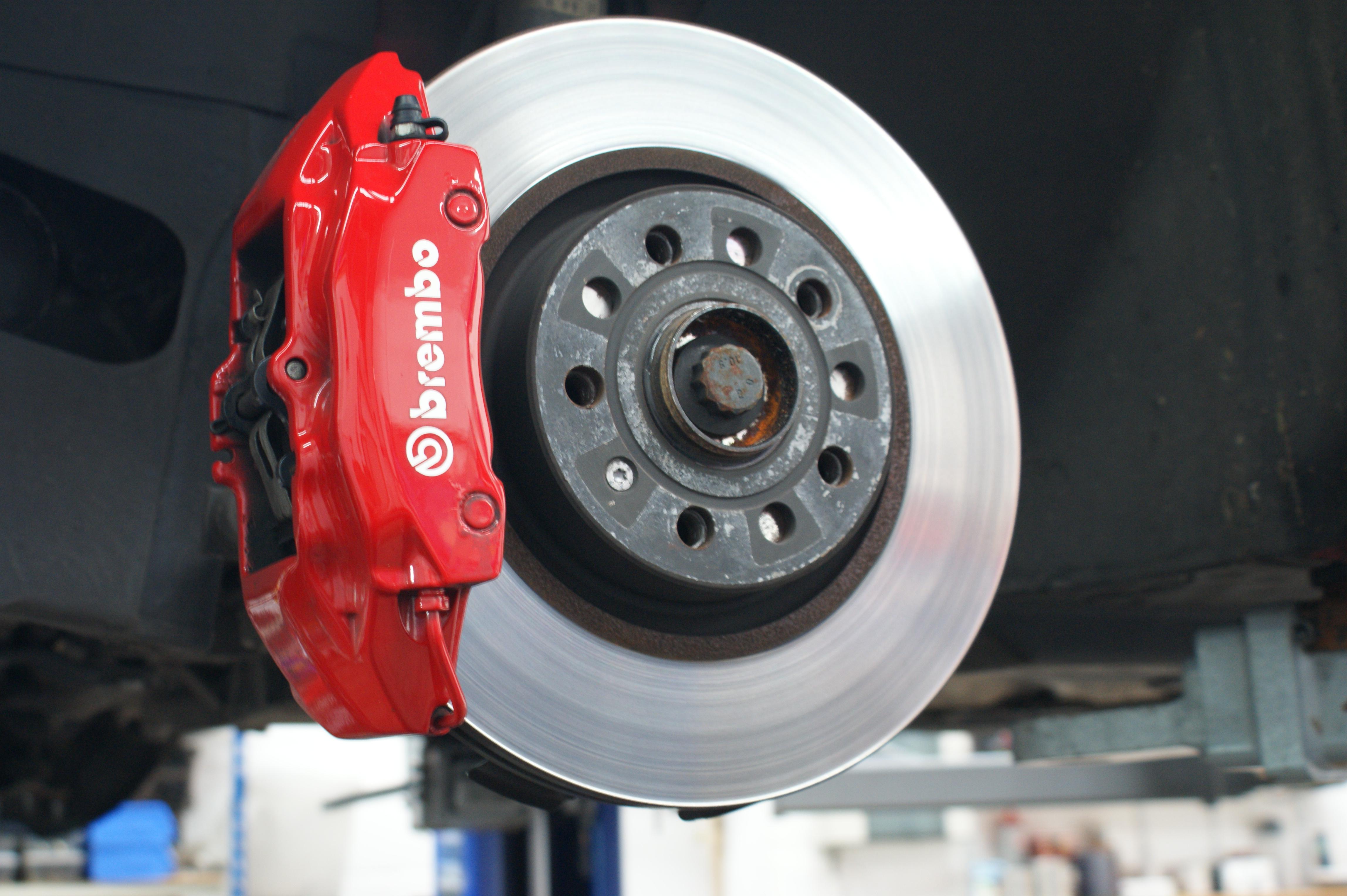

IMO with more power better anchors are needed so after looking at the options available (in my "right arse" price range) I bought some 4 Pot Brembo Porsche 986 Cayman/Boxster Calipers (otherwise known as the NQSBBK on here) from a member on the forum. They needed some serious TLC so I sent them off to Jonny at brakecaliperrefurb.co.uk for him to do his thing and WOW did he do he thing or what! The Calipers were returned to me in their new, gorgeous Pillar box colour, ceramic coated (at the time a service he offered to forum members for free) and also with new pad retaining clips and bolts!  :notworthy:
When I bought the Calipers...
After they had returned from Jonny, ceramic coated.....
A link to brakecaliperrefurb.co.uk.....
~~ Clicky here ~~

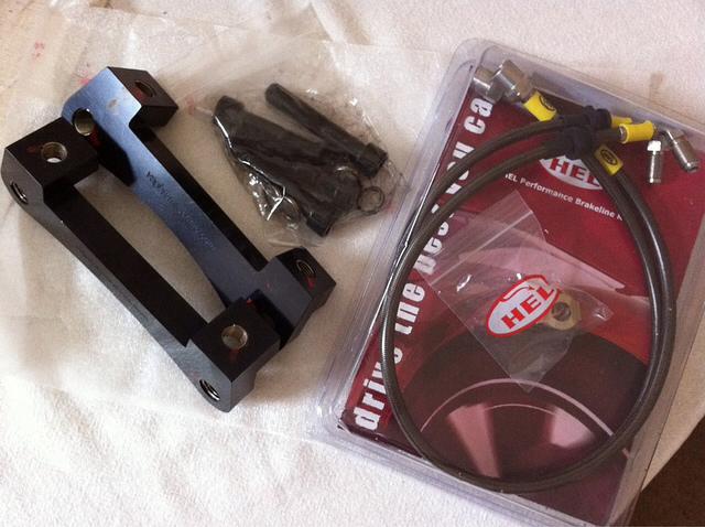

I ordered the fitting kit from DaveB, bought Brembo discs and pads, Porsche shims and had the lot fitted. The BBK inspire so much more confidence than the OEM setup. With the addition of some superior pads than the ones I have fitted at the moment they will be even better and more than I will ever need.
The original thread (below) on the NQSBBK by the Brake guru Daveb1970.....
~~ Clicky here ~~
And the fitting kit supplied by DaveB......

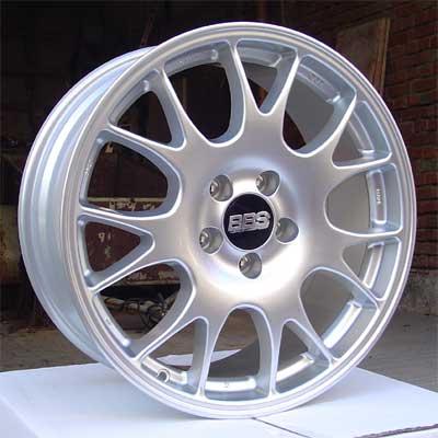

I also decided (at the same time as the BBK) to get some wheels that didn't need spacers to fit a BBK and went for the Edition30 Pescara OEM look of the BBS VZ's in Hyper Silver. I got the wheels from Graeme (GNJ_Motorsport on here) at GJN Motorsport through this site. Awesome service and a great price.
GNJ Motorsport's site......
~~ Clicky here ~~

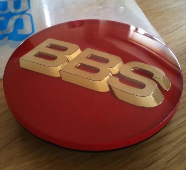

Also added some ridiculously priced BBS Red/Gold centre caps that I managed to source from America after trawling the entire interweb world for them! The wheels look the business and with their 18"x8" ET44 size there's loads of room a BBK....
Bloody expensive and rare BBS caps.......
And all on the car.....

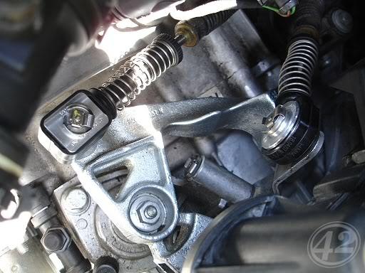

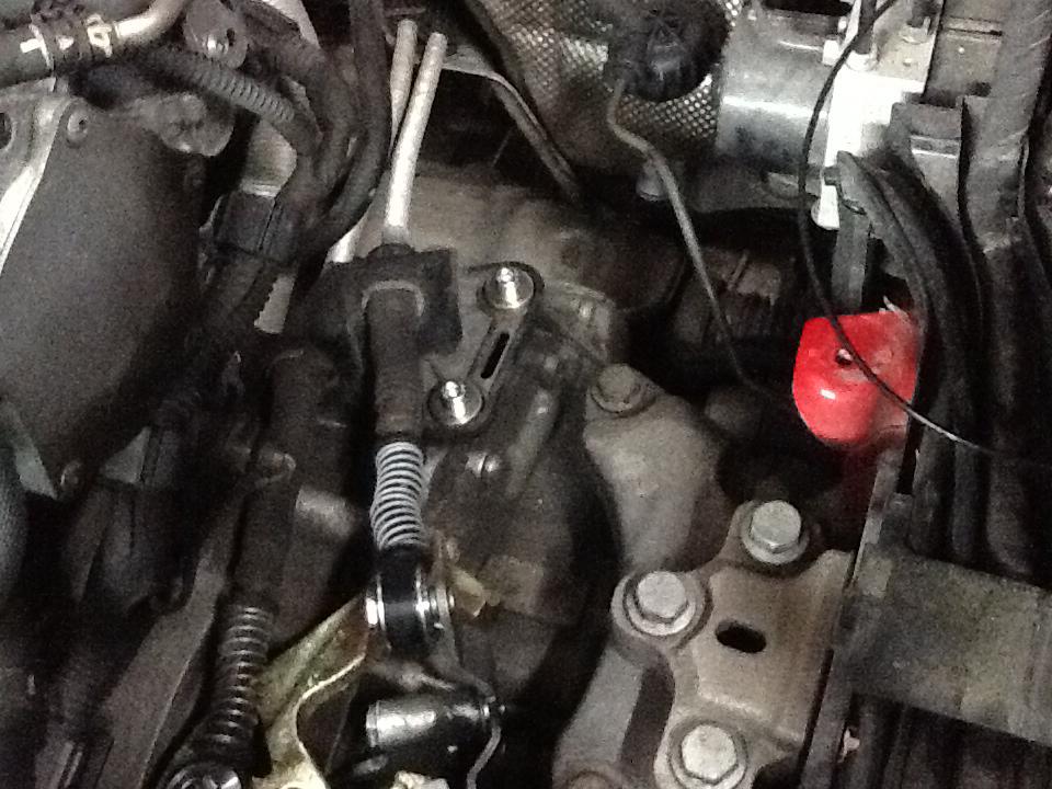

A few (relatively) mini mods that I've had fitted and should be standard IMHO are (1) the shortshifter with the uprated bushes/bracket (for those with manuals obviously) and (2) a Boost Gauge and lastly (3) Door Warning Lights (standard or LED).
(1) The shifter has a really solid, direct feel and the short throw is a huge benefit when driving in a "spirited" manner..........apparently.  :evilgrin:
The addition of the AKS bushes/bracket ties the whole thing nicely and adds the icing to an already great mod, inspiring confidence that you won't miss a gear while quick shifting.
Pic below from 42 Draft Designs site showing their excellent bushes...
And a dodgy iPhone pic of them fitted alongside the Shortshifter and the AKS Bracket and bushes....

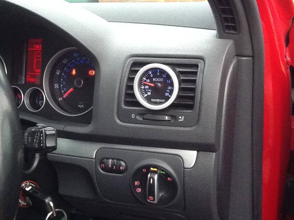

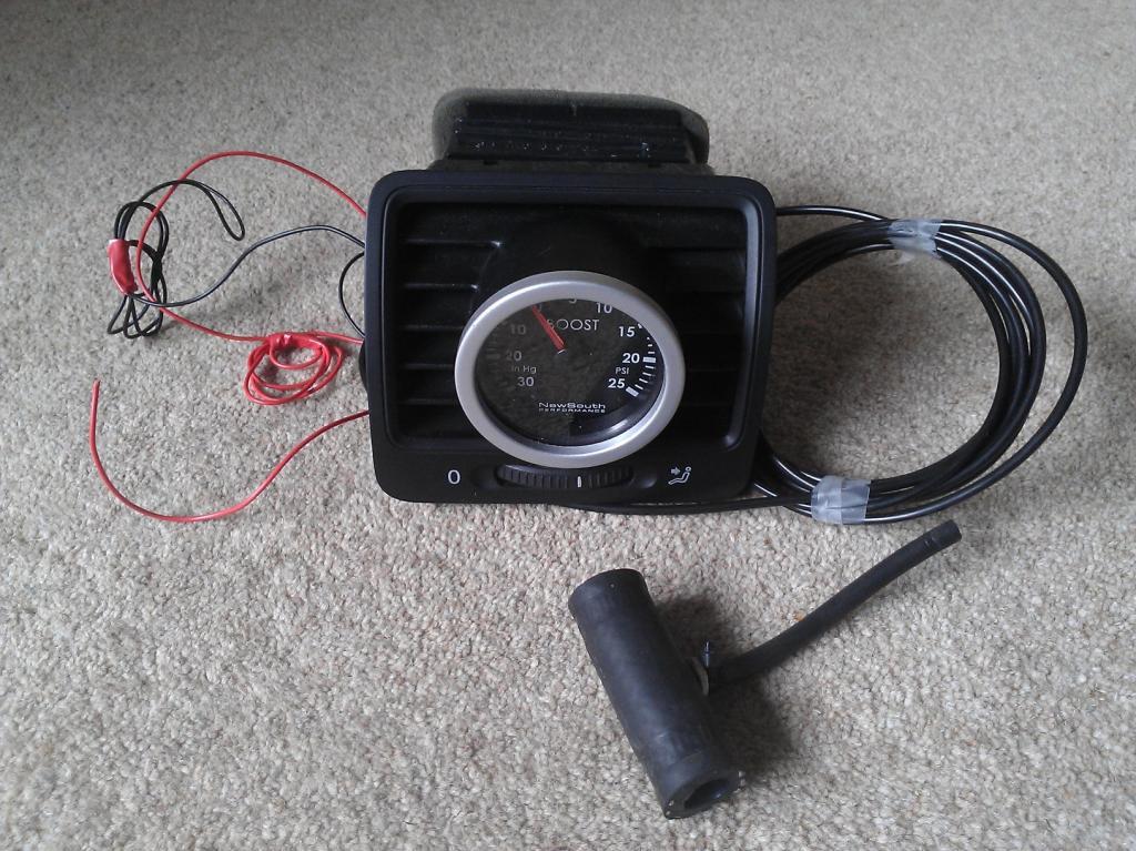

(2) As has been mentioned many times the boost gauge, apart from looking good, is a great visual diagnostic tool giving you an instant view of anything problems associated with BOOOOOST, ie a torn Diverter Valve Diaphragm or a leaking  hose. The Newsouth Performance Indigo Gauge is more OEM in appearance than the DEFI one in both its dial layout and illumination (which can be dimmed along side the main dials).
Link to the Newsouth Performance website below.....
~~ Clicky here ~~
Boost gauge......
Fitted.....

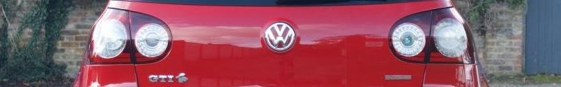

^^^^ as in the pic above, I had the inner section of the VALEO LED rear lights coded out (or the light output reduced to 0% IIRC) to give the ring appearance and the "bulb out" warning light coded out too as the VALEO units draw a lot less power than the OEM clusters and can throw that up. Thanks to SI-R32, proper nice fella with a stunning R32 to boot.
A pic below of the VALEO LED rear lights fitted to the car and a link to a review of them by RedRobin. These are great lights peeps which give a vastly improved light output over the standard UK OEM clusters with the bonus of an indicator function that can actually be seen by the following traffic.
~~ Clicky here ~~

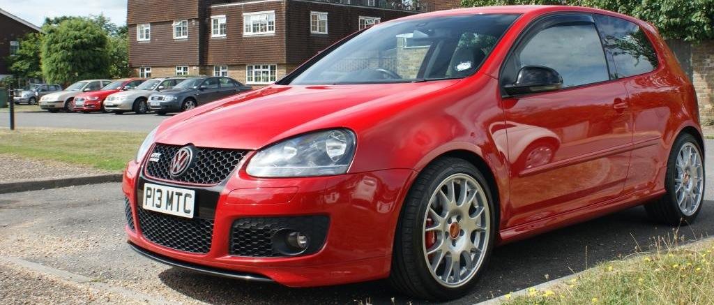

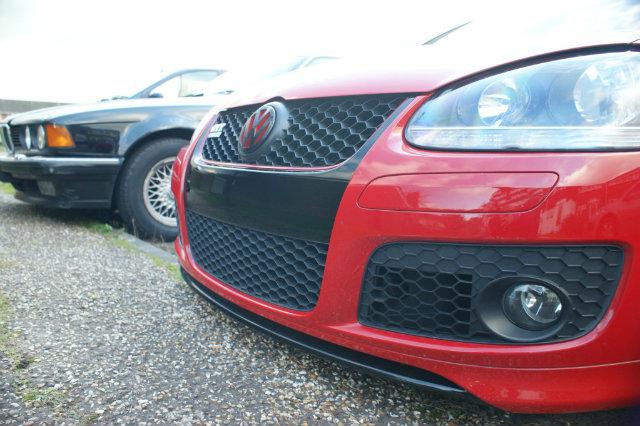

I personally think the Red/Black colour combo works well together so after I added some Gloss Black Mirror Casings, In-Pro side repeater and along with having the Rear valance and front splitter vinyl wrapped in Gloss Black I was happy...
An American OEM Smoothed front grill was added. I use both a magnet number plate and a suction cup number plate. One on the car, one in the boot, just in case the other falls off or gets left anywhere!

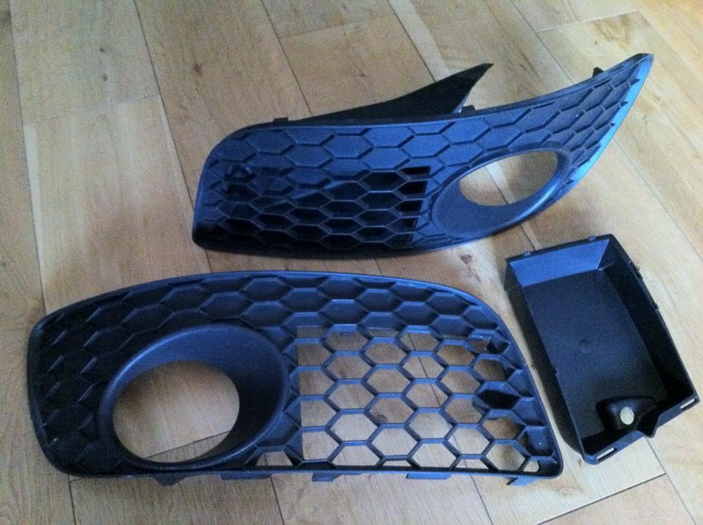

Some early OEM Mk5 fog grills with rear covers were added....
.....as was a Mk6 Boot Handle (colour coded backing in Tornado Red).....
