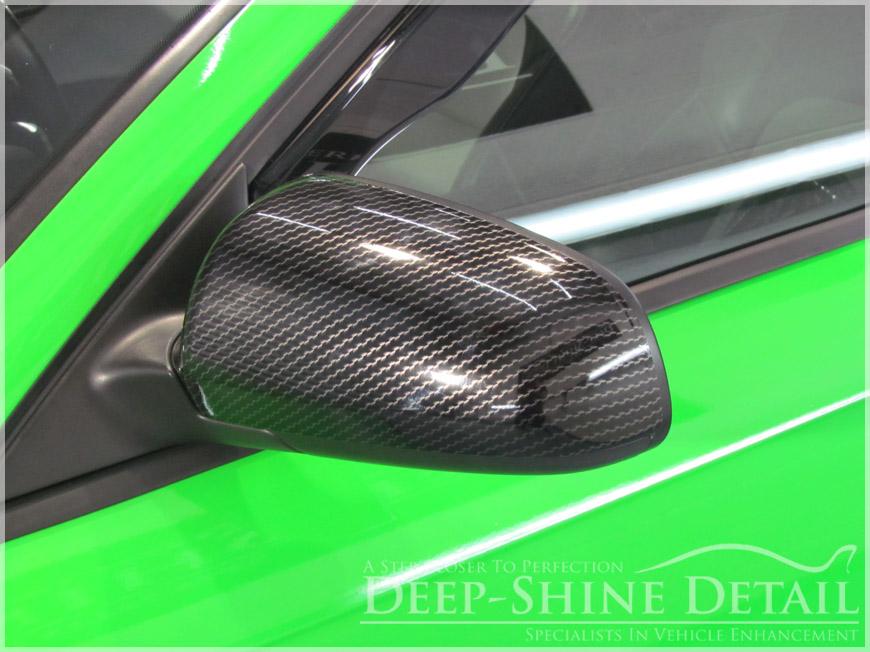

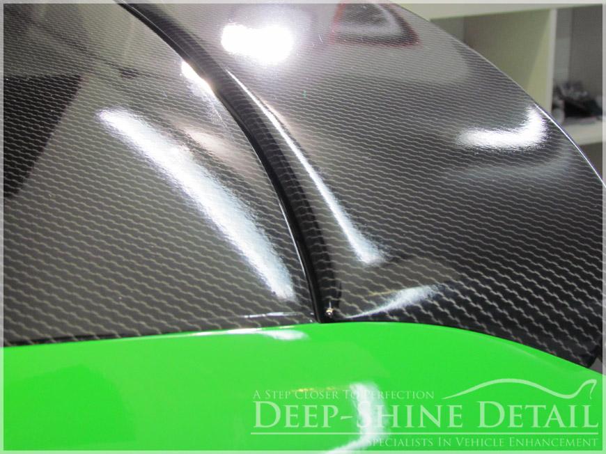

We used a brand new Hybrid Multi-layer Gloss Carbon on Roof/Mirrors/Rear Diffuser.

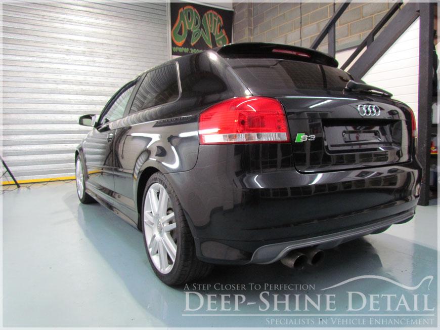

Audi S3 Receives a full colour change wrap @ Deep-shine Detail from black to Apple Green.

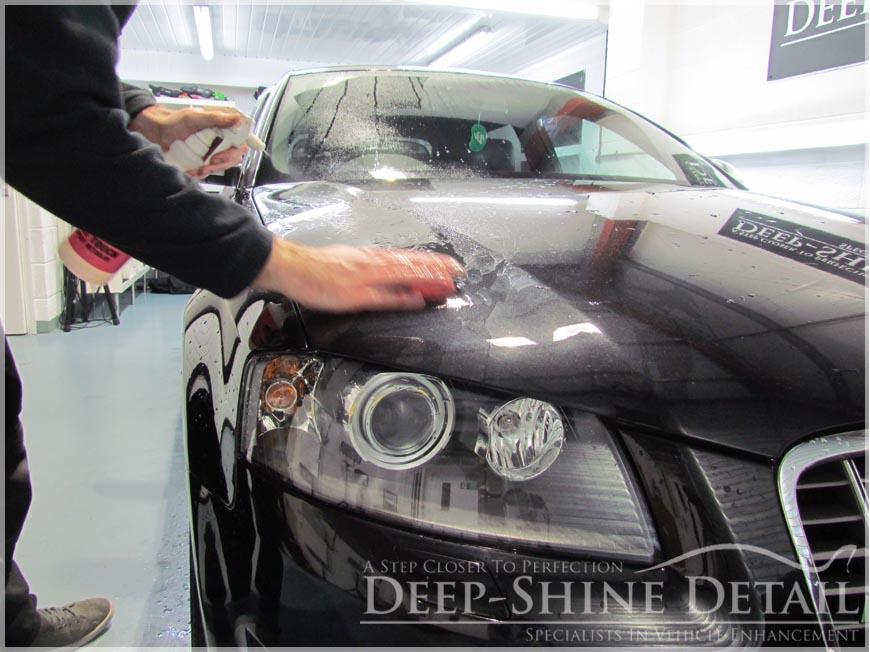

The S3 and under went the usual full safe wash and contamination process then was moved inside and fully clayed to remove bonded more stubborn contaminates.

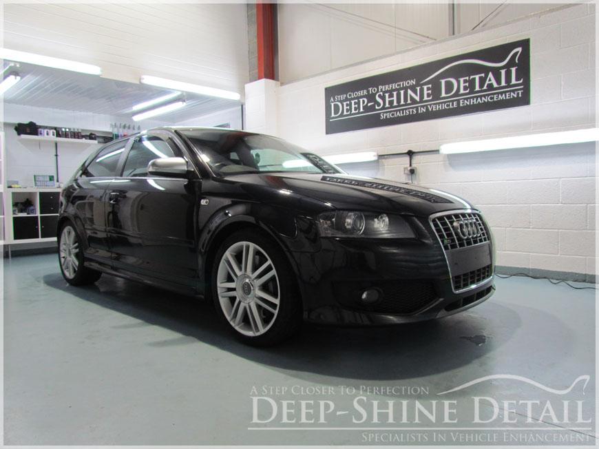

This is how the S3 stood ready to begin

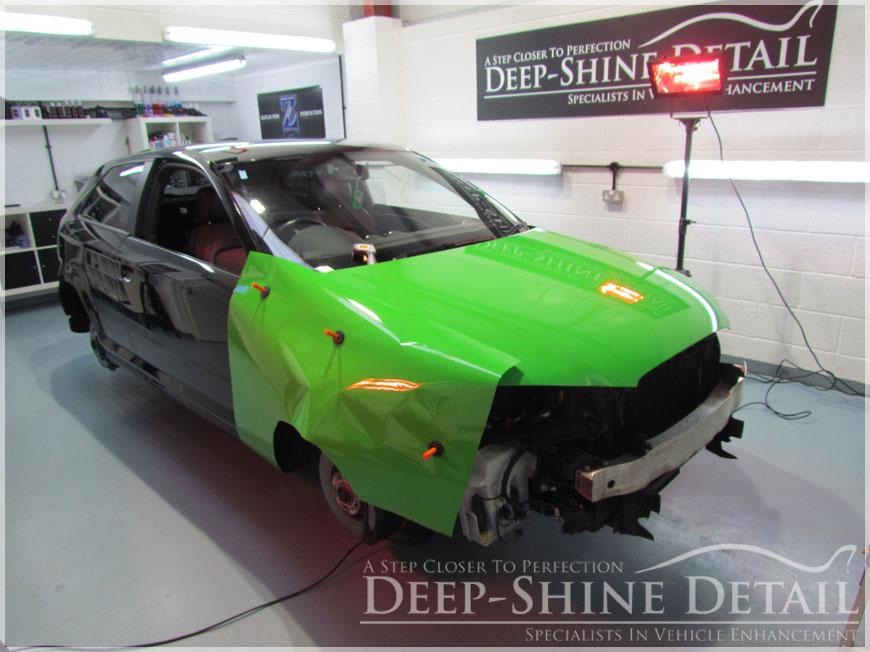

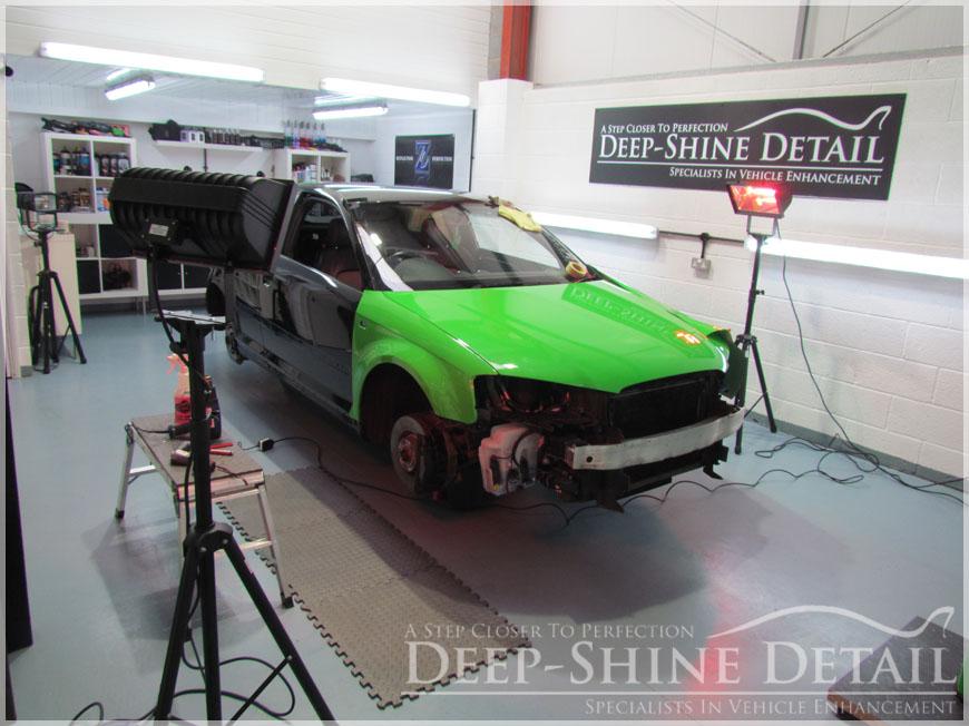

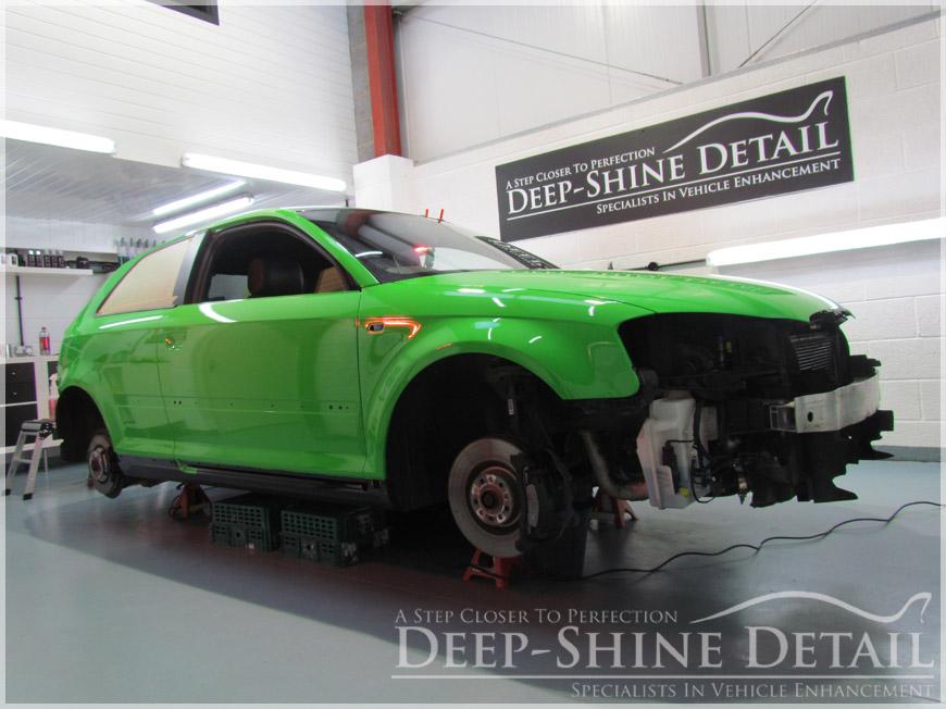

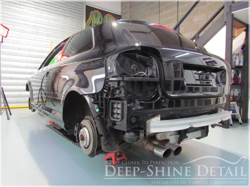

The car was then prepared properly fully removing and striping all trim, bumpers, mirrors, spoiler and lights etc to ensure the best application of the wrap as possible.
And it begins black to Apple Green
We have all seen the horror stories and images from knife marks in paint once a badly applied wrap has been removed and there is honestly no excuse for this , spending a bit of time removing trim and using cut tape eliminates cutting in on the car.
Cut tape in action

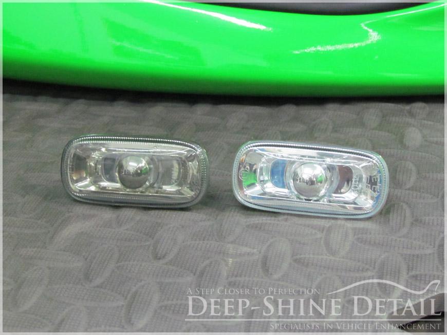

Lights and side repeaters were treated to a subtle light smoke film

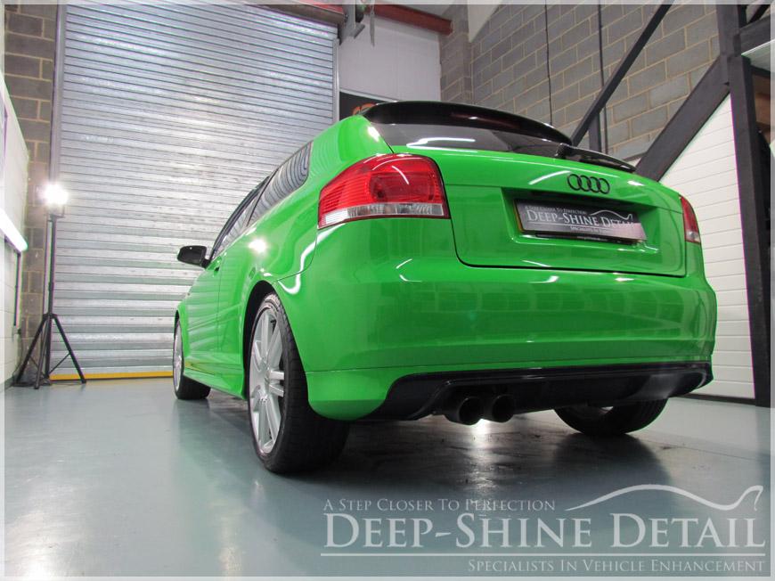

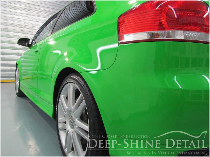

Completion Images
