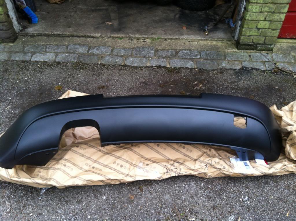

Also looking at some GTI rear bumper the lower bumper seems to have an indent part that runs just over the exhausts so I presume this is the standard one and it is actually different to my current one I posted a pic of above

Nope, all the top part of the bumpers are the same. Edition 30, gti and r32 bolt to them.
Answer to your exhaust is it should fit. A friend of mine has the same and he hasn't had an issue with the exhaust.
Yes, the gti has a groove as shown below
People tend to colour code the bumper and leave the centre bit black which looks great.
