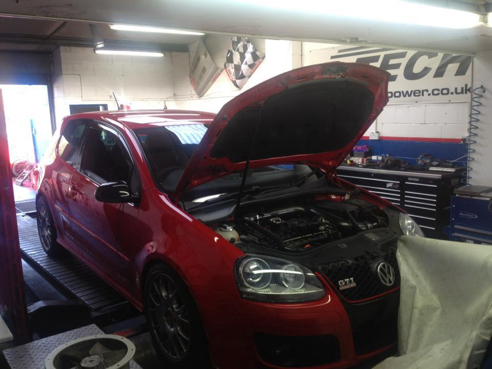

I already had a R-Tech Stage 1.5 Custom Linear map and after adding a few bits and bobs I was ready for a wee bit more so it was time for another trip to see Niki, Ben and Marcus at R-Tech for a custom Stage 2+ map.
I asked Niki for a SUPER smooth, completely linear map, regardless of bhp of torque as I'm way past waving my willy about such things. Oh and I also asked if we could keep the torque within the limits of my new (only 2 month old) uprated Helix clutch. I also asked for his LBK/VVT map thingamajig too which IIRC he now maps into K04 Turbo'd cars that have a CAI on.

So, while myself and Ben put the world to rights Niki did his thing. Hours later he appeared from the car beaming. The man's a bigger kid than me and obviously loves what he does!  :notworthy:
Anywho, apparently the figures were higher but to keep to my requests it was bought back a wee bit. Niki mentioned that the torque was well into the 400's at one point!!  :laugh: I may yet get a bigger clutch (BIGGER I should say) but not just yet.

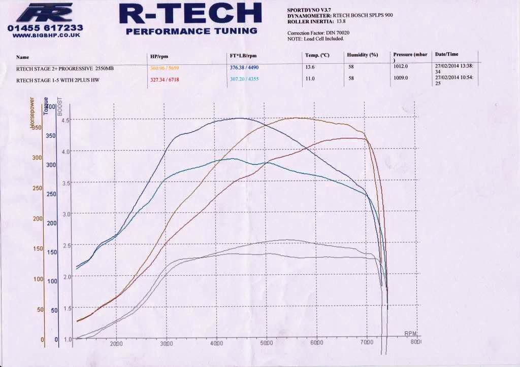

This is were we ended up......
361 bhp 376 ft lb
To say I was cuffed to nuts is an understatement of gigantic proportions, I drove home like a giggling schoolgirl, I couldn't help myself from creaming anyone who thought they'd have a go a getting past me (all the way up to 70mph as that the legal limit). The Mistress is so smooth and the power is so usable, the midrange is phenomenal, truly awesome. With the handling mods that have already been added she's so planted and really belies her FWD short comings.
As for the magic that Niki has found with the LBK map, simply awesome. There is the faintest hint of flutter but you REALLY have to try and find it. This alone is worth the map IMHO and adds so much more to the cars performance. The car pulls like a locomotive on steroids, no hint of aggression or the "bit bull" characteristics of those maps of yesteryear.

Awesome, that graph looks immense.
