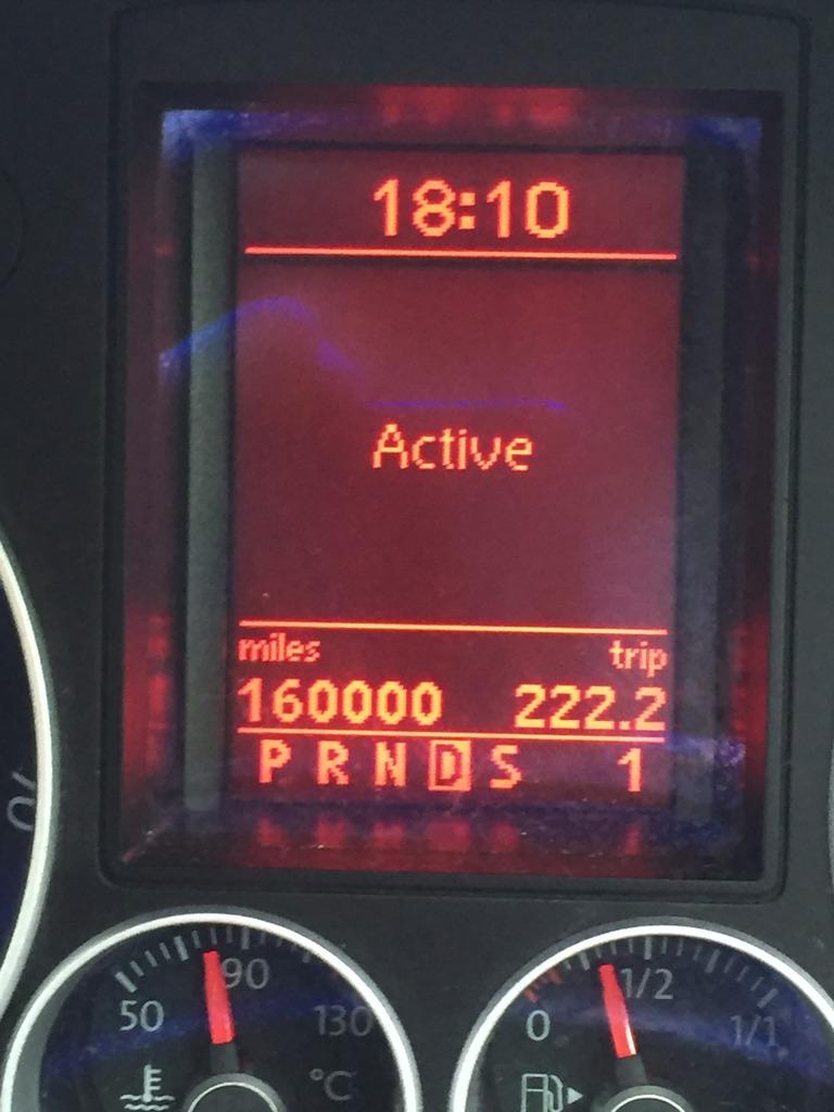

Hit a milestone yesterday, 160,000 miles.

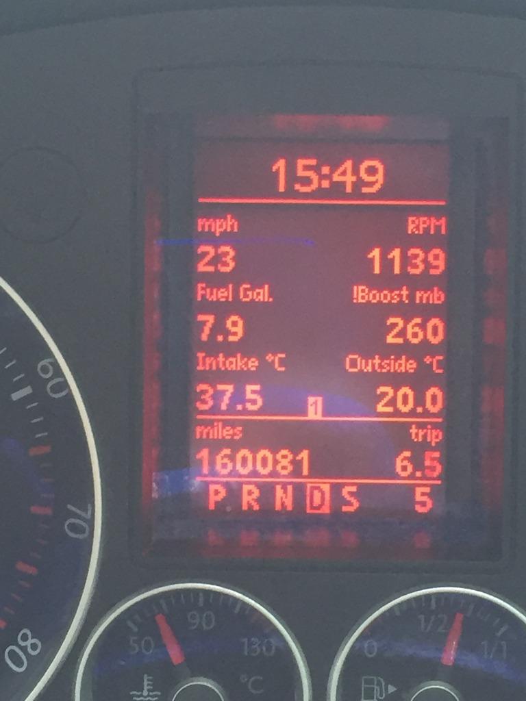

Also managed to fit my Polar FIS this morning. Love all the information that it gives me.

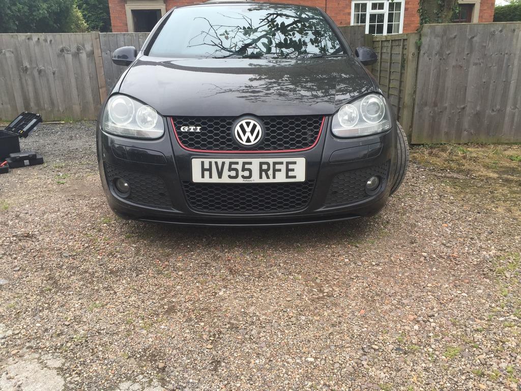

Whilst l was at it I also put my colour coded Ed30 splitter on.
Ive got side skirts to go on next along with a Powerflex Anti Lift kit and new subframe bolts, hopefully tighten up the front end a bit.
