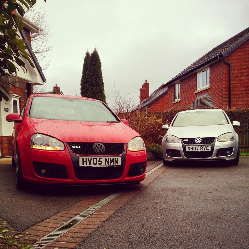

I've been very slack on updating this! Mainly because I've not really done very much to it, after spending a few thousand on the MK4 I'm enjoying having a bit of cash to spend on things other than a car!
Anyway, fitted a cherry hazard switch and GTI handle inserts:
Lowered it on a set of H&R 30mm springs:
Which came off my brother's ED30:
Both of us went to our parent's for Christmas and I couldn't resist a pic:
Also fitted some wind deflectors which you can just about see here:
